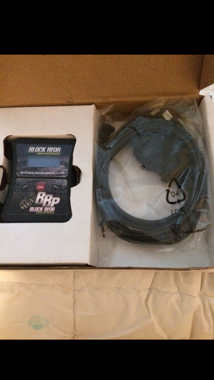

Someone is selling this autocal....i know nothing about it. It says it's for a 2004 silverado. A black bear put a tune on it for a 2011 tahoe?

The tune on it will be no good to you.
You will pay to put your vin on it. Scan and they tailor it to you

If you are happy with the price, grab it. Contact BB, purchase the license and then time to follow along with their instructions noted below.
Here are the instructions regarding the AutoCal and the tune files once you email BB with what you want. You will clear the old data, do a run log to collect your truck's data, email that file away, they will build the tune, email it back to you to load and away you will go.
http://www.blackbearperformance.com/autocal_management.asp
Any specific questions, email BB. I have 2 trucks tuned and they worked with me in person and via email with the AutoCal answering all of my questions.

Someone is selling this autocal....i know nothing about it. It says it's for a 2004 silverado. A black bear put a tune on it for a 2011 tahoe?View attachment 208543
As mentioned above you will have to purchase a tune and license, if your vehicle is 1998-2016, tune and license would be $325. The AutoCal will allow us to see your vehicle data and provide you with custom tune files via email. Call us 877-809-4070, or email [email protected] with any questions.
