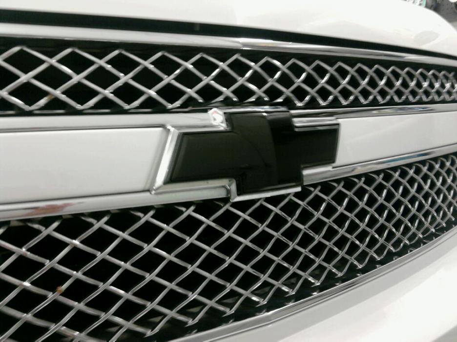

I pulled my front one apart and sanded out the gold and then sprayed the back with gloss black. Used RTV to glue it back together. looks factory now. Don't have to worry about the paint chipping since it's not exposed.
