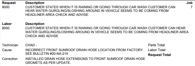

I had it and they completed the repair with an actual solution (no longer having us turn on HVAC). Just completed drive to Florida and no more gurgling. See below:
