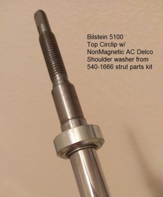

On the Front struts: When you put your lower spring seat on the new Bilstein did you use the 'lower spring mount adapter' that comes with the Bilstein or did you put the lower spring seat directly on the adjustable circlip?
Also, did you use the shoulder washer from your old AC Delco shock on the top shaft circlip of the Bilstein?
