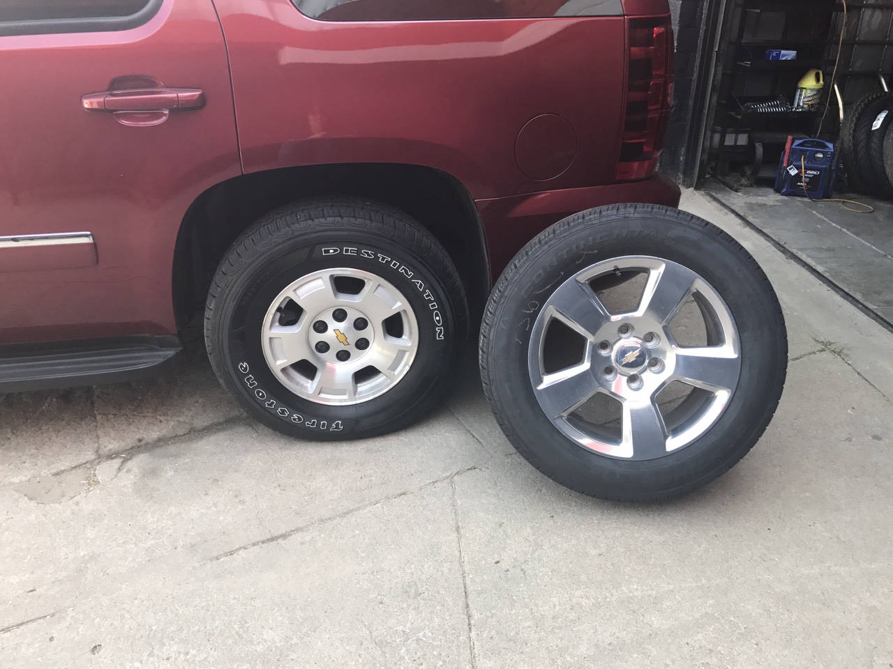

17" and 18" have a better ride. I just put 20"'s on my 2010 and the speedometer seems accurate fad34a02196bcc52f9582992c2968218.jpg
