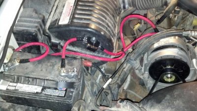

Found a pic on my laptop, heres mine with 4 gauge and regular terminal ends from napa.
Wrapped em tight with electrical tape
