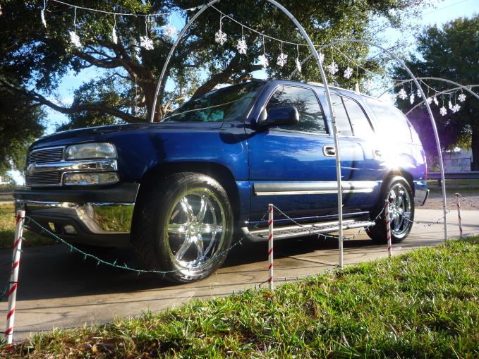

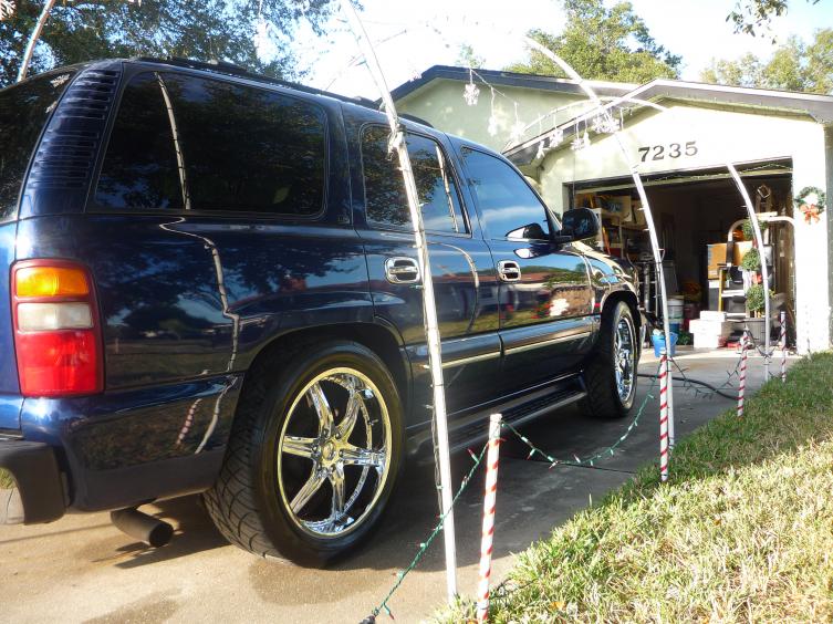

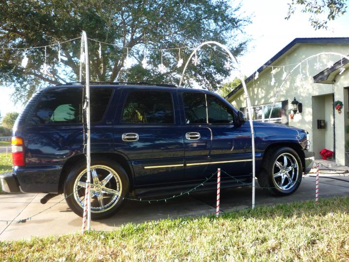

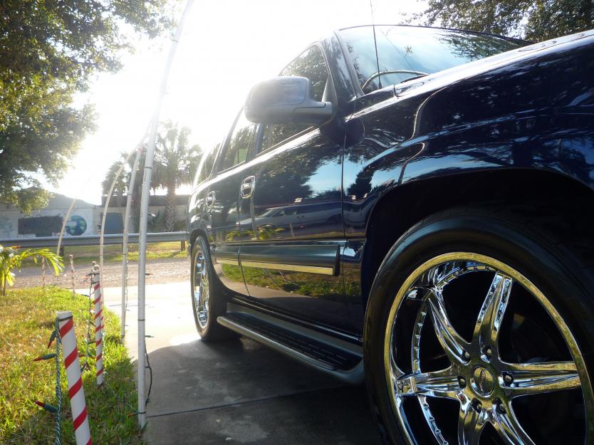

They are 22". They are made by Venti model V73. I just installed the drop kit 2" spindles, 4" belltech coils with belltech bumpstops, and shock relocators. Bilstien shocks front and rear are next.
2" mcgaughys spindles, 4" belltech pro coils, belltech bump stops, shock relocators. Bilstein shocks front and rear are one the way along with new front bumpstops.
Looks damn good Those belltech coils are more like a 5" drop once they settle, same ones I have and my truck sat 1/2" lower than another buddy's truck with 5" djms. Ride nice too.
I hope once i get the new shocks in it will actually raise the back up a wee bit, its sits a bit lower in the back, and i am happy with the front so we'll see. anybody who lowered their truck and put new shocks, did it raise the truck at all?
