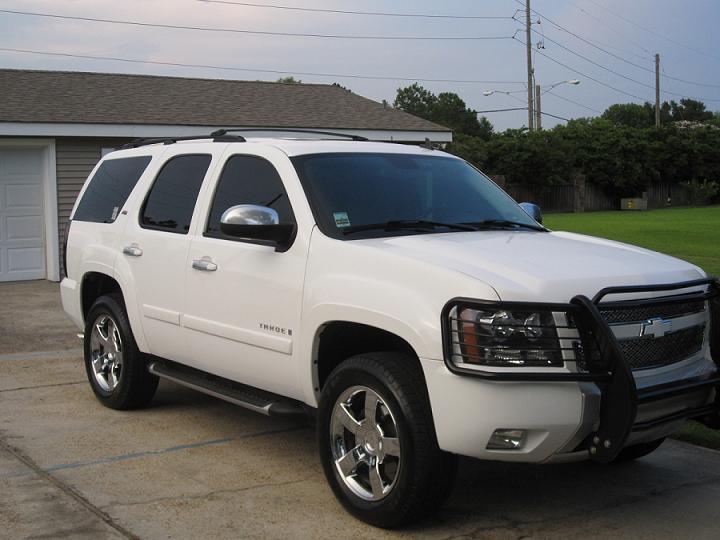

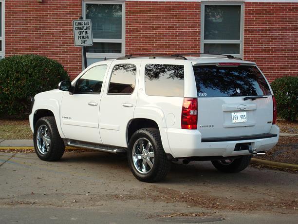

The first picture is Nitto TG 275/60R20 and the second one is Michelin M/S 275/60R20 both with just the front leveled.

geoffreyis
Jun 20, 2011
24
David, where did you get that work done for your Tahoe in new orleans?
---------- Post added at 07:07 PM ---------- Previous post was at 07:06 PM ----------
David, as well is the front end of your truck the only part that is lifted and by how much?

I'm in New Orleans and I did it all myself, It was really easy to do with someone there to help. I know a guy that does good work by the airport and another good guy on the northshore if you really want to pay someone to do it. I would be willing to help out if you decide to do it yourself.
Jun 18, 2010
74
New Orleans, LA
When I first had my ready lift on I installed it myself but when I bought the CCM kit Delta World Tire in kenner installed it for me for like 100 dollars because I bought my tires there and I didnt really have the time to do install it.
