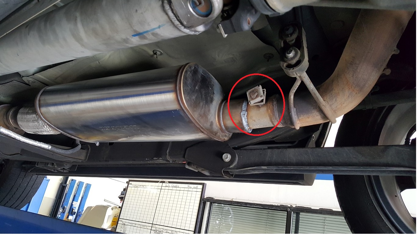

Here's your flapper. They just cut and weld a new piece in.

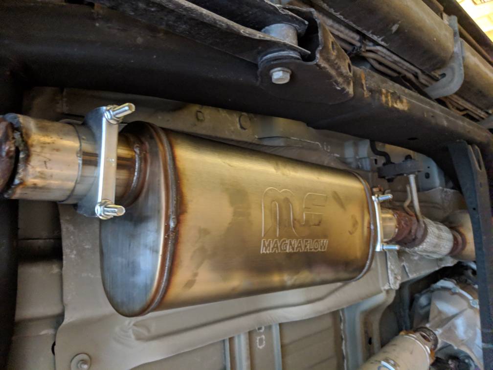

I also installed a magnaflow 12259 muffler based on your recommendation. Left flapper and resonator on. Love the new sound. Not obnoxious still works for the family car.

I also installed a magnaflow 12259 muffler based on your recommendation. Left flapper and resonator on. Love the new sound. Not obnoxious still works for the family car.View attachment 216607
