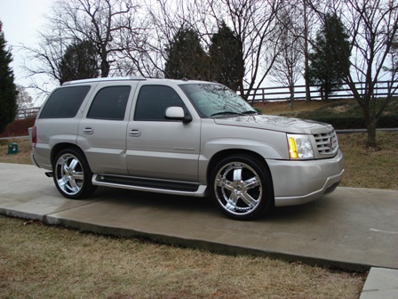

I had an 04 Escalade with a ground force 2\3 kit. I didn't even use the keys. I just cranked down the factory ones and got it aligned. Maybe you can just buy a set of coils and the adjustment links. They above options sound good, but this maybe cheaper.
attachment.php
