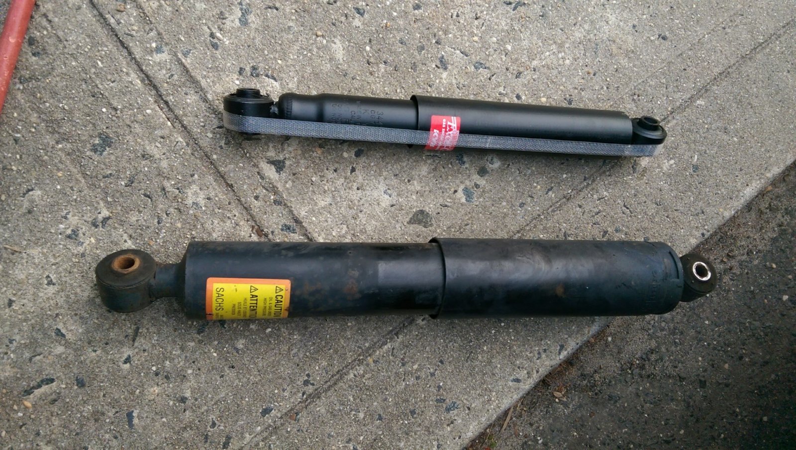

In case anyone ever stumbles across this in the future, I took off my nivomat shocks and extenders, and put my belltech shocks back on and low and behold (no pun intended lol) it dropped an inch! Well an inch on the passenger and 3/4 on the driver but I'm happy! To recap, I have 2 inch drop springs in the rear with the belltech shocks. Still have decent travel using the belltech bump stops so I have more faith in my towing ability! Thanks everyone for the input.

Those Nivomats are pretty stiff.
