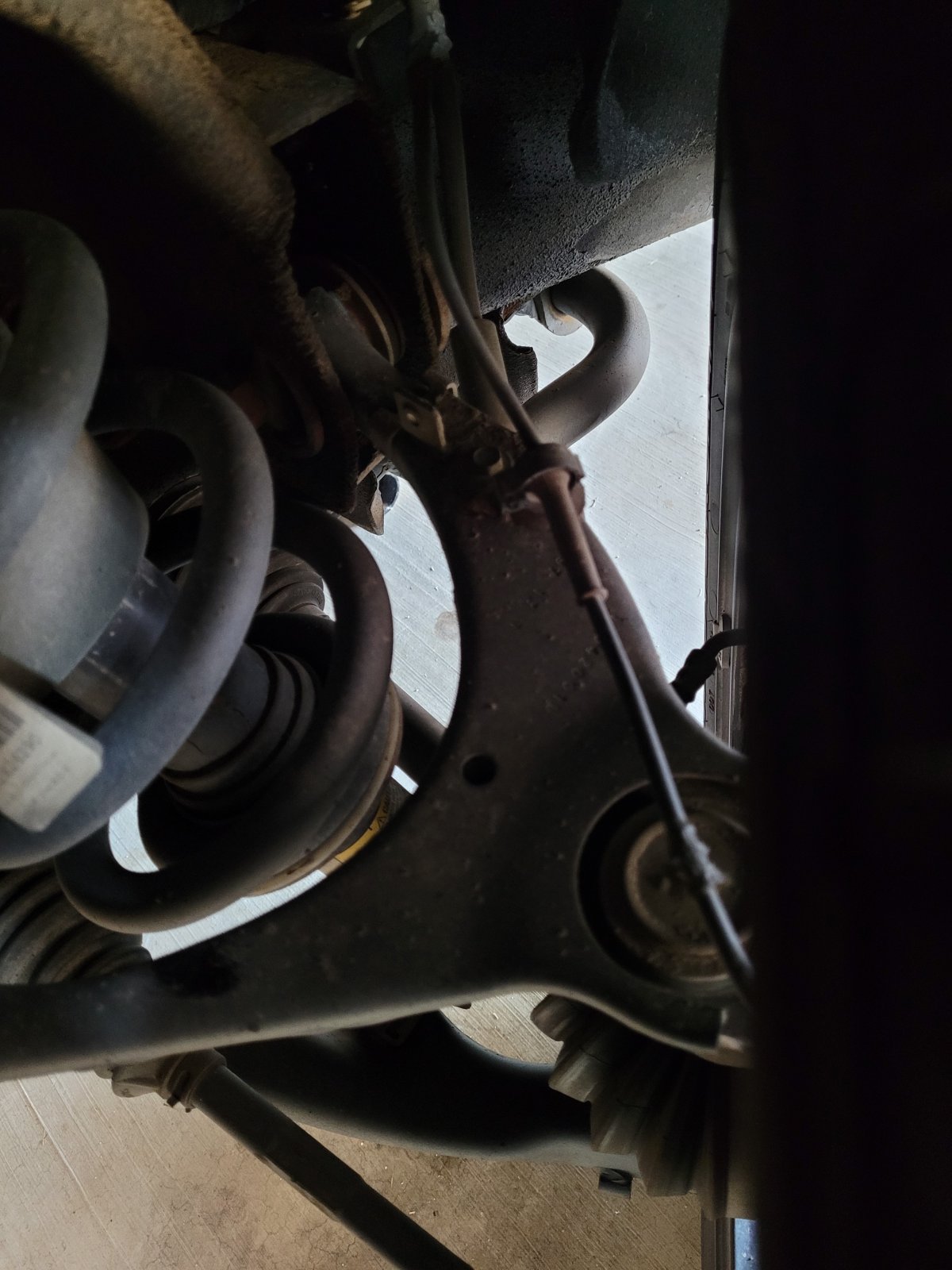

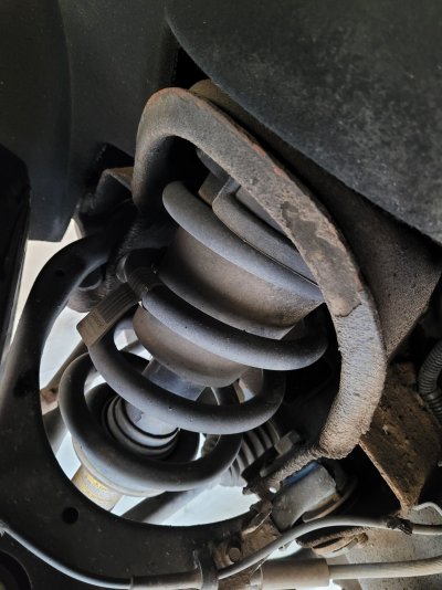

the spacer will be MORE SO need with the smaller diameter wheel, depending on BS, they barrel will touch the front of the upper arm.
these are far from ideal pics, but what you see is the front wheels edge at the lower portion of the pic, looking down at the arm. you can see how close a 22" wheel comes at 2.5" lift. this was a trial before purchase. most if not all aftermarket arms, are larger diameter tube and most are further forward than the stock arm. the 22" probably clears for this reason, where as a 17-18 may make contact at full lock.

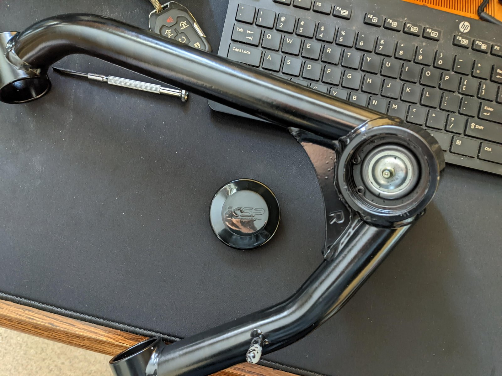

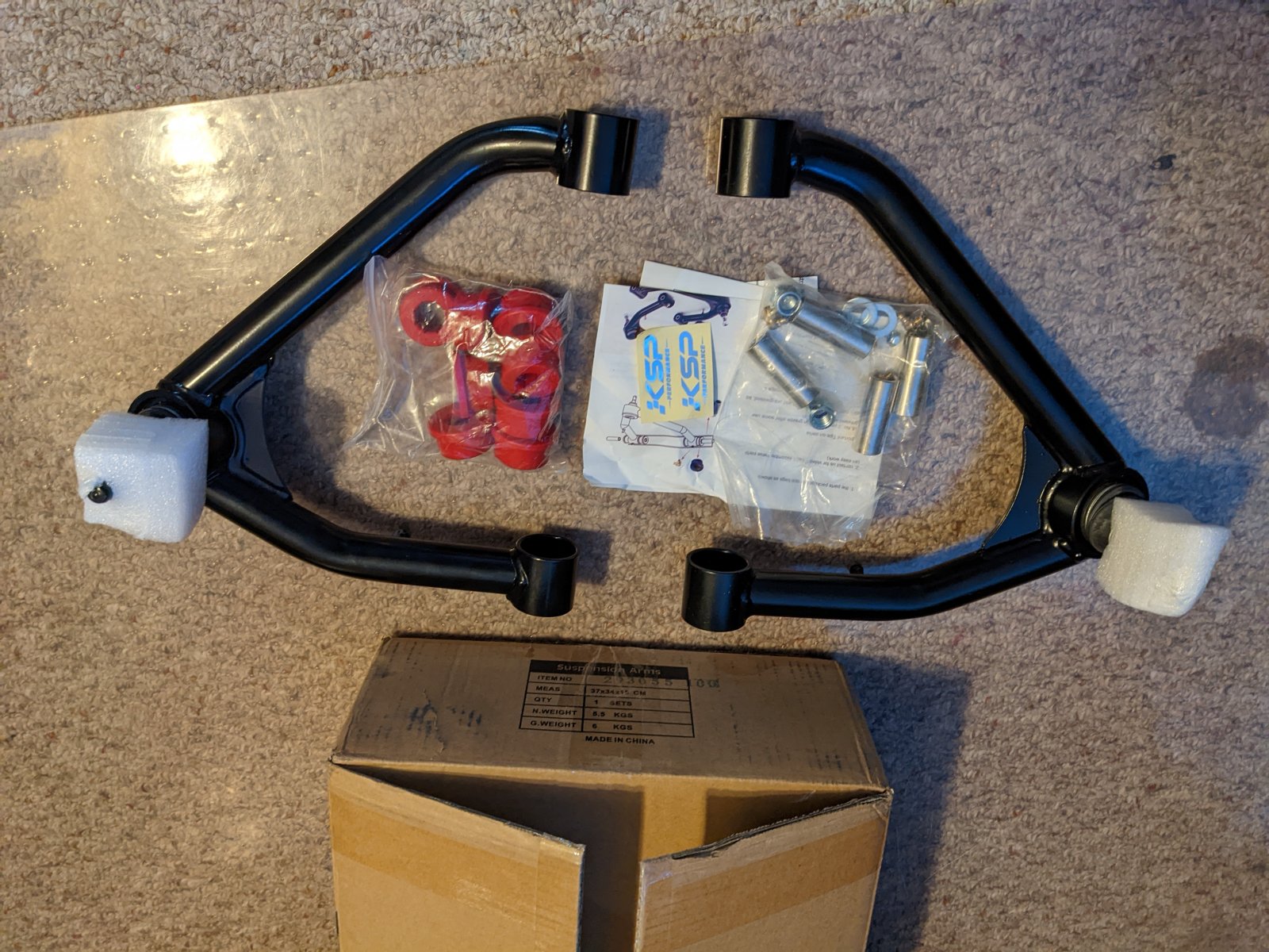

Those look similar to the KSP arms that delivered yesterday. Unfortunately the ball joint in the left arm feels overly stiff and grinding vs the right which is stiff but smooth. I can't install this garbage.

Unfortunately the ball-joints on these are non-greaseable. I'd pull the boot to confirm they forgot to add grease but the rubber quality of these boots is garbage too. The rubber has a white coating like a rubber band aged in the sun and you can tell it's going to split in no time. Didn't bother trying to lift the upper boot ring as it's thinner than paper-clip gauge wire and will almost certainly damage the boot. Tried working the joint around a bit and by sound and feel - I'd be very surprised to find any grease. The other is certainly smooth as butter though, just glad I didn't decide to install them anyway. The ebay seller responded in broken English disregarding any comments as he may not have understood anything I wrote. Sending them back.

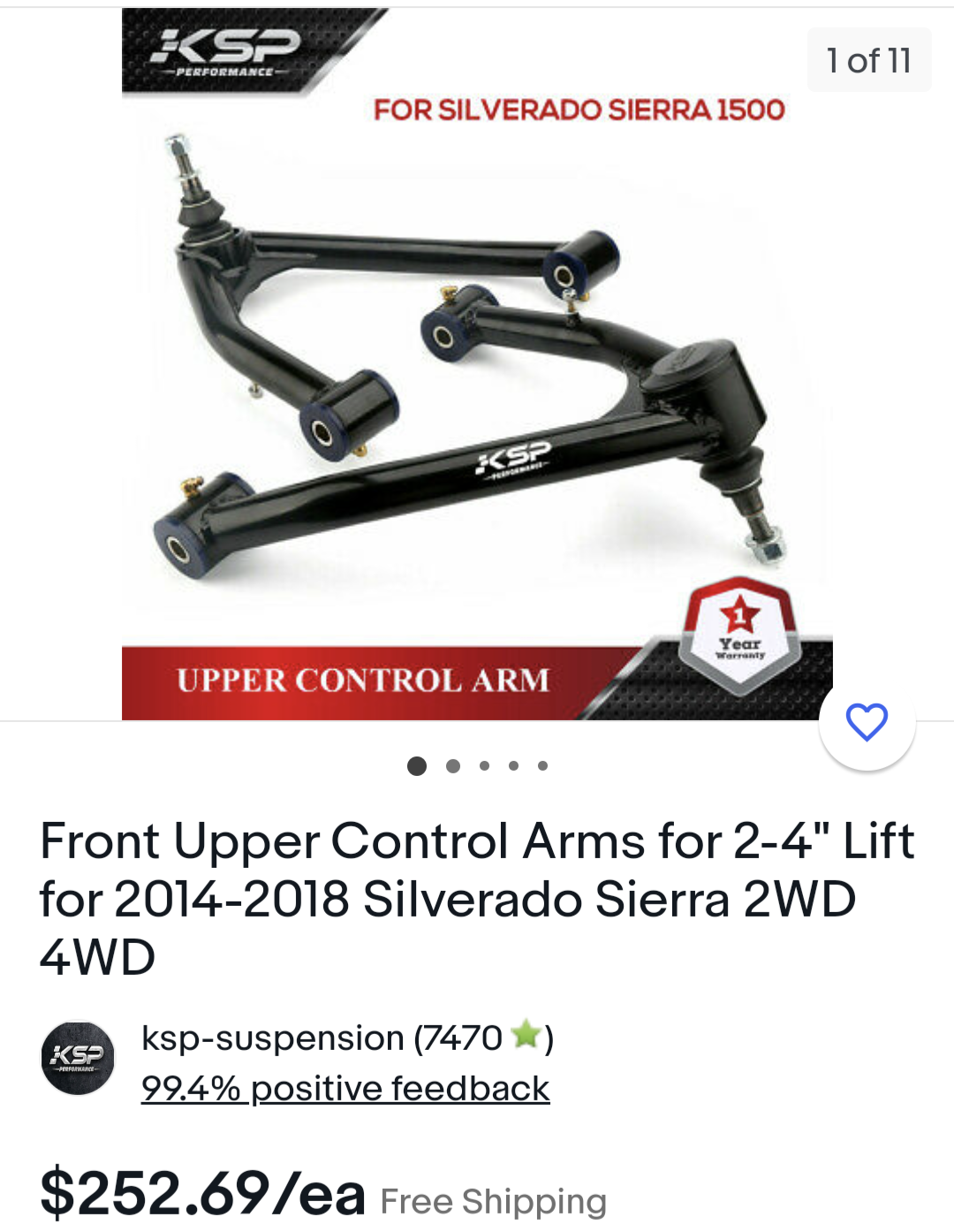

I called Freedom Off Road and they don't sell upper control arms for 15 yukon xl. It doesn't illustrate in the ebay add that the cap can be removed; it can and reveals KSP pre-installed grease zerk on ball-Joint PN: ca-293061-y
Ebay add says not to fill and is "just a decoration":
Thought about installing another ball-joint until I read a half dozen reviews about the poly requiring a ton of lubing and that it was noisy. Also things about the weld quality among other things ragging on this crap product. Anyone know if stock denali aluminum arm ball-joints can be pressed out? They look seemless..
