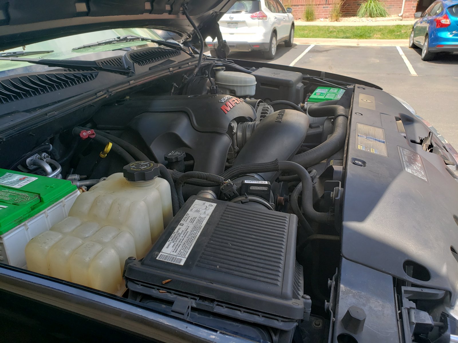

Here's pics of my dual battery setup on my 06. The setup is very similar on my 09 Tahoe. Shockingly I don't have any pictures of my L9H.

Why is there two cables off of the positive? I thought all I would need is a long enough cable with two female connections from my main battery positive to the 2nd battery positive and a ground off of the 2nd battery to the block.
I have one to the positive and the other one is going to the alternator. The 06 has RVC and I did it this way to make sure that other battery gets charged.
What gauge wire is that to the alternator?
