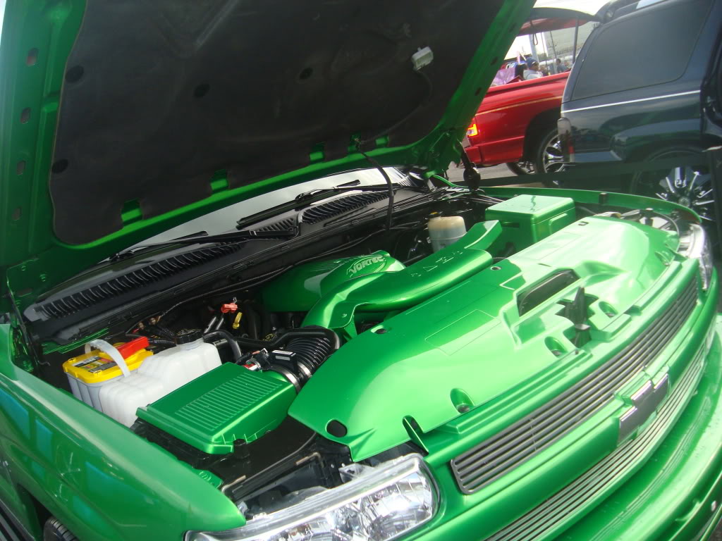

The second picture linked to a thread on here from way back, and all I can say is home boy liked his green:
http://www.tahoeyukonforum.com/threads/dual-battery-under-the-hood-for-offroad.17112/
