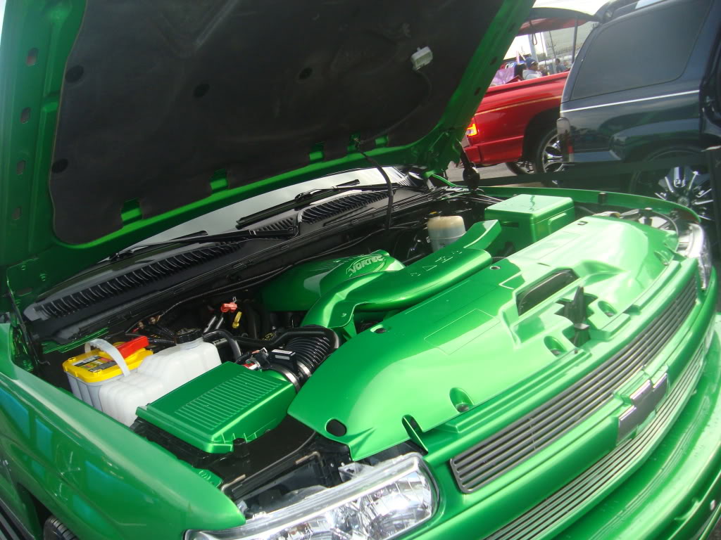

In a 2001 Yukon you already have a place for a battery mount. All you have to do is get the proper bracket and bolts. I don't remember how much they were but it was only $10-15 for all the parts. Just go to a GM dealer and they can tell you what parts you need. The location for the extra battery is on the passenger side closest to the dash. Below I'll post some pictures to give you a better idea. There are many way to setup dual batteries. I went with a National Luna kit (http://www.nationalluna.com/DIY.htm) but upgraded the battery cables to a lower gauge. The way I have them set up is in parallel. That is, everything runs off my main battery still but I have the second battery connected to it (through a solenoid) and it stays charged through the alternator also. If my main battery ever dies, I can run the batteries in parallel for a jump start. Also, running in parallel helps if I'm using my winch for an extended period of time.
If you are going to go the dual battery route, I would suggest properly connecting your amp. I would get a battery with top posts so you can connect multiple power leads (see last picture). But, I know I've seen special L-shaped brackets that screw into the side terminal and curve over onto the top of the battery for accessories connections. I can't find a picture of one right now though.

yeah i noticed that being the only really open spot under the hood..... it just doesnt seem like i would be able to fit another full size optima under there. My main batter now is a big yellow topper, id like to fit a second under the hood.
Thanks for the link, I think i will put the battery where the air cleaner went.......its big enough for a full size battery, and honestly..... the air cleaner moving to the back of the engine bay might be good... I tend to get the front end wet alot, at least the battery i can semi weather proof.

you took out that brace in the rear passenger corner?
is that not important?
