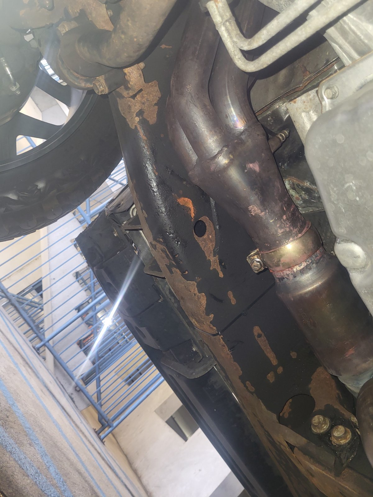

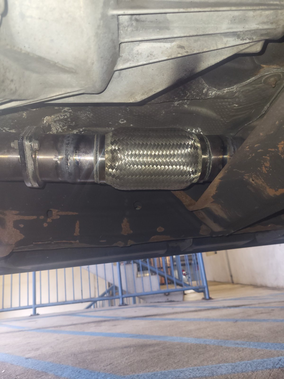

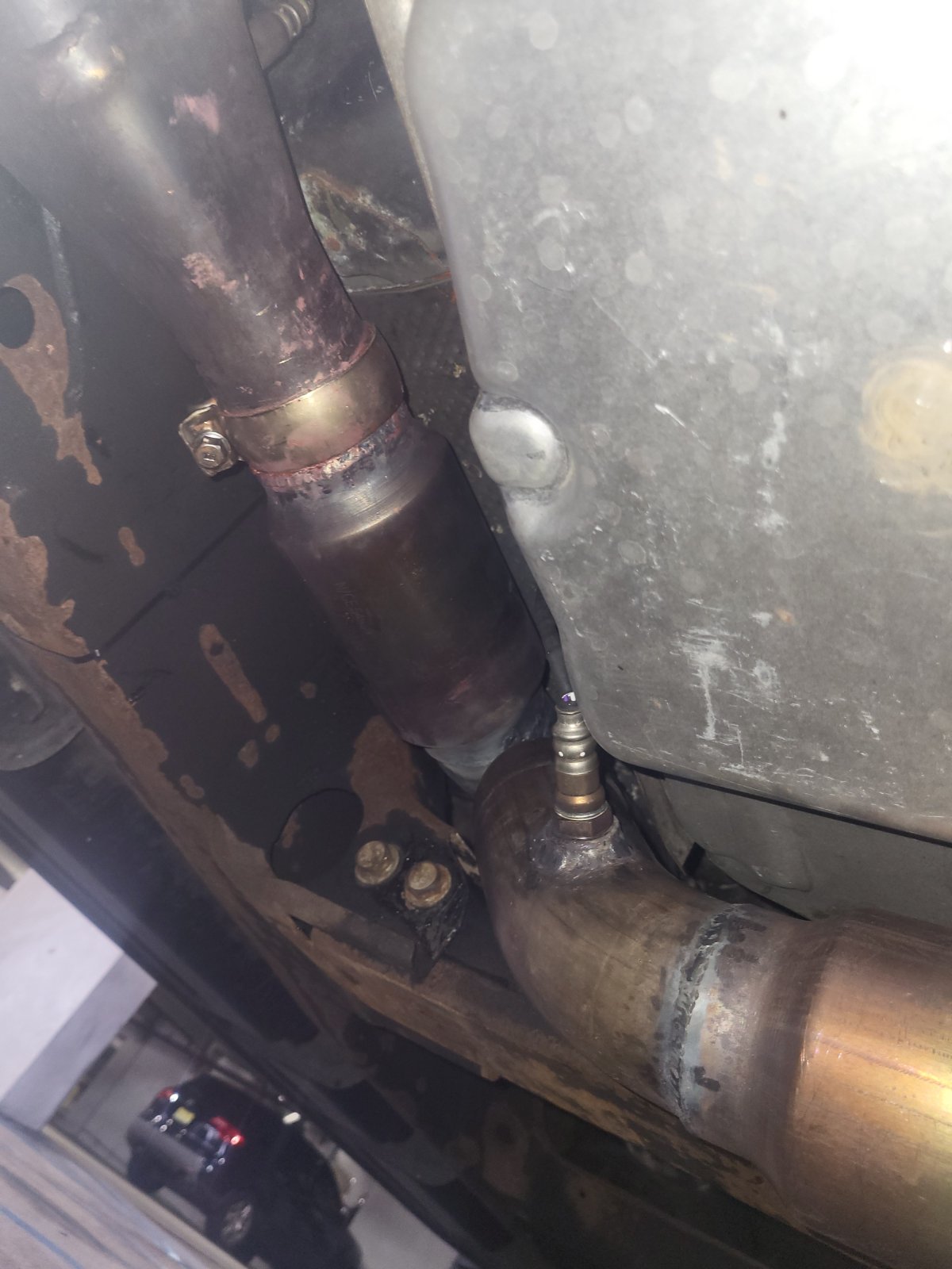

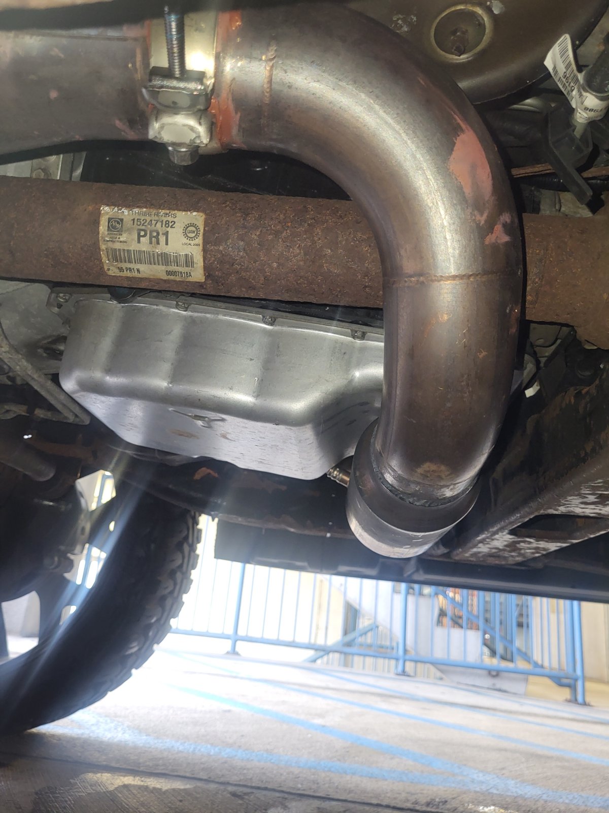

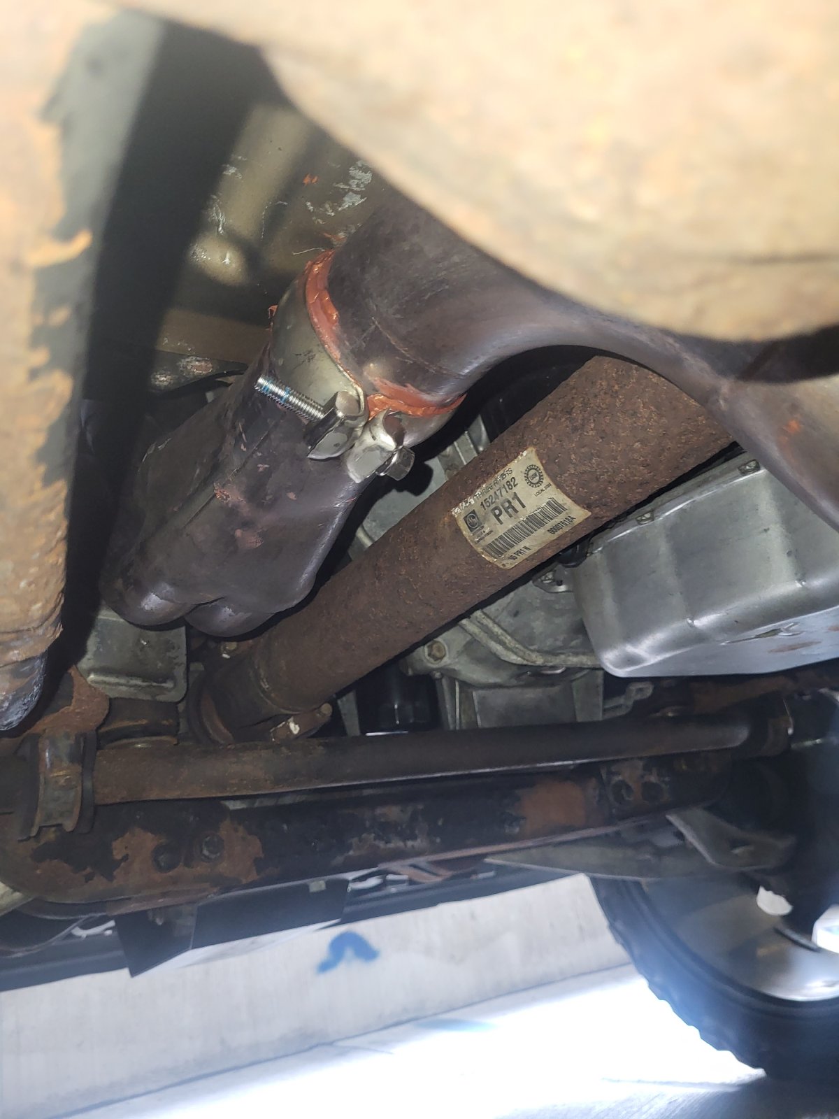

Here are some pics of how my exhaust is set up.

C
crownvic31
Jun 13, 2022
212
176
Sorry for all the post guys. Im just trying to educate myself here and just ask for advice and opinions.
