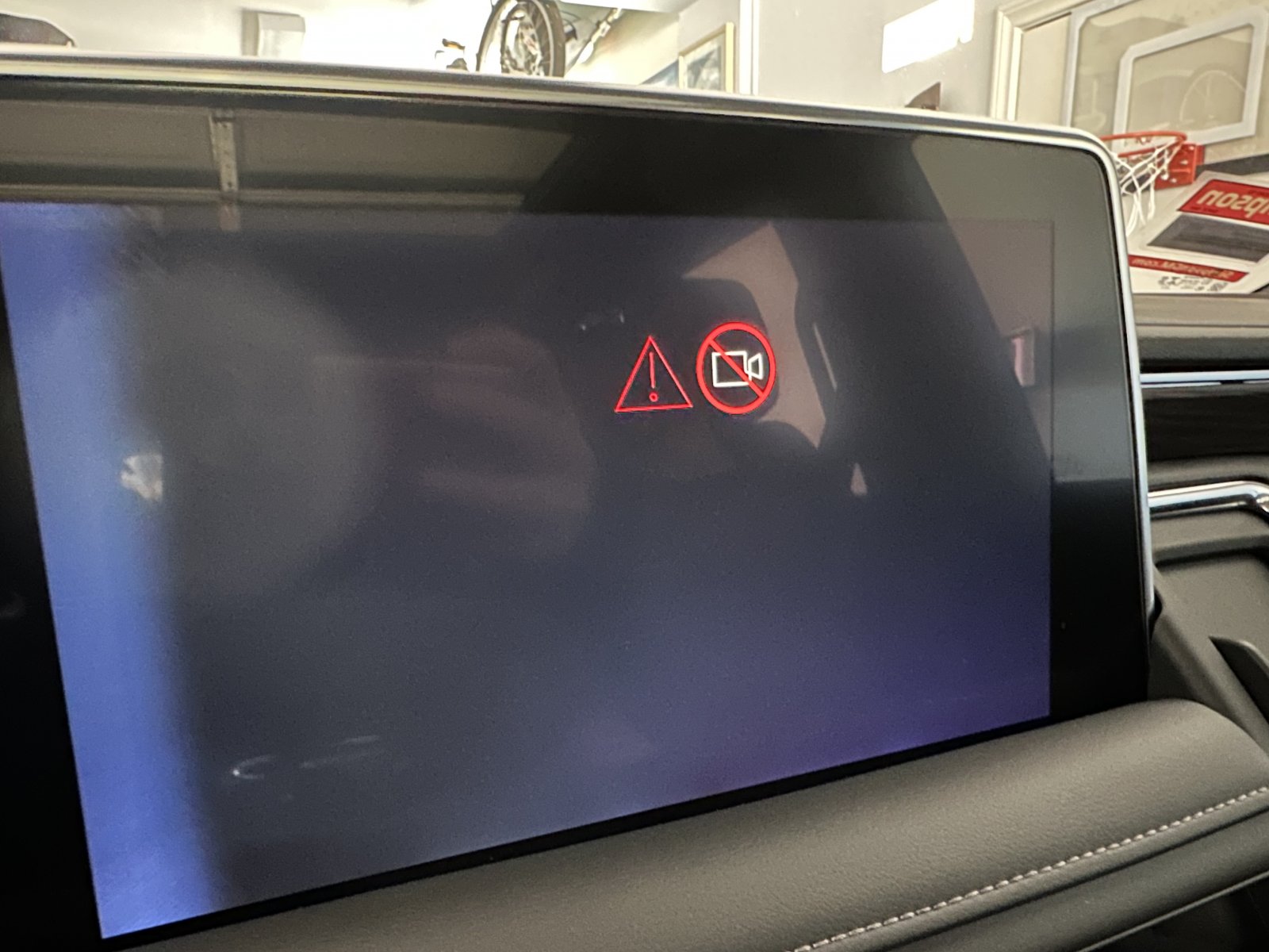

Picked up a ‘23 Z71 about a month ago and having intermittent issues with the backup/360° camera where it’s not operational, maybe happening once every few days. I’ve turned off the ignition and restarted it but that doesn’t fix it. After sitting for maybe 20-30 minutes then it works. Anyone else having this issue? I know the dealer will fix it under warranty but would rather not be without a car for a day if there’s an easy reset/fix.

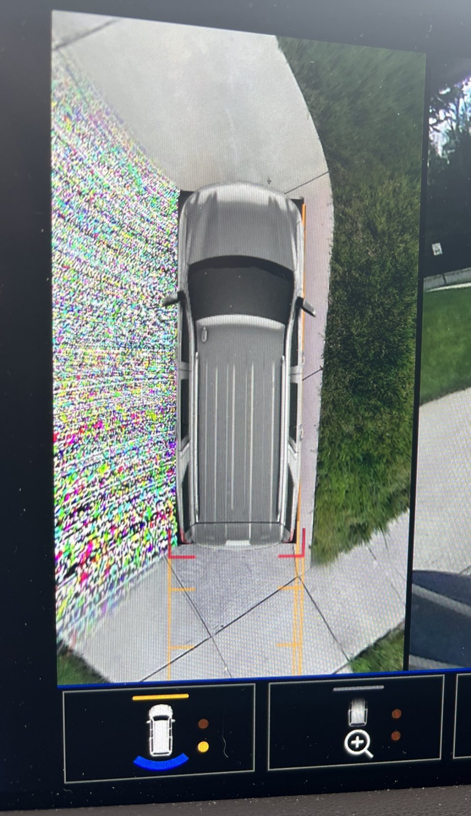

So my right side camera was going out quite a bit. Finally got a chance to look at the codes and its either the camera module or the VPM. Replaced the camera today hoping it not the VPM as thats a pain to remove; we shall see!

Happy to report (and hopefully I dont jinx it) that my side camera replacement has indeed corrected my issue. Pretty simple as well!

Hi all, just wanted to report that on our 2024 Suburban Z71 -- after about 600 miles we had the same problem
- 360 degree button or camera button on screen had no effect when pressed
- Putting vehicle in reverse showed the error shown in the original post
Took it to the dealer. Dealer replaced Module 87816606 - Video processing module which looks to be a >$600 OE part and of course my guess is this part needs to be reprogrammed by dealer to accept the VIN of the vehicle. (Just a wild guess someone with more knowledge can confirm).
That has corrected the issue.

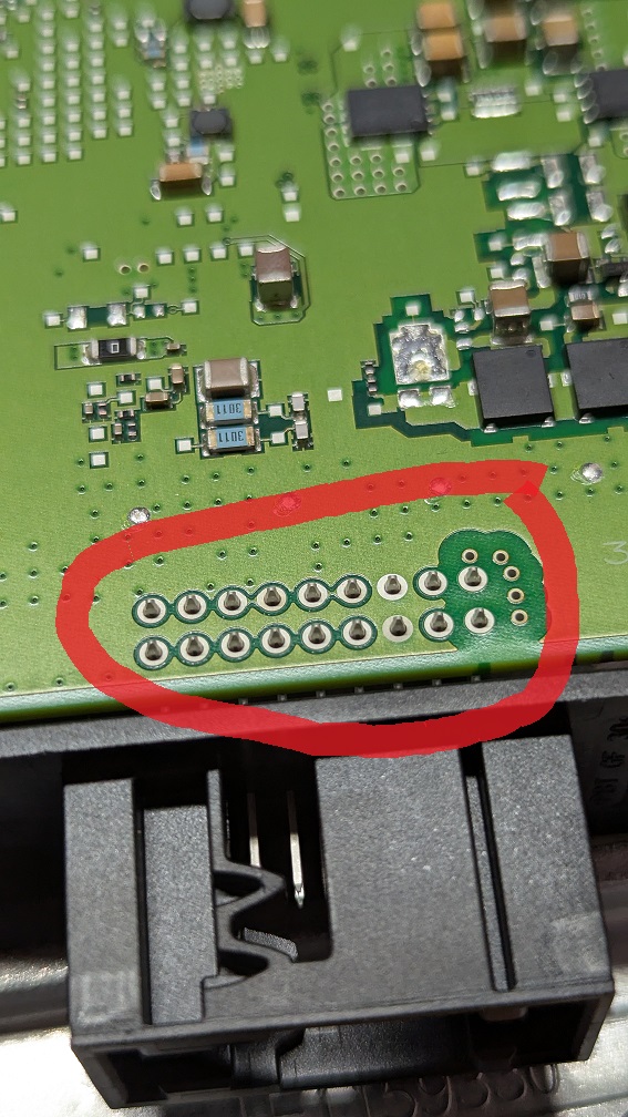

Приобрел Z71 23 года выпуска около месяца назад, и у меня периодически возникают проблемы с камерой заднего вида/360°, когда она не работает, может быть, раз в несколько дней. Я выключил зажигание и снова включил его, но это не помогает. После простоя в течение 20-30 минут все работает. У кого-нибудь еще есть такая проблема? Я знаю, что дилер исправит это по гарантии, но я бы предпочел не оставаться без машины ни дня, если есть простой сброс/исправление.
Такая же проблема, оказался заводской брак, разъем на видеомодуле не был припаян.
