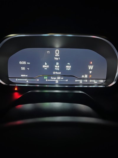

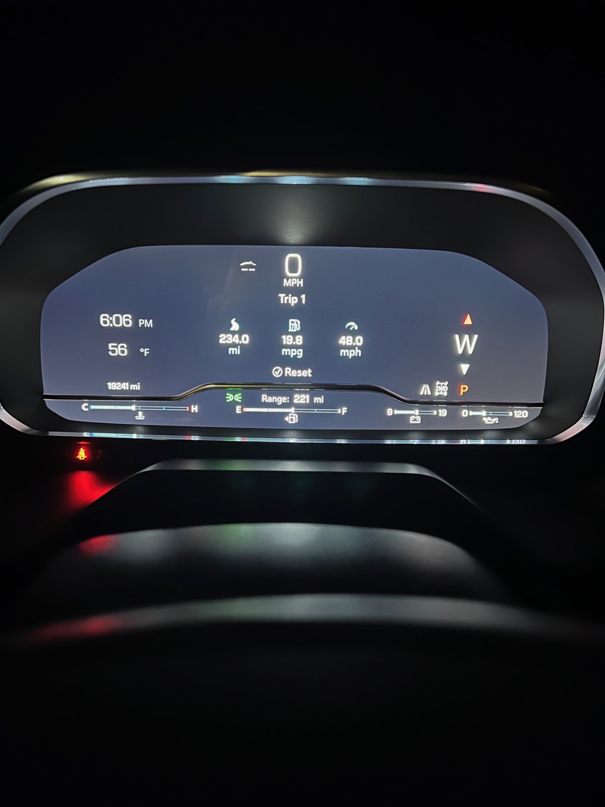

Lonnngggg time lurker first time poster. I have only owned 3 cars in my life, all are Chevy tahoes. First a 02 z71 then an 11 lt, now a 24 rst. I took the first 2 over 200k largely through finding out how to repair common issues on this site :) no one turned a wrench on the first 2 besides me!!
For the first time I’m having an issue I don’t see others having. My 24 after sitting for 18 hours or so will only partially load the digital dash when it is started. It looks like the black layer with most of the text is there but the blue doesn’t load on top of it. When this happens, it will stay like this for the duration of the drive until the engine is restarted. Also, oddly the left rear steering wheel buttons that go to next channel don’t work until the next start.
Based on the time observation I assume we are dealing with a battery drain/low voltage situation.?
Wondering if anyone else has dealt with this? I haven’t tried dealer/warranty route yet due to ****** past experiences and the fact that I own this car to drive 4 children around so it will be tough to be without it for even a day and the issue takes a day of sitting to reliably reproduce.
Thanks for reading and thanks in advance for any insight you can offer.

I really appreciate you sharing your experiences—guess I’m not alone. I’m glad you mentioned the radio cut out. I absolutely experience that also. I had just written it off as momentary loss of connectivity but it’s too predictable so it must be related. I also seem to get a front collision system unavailable light occasionally under these circumstances—I also just wrote this off as dirty bumper but again it’s predictable.
I have tried cycling through the dash options and that does nothing to change my display issue. My day job is a software engineer so I can see how they developed this display in layers to facilitate loading. Some odd failure mode is activating and not alerting the user.
Just now I ran a test it had been sitting about 18 hours and I had no issue, but last night I did have issue after sit of 24 hours.
Most of my drives are shorter, vast majority less than 10 miles. I have had this since new and was hoping to have another 12 year issue free experience but that seems less likely—I fear this is a symptom of battery drain which stands to leave me stranded at some point lol
Combining this with L87 issues (seems like a given this is not another 200k engine) it’s hard to have faith in this vehicle. A tough pill to swallow for the outrageous cost. :-/
