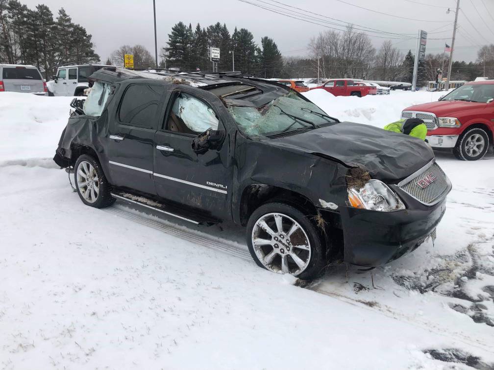

Last week while on a fill trip, I hit a patch of ice and rolled my 2010 Yukon XL Denali. I am pretty sure this vehicle saved our lives along with some help from above.

Below are pics of the Yukon. All of my kids were in car seats and were all ok. My wife has a concussion and I ended up trapped in the driver's side for an hour with a large laceration to my hand cutting a tendon. We were very lucky

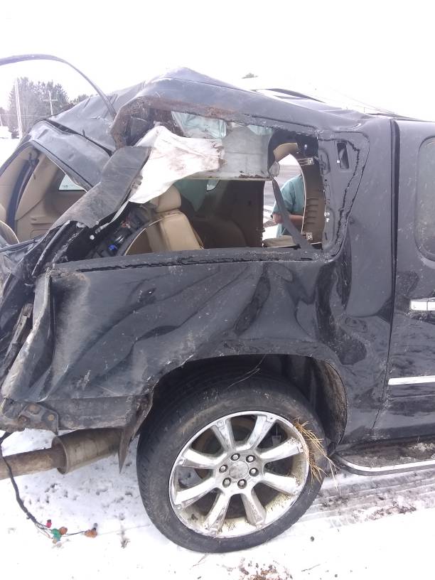

3rd photo looks like a GMC version of the avalanche..
FRONT END swap might be in order.. for some 1 with an avalanche
