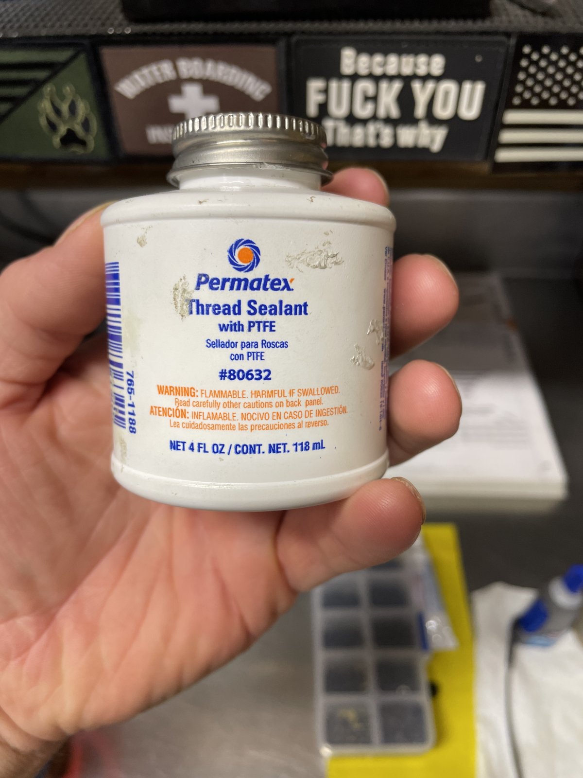

A couple things I would note is to ensure you clean off the threads and the ends of your drain/fill plugs since they are usually magnetic and may be holding some shavings. The transfer case drain/fill plugs occasionally need to be re-coated. I use Parmatex Thread Sealant #80632. Don’t go crazy with the stuff and don’t drop the axle drain plug for your John Deere tractor into the container. It’s a mess to fish out of the bottle. Ask me how I know…I dare you.

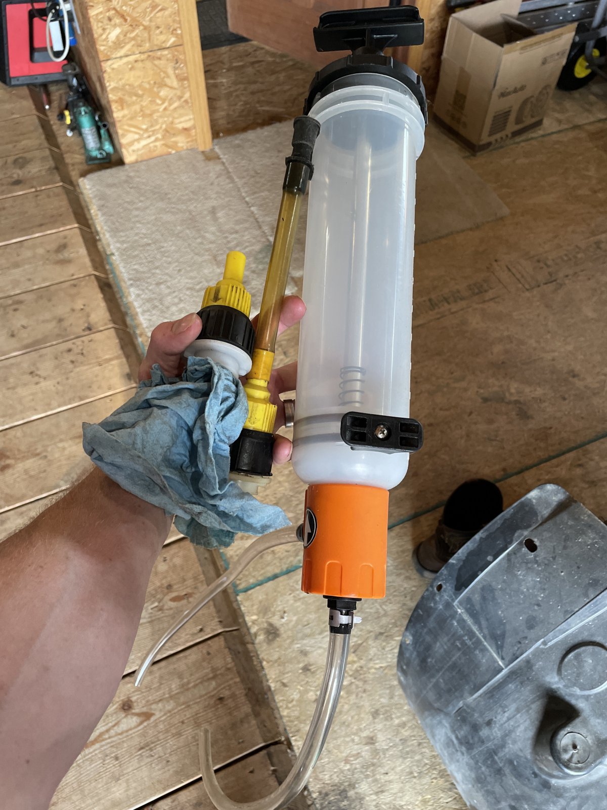

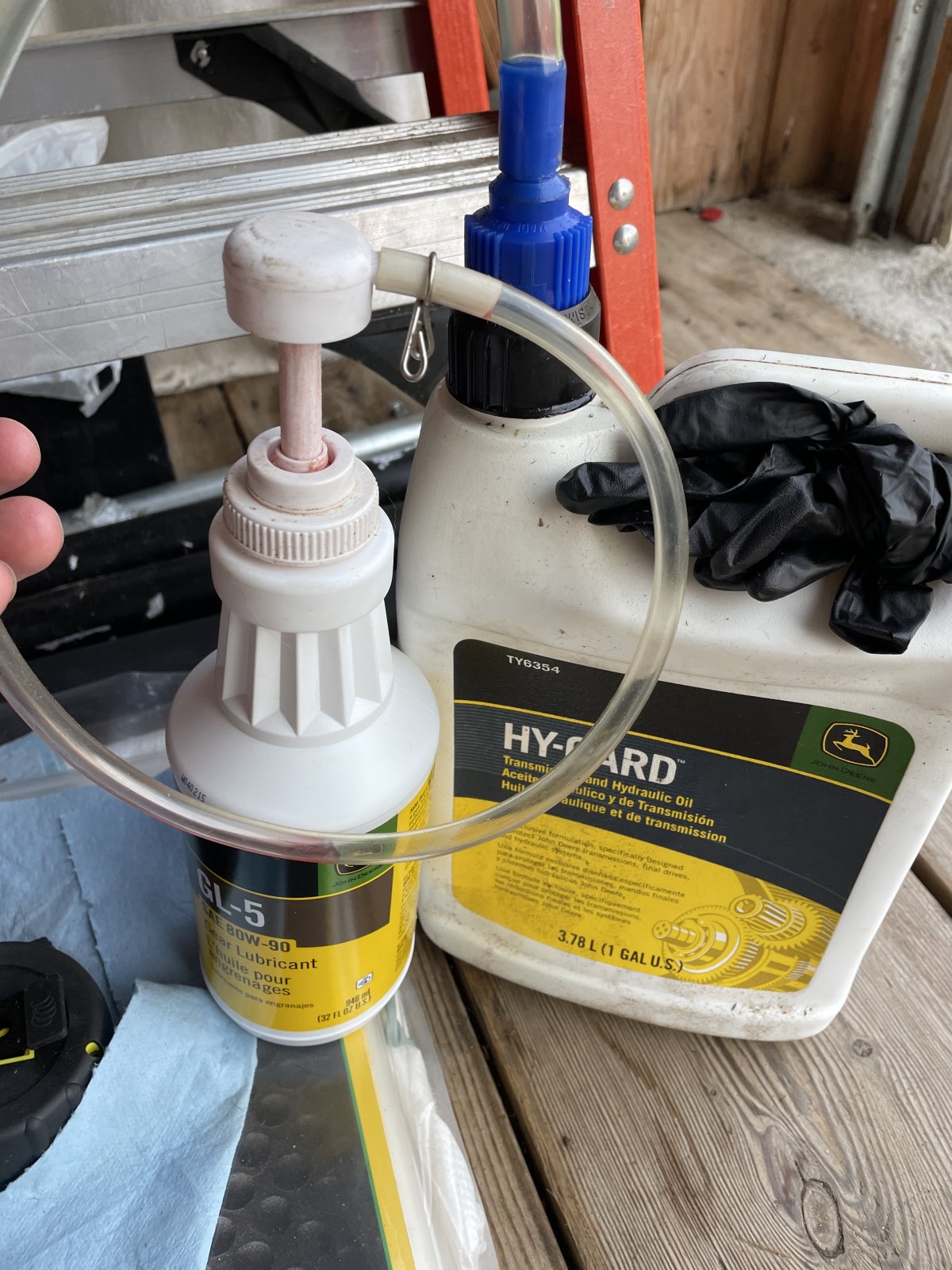

Gear Oil is some smelly $h*t, especially used gear oil. Wear some nitrile/rubber gloves, long ones if you’re not proficient at what your doing. And buy either a transfer pump, a screw on hand pump, or the twist cap with a long hose. The latter two are not the best option, but they work in a pinch. Careful though as the tops don’t secure the greatest.
