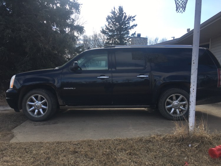

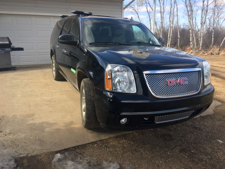

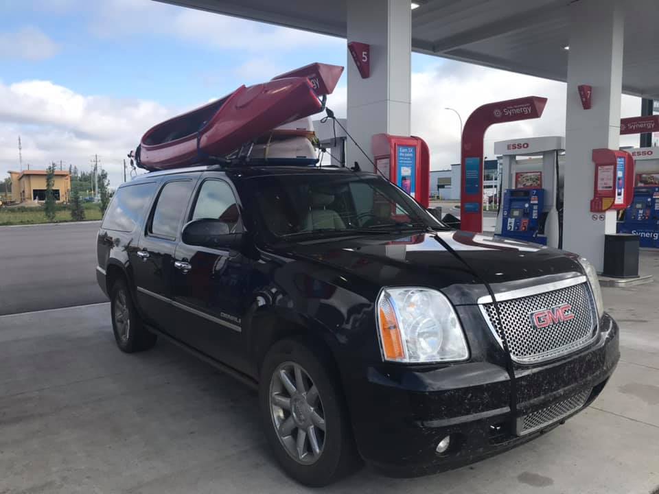

Thanks for the warm welcome and, you're right. I was surprised to get such fast replies.
The Yukon is my Wifes DD and I haven't done much to it yet. I am about to start a bit of a 'make over' on it for her. We live on a gravel road and the paint is getting ROUGH at the bottom. Not rusting yet but it wouldn't be long. We do a lot of hunting trips, hiking and kayaking. I plan to start making this a little more offroad (very moderate) friendly as it has much more room and comfort than my trucks.
I have talked the wife into letting me keep the Yukon in the garage for a month. She knows I plan to raptor spray the rockers but I have a bit more planned, hopefully I can get it done around my work schedule without her peeking in the shop. Plans are- Fix auto level, 2.5"F/1.5"R Level, Black 18x9 rims 275/70r18 copper AT3 XLT tires, raptor the bottom, bumpers, Paint the grills, door handles and roof rack Black, then a full cut and polish. Also getting rid of the Power assist steps (They fill up with gravel) and I took off the peeling side moulding last week.
I plan on making a post with these mods once they are done.
