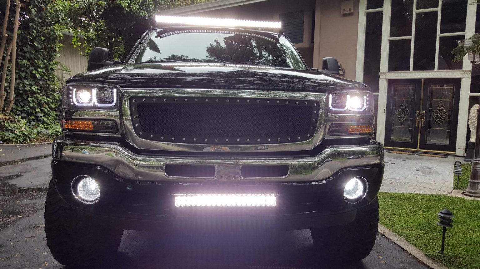

So I though I could get some new projectors that had halos. The ones like like have very bad reviews, so I kept looking until I found this Anzo set, and saw how it looks on user HoLLyWoOd's Sierra:
They are the Anzo USA 111303 set on amazon.

My Denali knock-offs are also lightly smoked, so I'd get slightly more light out of a new set like this that was not smoked at all. I'm not sure what would look better with my big chrome grille, the black ones or the chromed ones?
