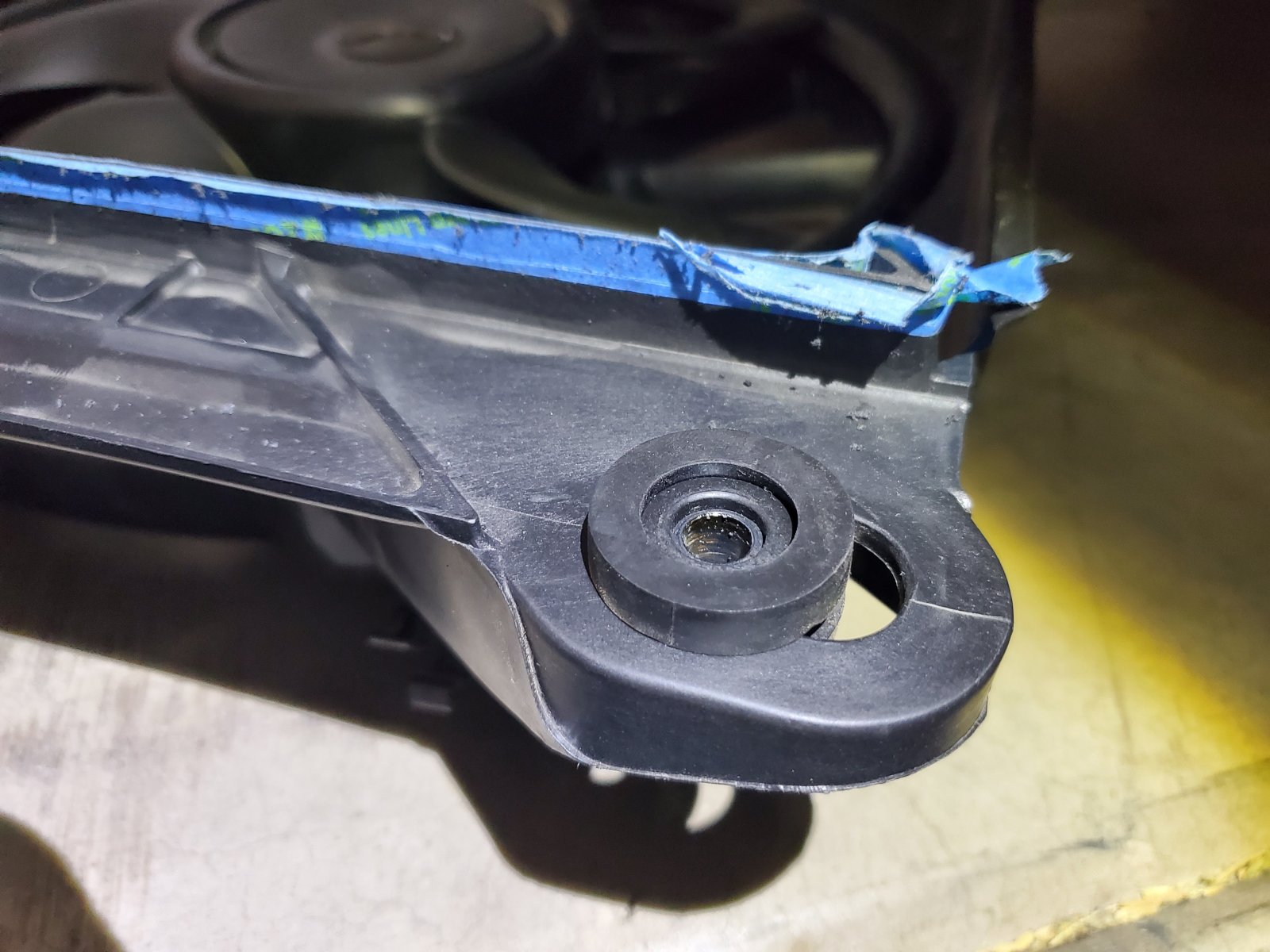

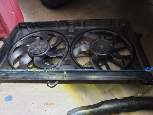

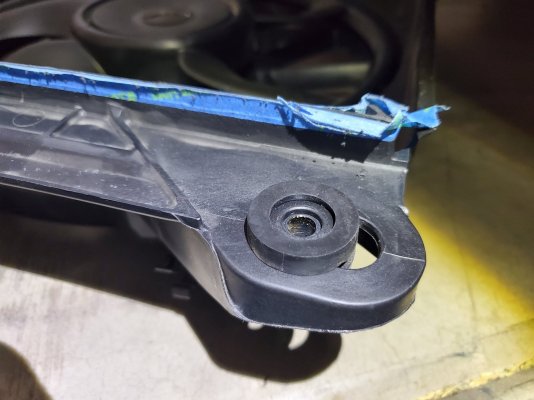

Ok, I got the radiator installed on Monday evening (in between badly timed calls from work). One thing I can confirm from one of the reviewers on Jegs who purchased this rad is that you do have to trim your radiator (if you have factory electric) to get it to fit on the new rad. Since I swapped out my clutch for a direct oem electric fan from an `05 that obviously applies to me as well. If you look at the two pics you can see where I trimmed for fitment. I used painters tape as a guage as to how far down to go. It seems however I had to take those edges down near flush. there is still a small side gap between the rad and the E-fan after mounting but I have some high temp weather strip on the way to take up the space and I see that as a very minor issues (if at all).
Also note that the upper radiator port on this rad is slightly smaller than the OEM port. The OEM hose was just a tad loose fitting. Just enough where there was a minor drip when I was testing it out. a second clamp solved this issue.
So far everything seems okay. I will follow up if anything happens.
Sorry I did not include the pic of the rad. It fits exactly like OEM. Nothing out of the ordinary.
