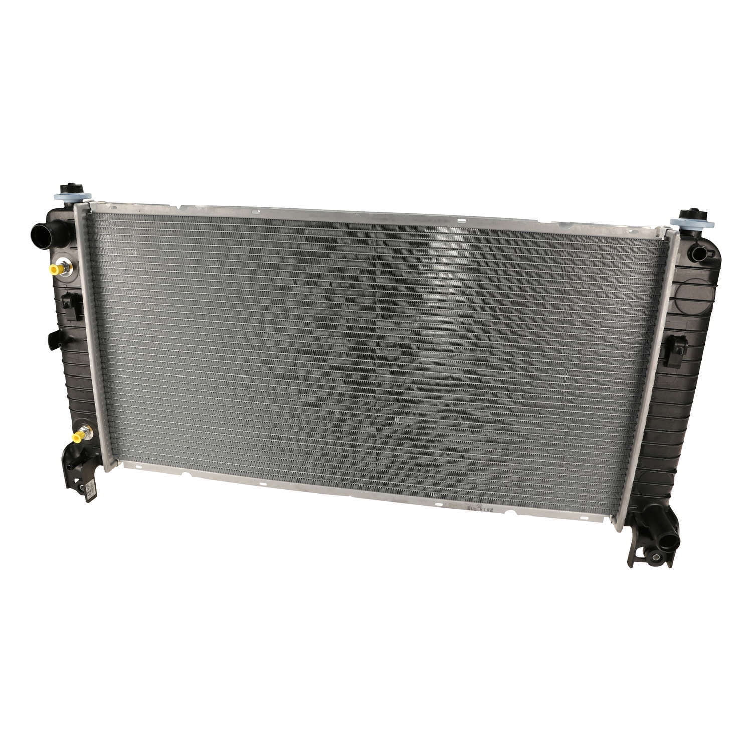

Looking and scouring the internet for a good deal on another radiator, I actually found........ GM Genuine AC Delco 21650 for $131 !!
Was delivered today, free shipping, box has the hologram GM logo and all, looks official, says Country of Origin: USA manuf date 2025!
(item shipped/sold by walmart, no 3rd party invovled)
Anyone who needs one, I'd jump on it
-This is the model for Trans oil cooler only, no engine oil cooler
(AC Delco 21650)
The Walmart vehicle matching system is broken for this item, probably why the price has been reduced. It says it does not fit yukon/tahoe/suburban/escalade. I dunno what they're doing - their loss, our gain!

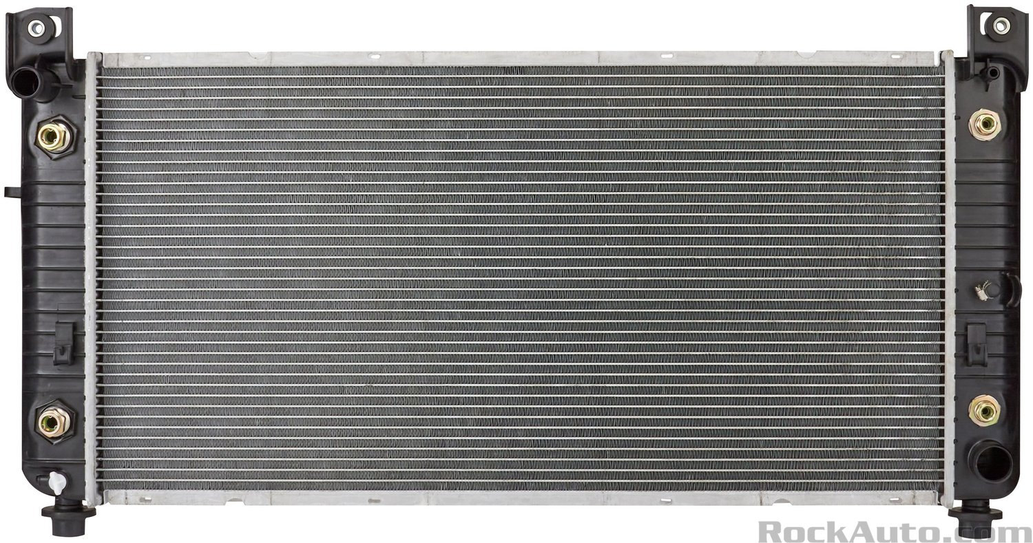

If you don't have transmission cooler lines already installed then you're fine. That 21650 radiator only has provisions to connect the engine oil cooler lines. (driver's side)
See the two quick-connect fittings on the left end tank? Those are for the EOC lines. If you have a transmission cooler fitted from the factory, there will be similar fittings on the other end tank (passenger side), and they route to the cooler behind the grill, and back to the driver's side of the transmission. Not every vehicle had them, but you'd really want to be sure you're getting the correct radiator before you start disassembling stuff and realize you have the wrong radiator. If you glance at your glovebox build sheet, and see the code K5L, you'll definitely need a radiator with both the EOC and TOC fittings.
This is a Spectra CU2370, and it's a perfectly good radiator (I'm running one after my all-aluminum Champion radiator failed, and well.... "there's nothing more permanent than a temporary solution"). You can see the additional transmission oil cooler line fittings on this model, and it also has a drain plug, which is nice.

Actually....!!! I just realized the Walmart product image is flipped/reversed. Look where the expansion tank nipple is located on that top photo, vs. the Spectra photo (from Rock Auto). And, when I searched images of "AC Delco 21650" the correct image orientation showed up, so... I guess you're good to go with that radiator model.
So, my original info is still correct (oil cooler line orientation), but not applicable in this instance.
I still wouldn't give Walmart money, though.
Nice catch! In case anyone doesn't get it, "flipped" in this case does not mean "mirrored," it means it's turned 180° out. The upper driver side that should be at the top left of the photo is at the bottom right. Note the mounts.
Here's some specs on that Spectra...
They DO list the rows and length of the oil coolers inside!
