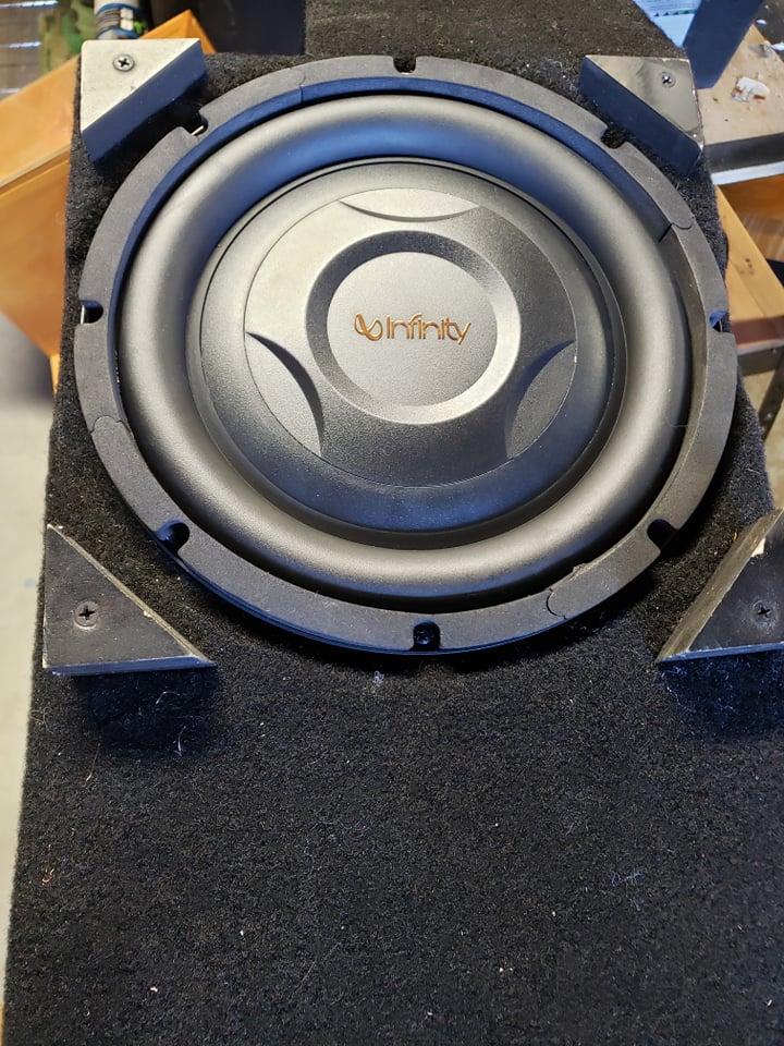

I will be installing both tomorrow the 11 inch console box was tight putting the speaker in.
Also Bought the 12 inch between captains chair one the hole is a little big have to check and recheck the screw will hit wood and not openness.
What do you mean it was tight? Did you use the info Rodney provides ? You shouldn’t just use any sub, you need to look at the overall depth of the sub and recommended cubic inch minimum for a sealed enclosure to match sub to box. If you get the wrong speaker it’s not going to sound great.
Tight meaning it was not hitting the bottom of the box but around the hole itself had to sand it down in couple spots for it to almost drop in.
The one I bought is close to the Kicker listed in the ad - (not the 12 inch listed in one of the photos)

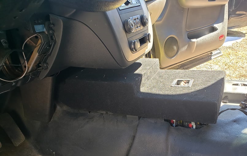

Got the box installed Had to use a rubber hammer to fit the front part in also had to trim part of the lower console for it to fit. Be warn it is a very snug fit. Waiting on 2 amps to show up.
It’s meant to be a tight fit so it doesn’t rattle. You don’t even need to screw it down. The console holds it tight.
Did not screw it down once the seats went it I could not move it might pull it later if it rattles and put foam around all the metal contact points.
