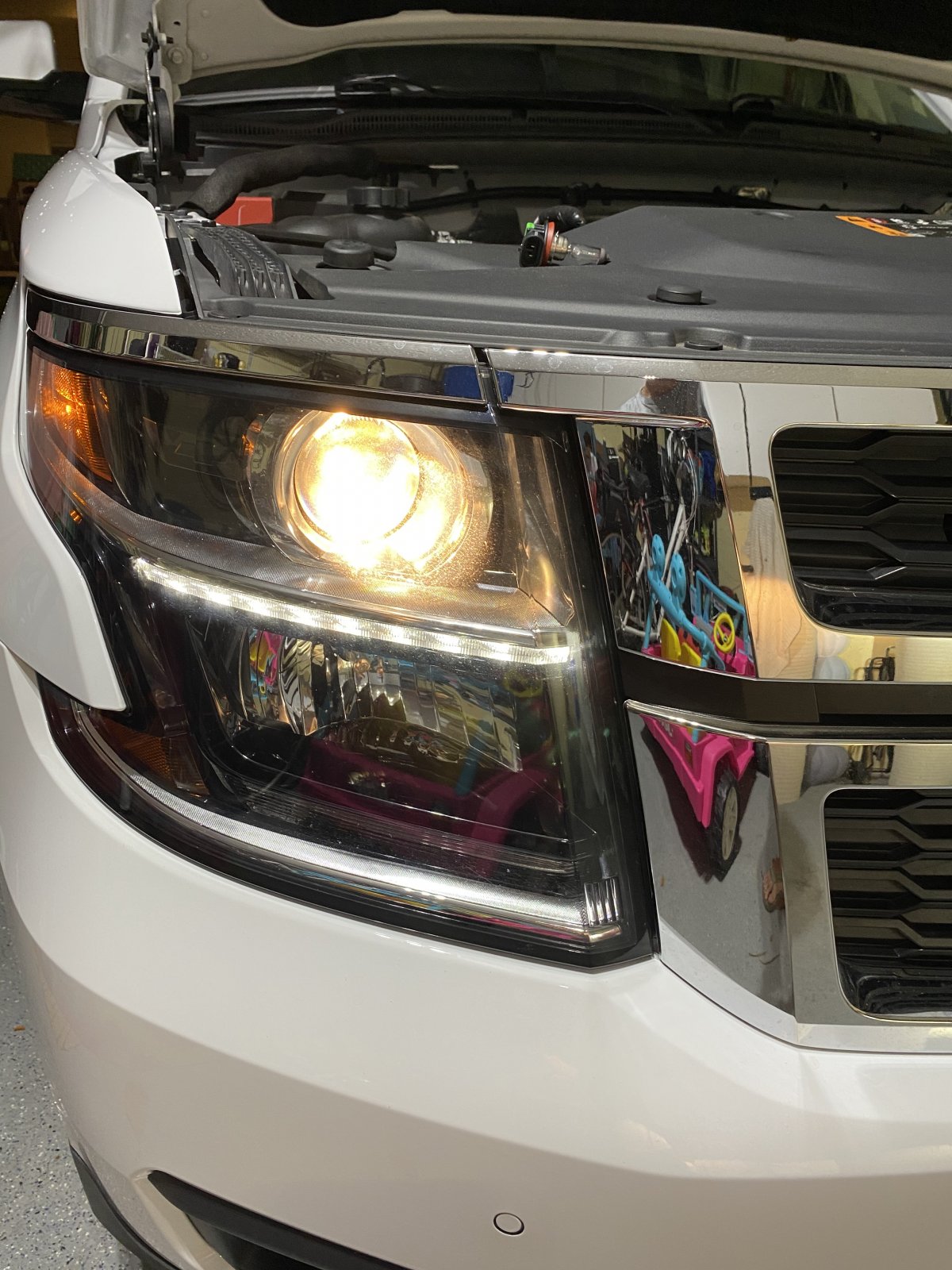

I’ll start off by saying I’m very impressed with the light output. Pretty incredible really, and I’m disappointed a $60k+ vehicle comes with the terrible halogens when comparing them to these.
The install was very easy. Particularly the driver’s side. The passenger side wasn’t bad, but it did entail removing the air box. I used this link for the directions, and it is spot on.
All in all the install took about 20 minutes. The only surprise with the outcome is the fan noise that emits from them. I guess I was expecting a silent bulb, but it definitely is moving some air in those airtight housings. Unnoticeable when your car is on, but when you unlock and the lights come on, it’s very noticeable. Not a big deal though.

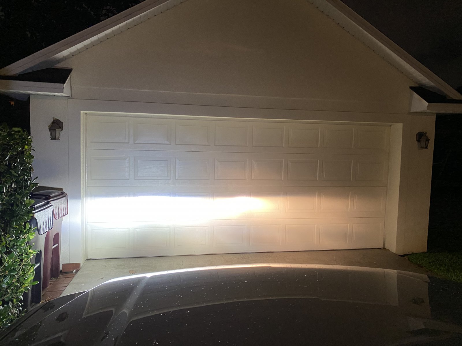

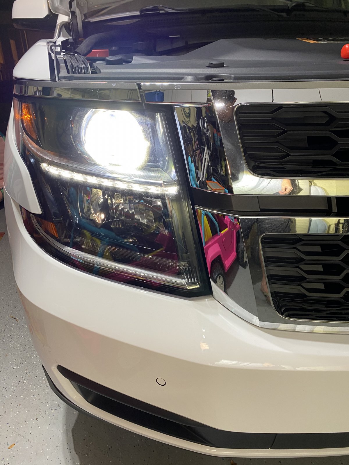

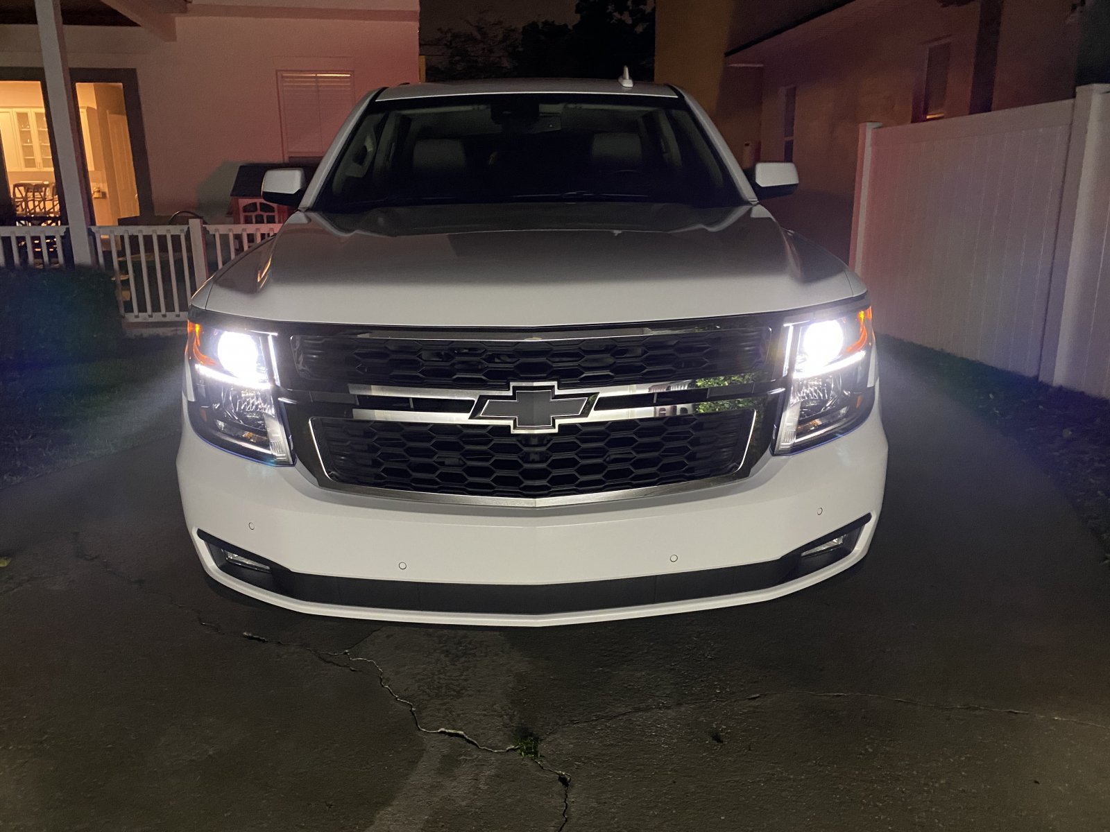

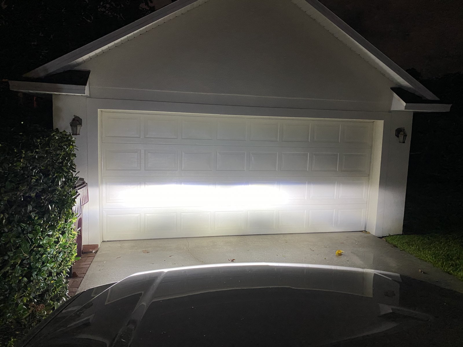

I took some before, during and after pictures against my garage. You can see the difference in the hotspots. I haven’t been on the road with them yet, but I’m sure it’ll be a huge difference. I’ll also point out the the cutoff line is the exact same, so I am not expecting any upset oncoming traffic. Let me know what you think!
Factory Halogens:
GTR 2 on Driver side and Factory Halogen on passenger side:
GTR 2 on both:
Factory Halogen:
GTR 2:

Nice! They look great. Looking forward to installing them when I get them. I’m getting the low beams, high beams, fogs and switchback turn signals in the front and reverse and brakes for the rear. I will post photos when I get them all done.

LEDs should always have long distance shots. I had the same excitement with my LEDs (different application) and they are significantly under performing at normal halogen differences. Love to see some shots down the road.
