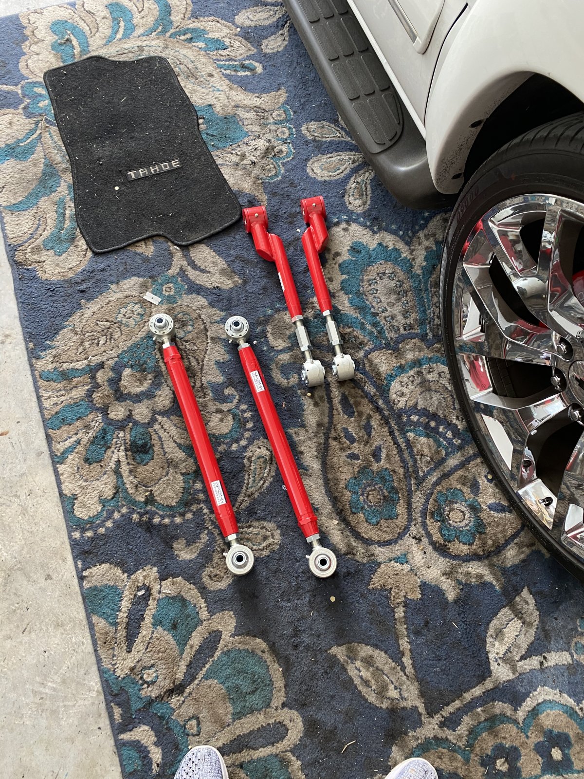

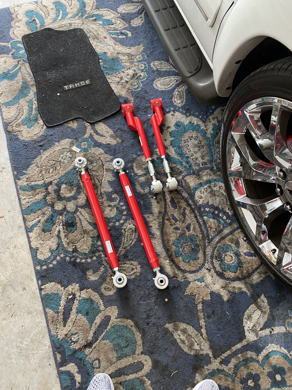

They make the adjustable round ones and the boxed non-adjustable ones. Here's the description for the boxed ones:
"Our boxed rear lower control arms outperform the flexible, stamped-steel arms and soft rubber bushings that come from the factory. Eliminate wheel hop, get more stable towing performance and increase traction with an easy bolt on installation. All ends are fitted with grease fittings for easy lubrication of the fluted polyurethane bushings. Available powder coated in your choice of the above colors for a brilliant and durable finish.
Our boxed rear lower control arms are constructed from 2.0" x 1.5" x .120" wall rectangular tubing, and are 100% TIG welded for the ultimate in strength and appearance."
I'm interested in wheel hop and traction since I'm installing a blower. I want to hook up and I don't need to adjust them. I just reinstalled my 26" wheels after winter and rechecked the front-to-back. They're only off by 1/8"- 1/4". At the most I could move them forward 1/8" to be perfectly centered. Not worth it.

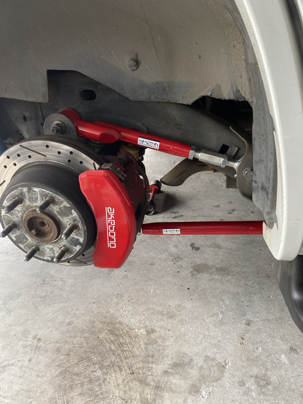

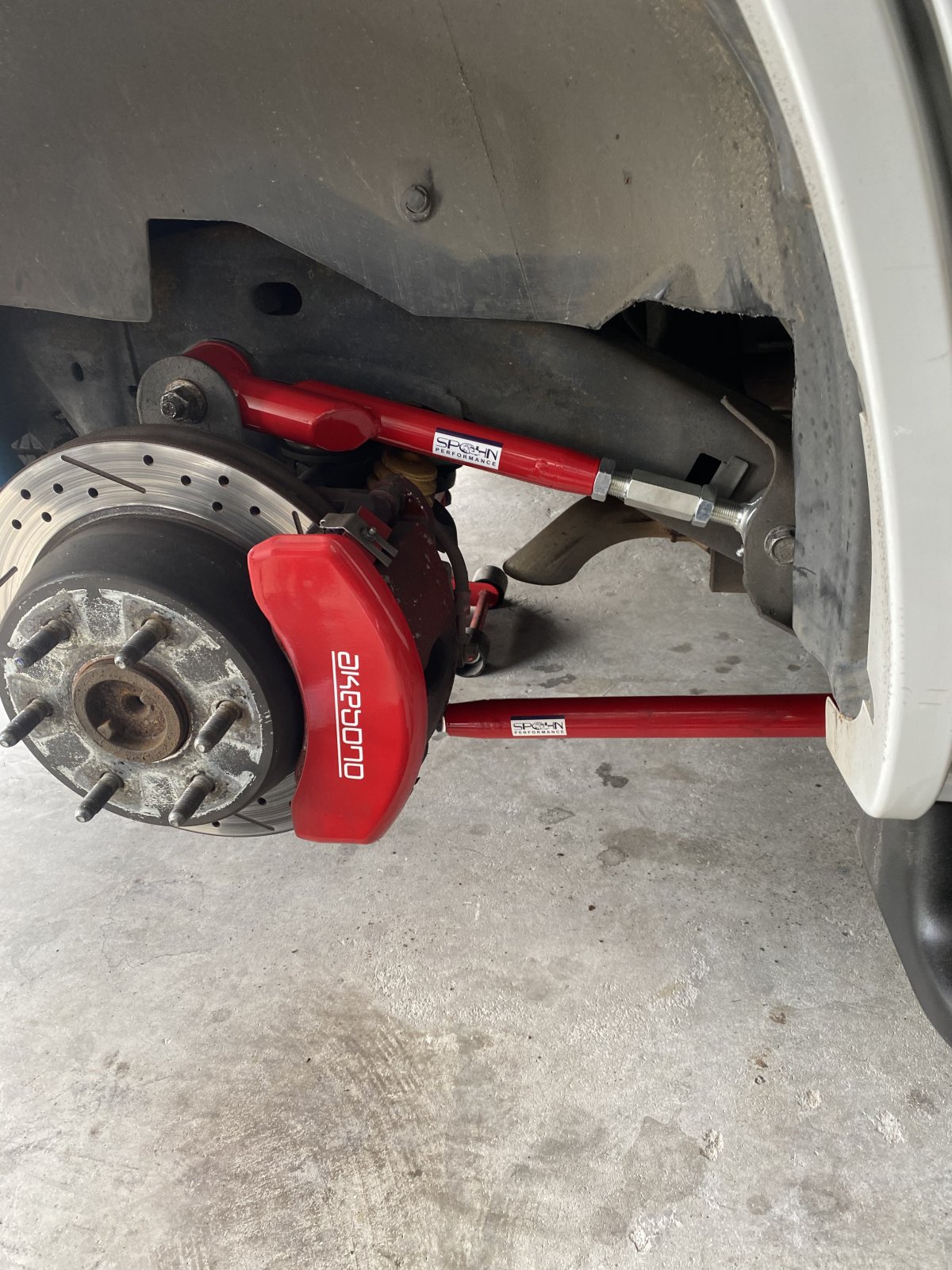

Here we go I had to adjust mine my rear wheels didn’t rub hardly at all but after I installed these they did so I had to move the wheels toward the rear more
