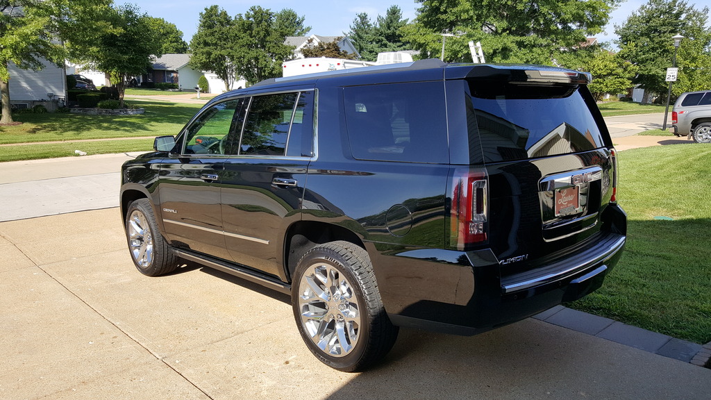

Does anyone running 305/40-22 on OEM 9" wheels. I have opt SEY wheels and would like get more protection from curvee since my wife drive it sometime. Plus looks nicer with wide tires. So will they rub. Here is how looks now

Does anyone running 305/40-22 on OEM 9" wheels. I have opt SEY wheels and would like get more protection from curvee since my wife drive it sometime. Plus looks nicer with wide tires. So will they rub. Here is how looks nowView attachment 222113
