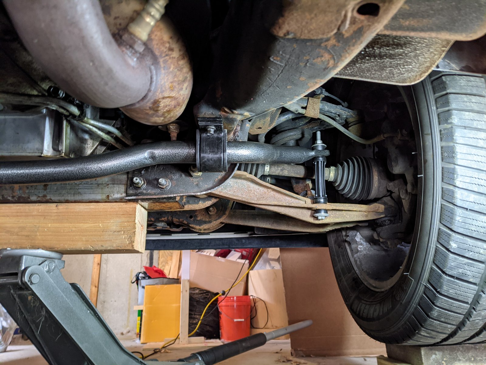

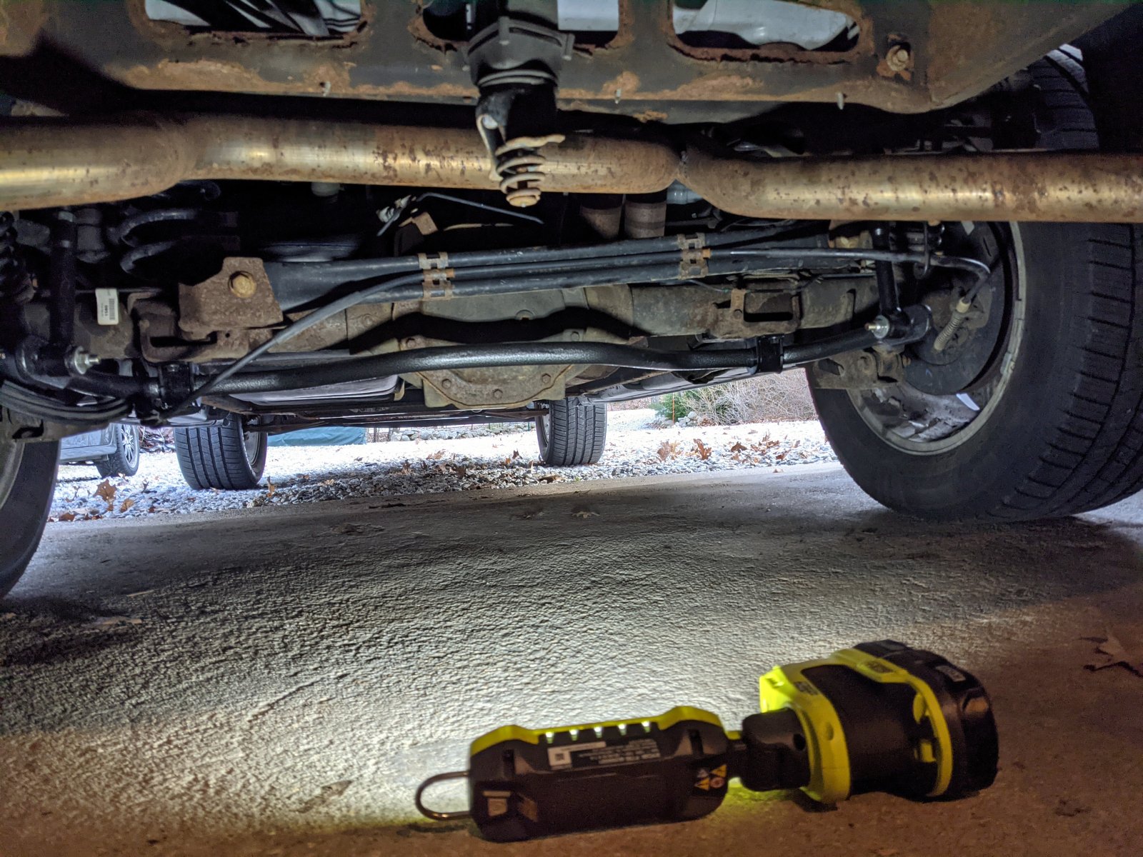

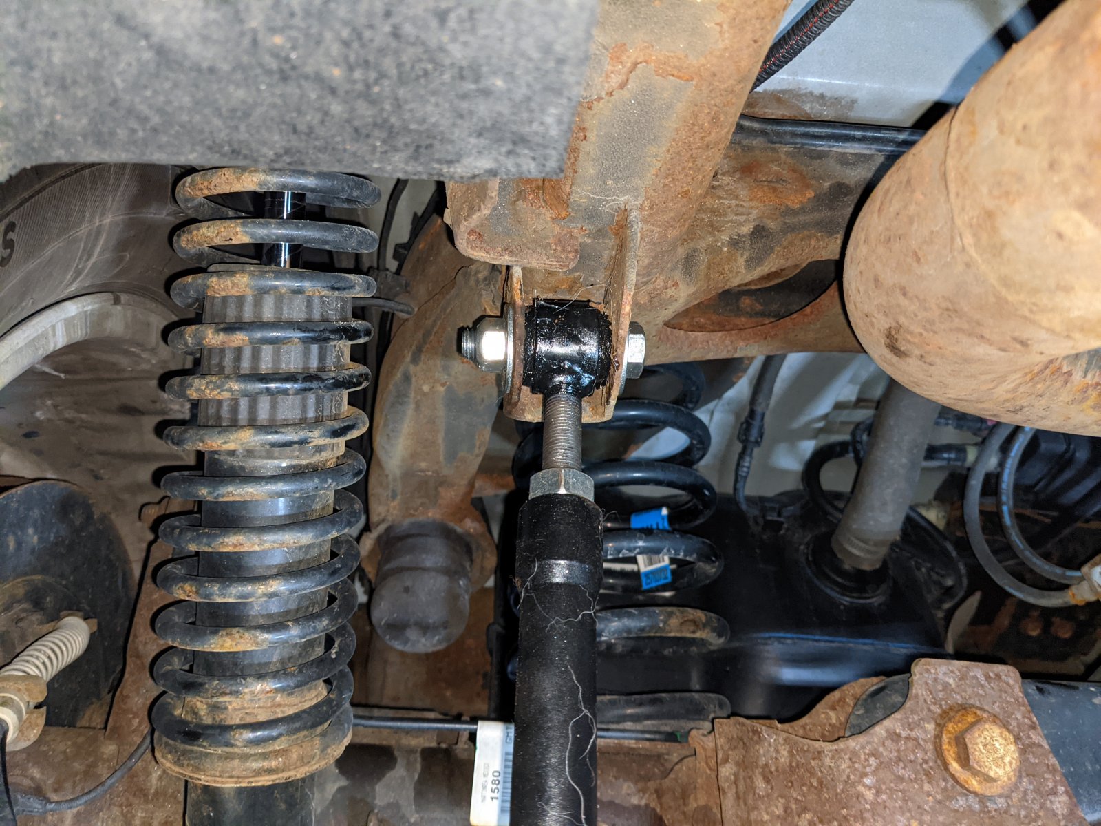

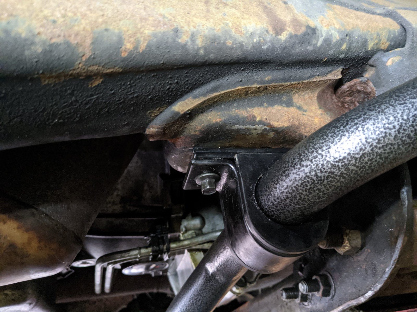

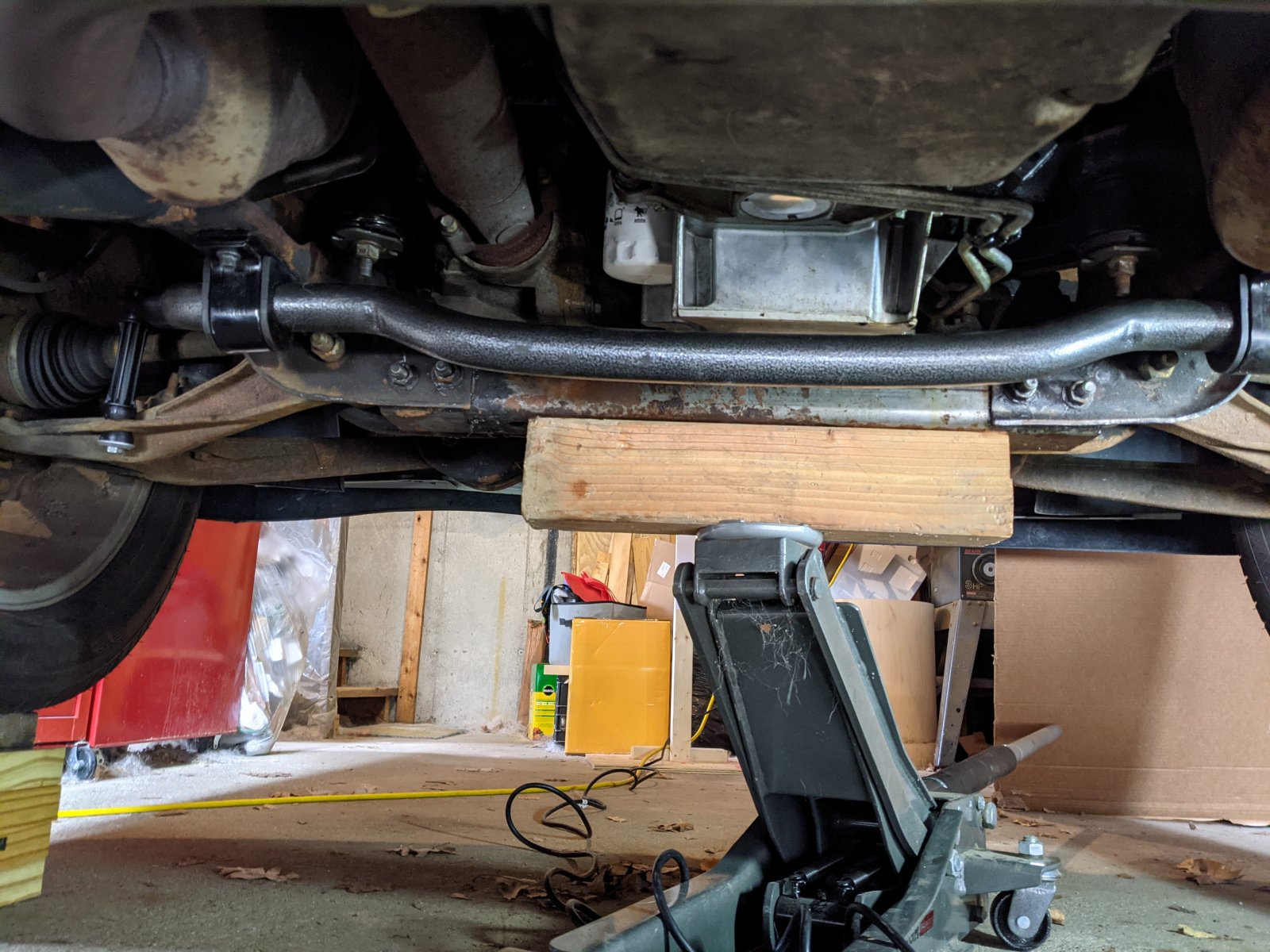

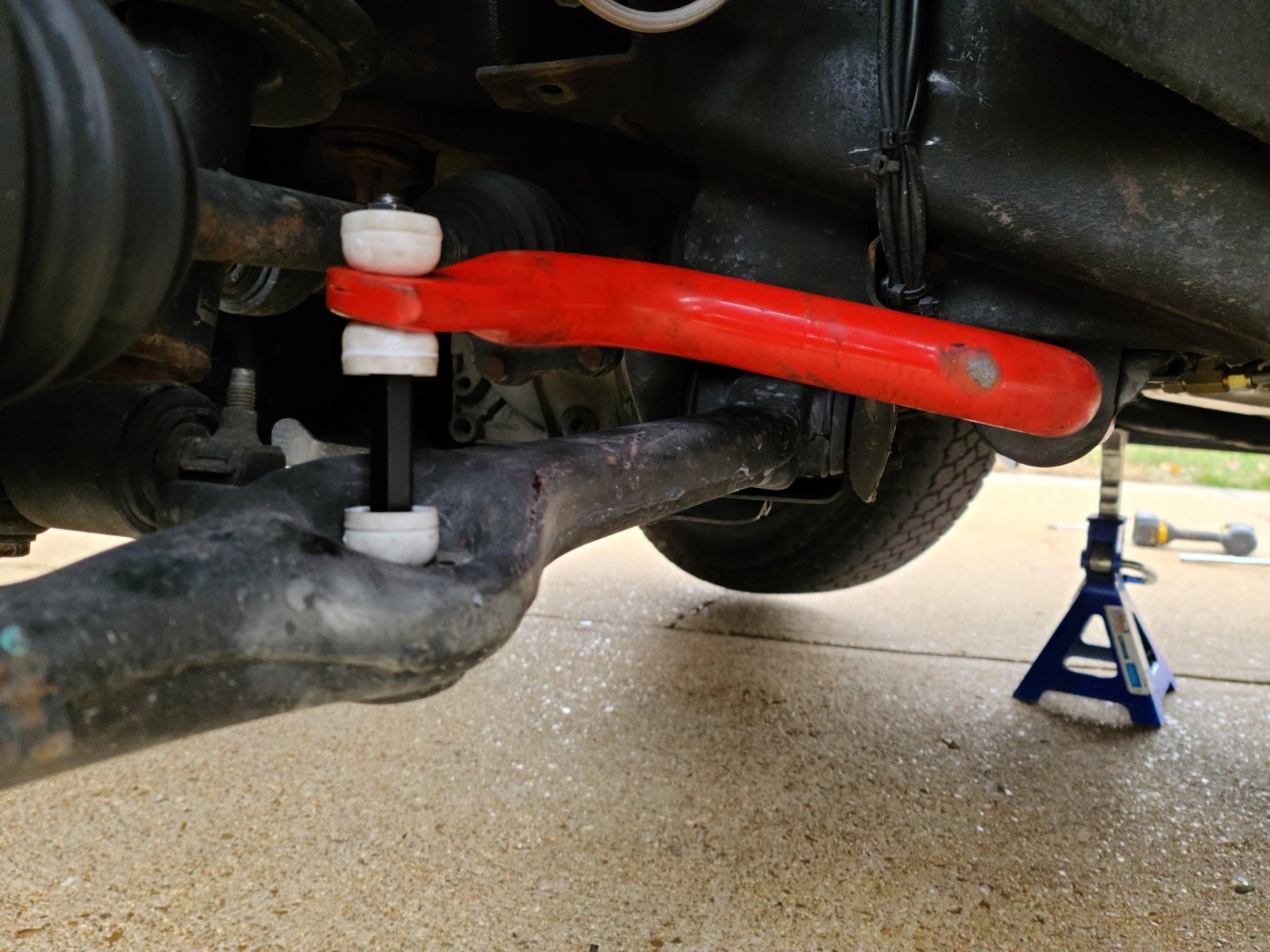

Hellwig sway bars installed. For the front end links, I used OEM links. For the rear, Hellwig supplied adjustable end links.
Front:
Rear:
I hope that you find these photos helpful.
These are incredible sway bars, and will virtually eliminate any roll in the truck. I purchased the Hellwig sway bars at the recommendation of @MO VietVet and his initial assessment of their performance was spot on.

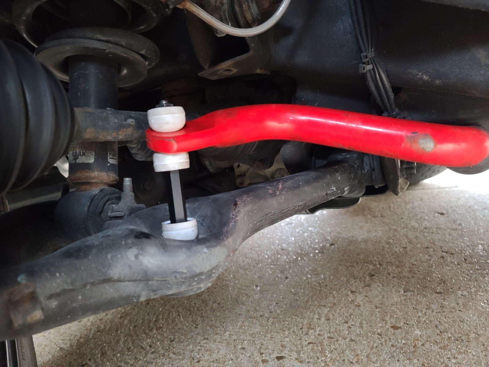

Well reason wby im asking this is becauze i have Eibach swaybars. I have 4dw denali with 2/4 drop, drop spindles up front and spring drop on rear. My eibach front swaybar doesnt sitts flet when car is on thhe ground or up in air. Thats with shorten Moog seay bar end lnks. With oem or non moded end links its evsn more crooked. Looks like your Hellwig sitts flat compared to end links
Here is two pics of mine. 1st pics up in air 2nd on the ground

Yeah, with a lowered truck, it's unlikely that you're going to get those front bars sitting horizontal, unless you shorten the end links even more.
The nice thing about the adjustable rear end links, is that you can pretty much make the rear sway bar level in most situations.
