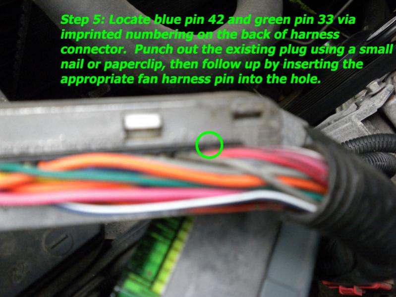

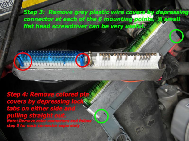

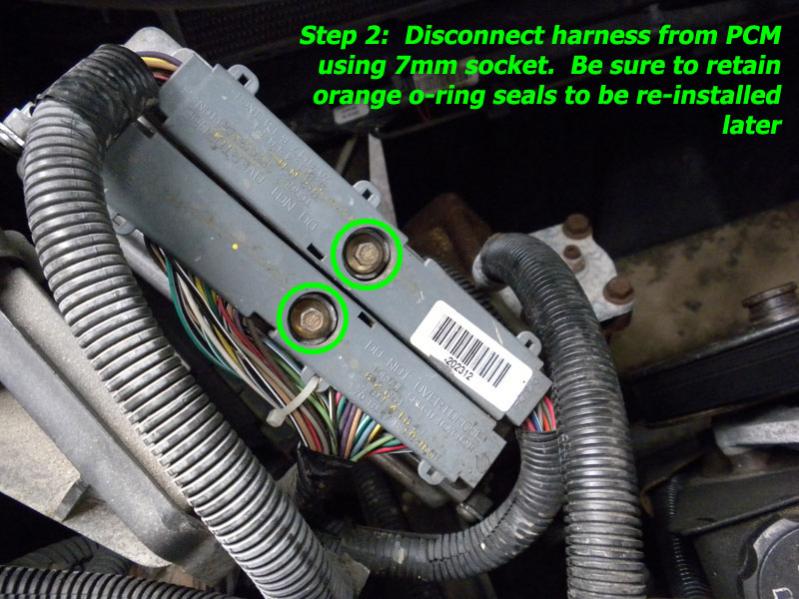

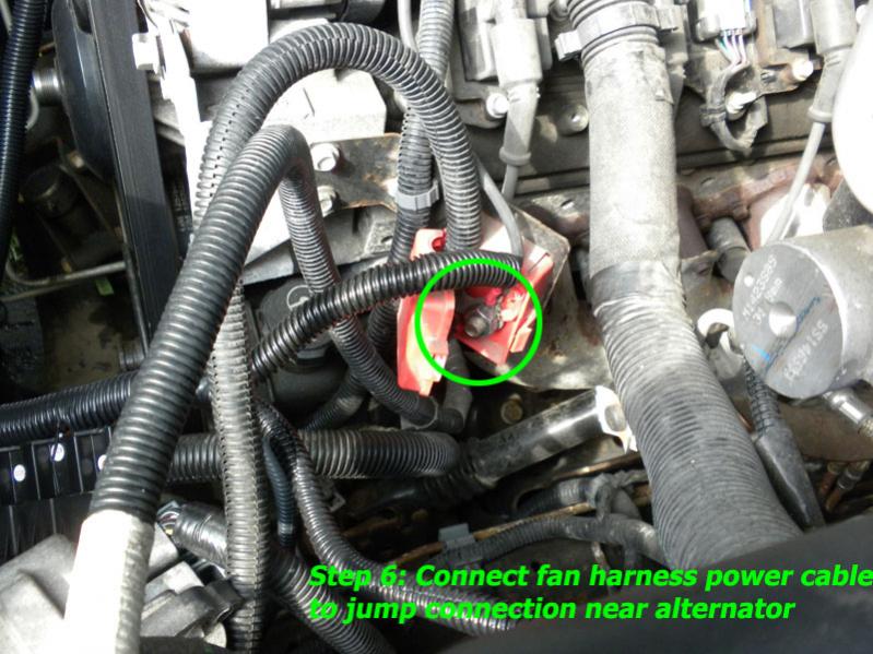

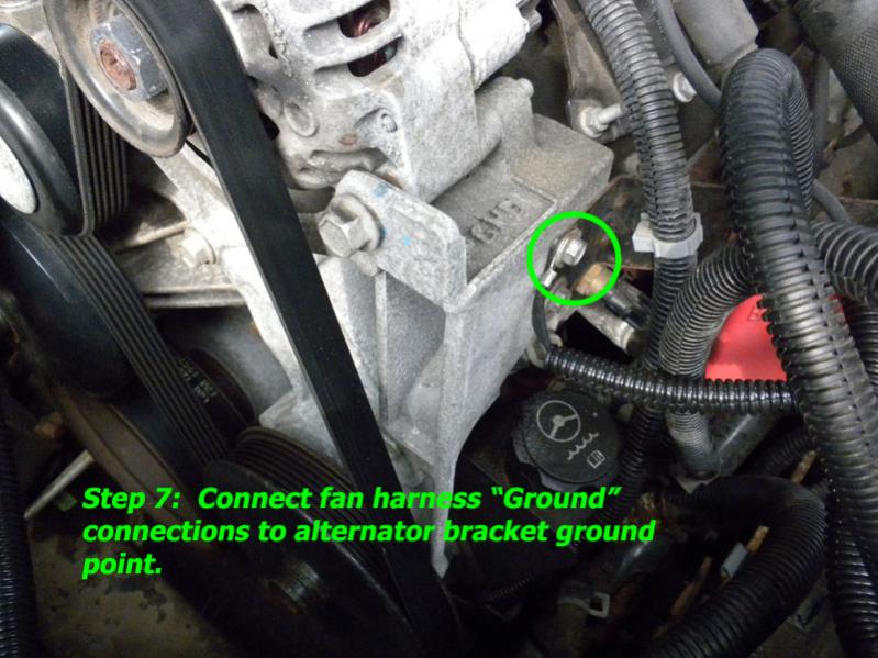

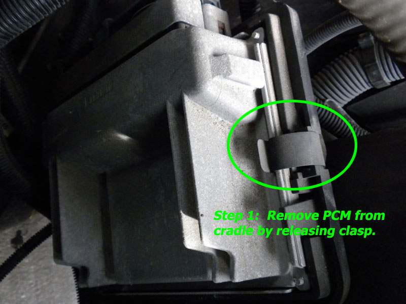

thanks guys, I found them on a laptop, its nice when you have more than one computer with your email address on them

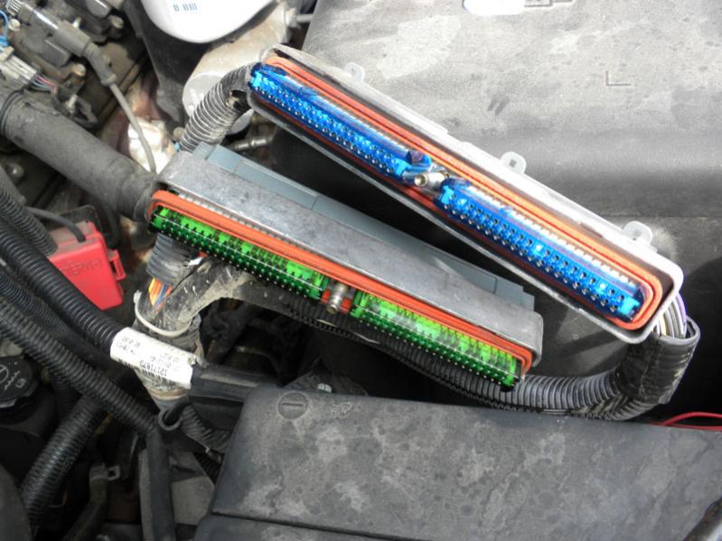

after you did the install did you get a tune to turn on the fan pins in you pcm? i can get the fans for $125 and want to do this as well but dont want to do it if i have to get it tuned right after i install them so they work. also i was told i might need a bigger alternator and a smaller pulley?

check out blackbear, they have everything you need, basically it'll cost you like $320 + the fans
$200 tune
$120 for the harness and pully.
if you can get the fans for only $125, that's an amazing price, take em and run, or buy them and ship them to me :)

ok so i do need the pulley, cool. yea im getting them saturday, hopefully i can get the stock wiring too, he said it has it. do i have to do the tune immediately before i can drive it?

you have to have it tuned before or during the fan install, otherwise you'll be running with no fans, and that, does not generally end well.
