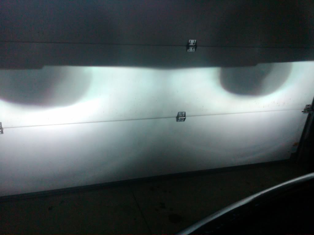

so anybody have an idea as to why i'm getting this beam pattern? It wasn't till i removed the material to make the bulbs sit in there right and now i have this
I have that same pattern w/ the stock lights in it.

Thats kinda weird .. why would there be a dead spot in the center ??

because the projector assembly is not made for an HID bulb. The HID bulb is several millimeters longer than a 9005/9006 halogen bulb. When you drill out the receptacle to make it fit, the light produced is now at a different focal point... remember playing with magnafying glasses as a kid, you had to focus the sun beam to a point to burn anything, same concept applies here. The hid bulb is now closer to the projector optic and the optic cannot focus the beam, WaLa - you get a dead spot

What I found is that if the projector assy low beam is not a D1S or a D2s style bulb, IT IS NOT MADE FOR HID.
Some of us have gotten lucky by installing HID's in halogen projectors, but it is pure luck, your projector is a few millimeters deeper or your 9004/05/06 bulb is a few millimeters shorter, something about your setup worked allowing your optics to work.
