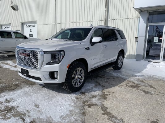

Spoke w/ my dealer today, they double checked w/ the Techs and the Service Info. Was told I can run 20's using the stock 20" tire size (275/60R20) with no issues, as long as I keep the 28mm Offset so it clears the caliper. So, my Winter Tire Plan may be to go to the 20's. Which is good, because there seem to be many more winter tire options in the 275/60R20 size than the 275/50R22. Also, lots more 20" takeoffs available out there from Sierra and Silverados than 22's.
Picked up a set of 20x9, 28mm offset takeoffs from a Silverado last evening, mounted one on my Denali, cleared the caliper so that part is good. Must admit, didn't lower the vehicle off the jack to check for any interference w/ compressed suspension parts, but didn't seem like it was going to be an issue.

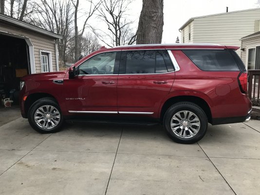

Yep, to each their own. Personally 20’s look hideous on these rigs. What an eye sore.
This is what I see when not on 22’s. Looking like Mario Kart. Different strokes for different folks…
Well, you must have bad vision. Actually the 275/60R20 tires are 0.2" larger in diameter than the 275/50R22's. So, the wheel well is more full w/ the 20" than the 22", it is just filled w/ Rubber instead of metal.
