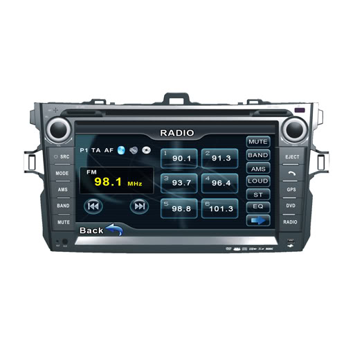

There are some 8" Navigation units that fit into double DIN slots but with a bigger front. Any chance of squeezing one into an 2001-2006 Yukon?
bryanfeelsgood
Jun 30, 2009
99
Portland, OR
My guess is no, but there is some room to play with between a standard double din nav unit and the fascia plastic, so the only way to know would be a test fit.
Also, judging by the size of that monster, you'll need to cut out the plastic pieces in the back of the head unit cavity.
RickyFriery97
May 5, 2011
88
what are you looking to spend on those units? theres alot of aftermarket double din headunits with nav that will fit
only diffrence is most of em are 7"
RickyFriery97
May 5, 2011
88
my pioneer with a 7" screen was a pain in the ass to retrofit..you would have quite a bit of work im guessing
for tahoes 06 and up im pretty sure they make double din kits so it would be simple to put a double din in a 06 and up model
for your year model they didnt thats why you had to custom fit it

well 99-02 is single din, then 03 and up is double...I still think it may be hard to make a 8" fit even in the 03-06, but i may be wrong..
