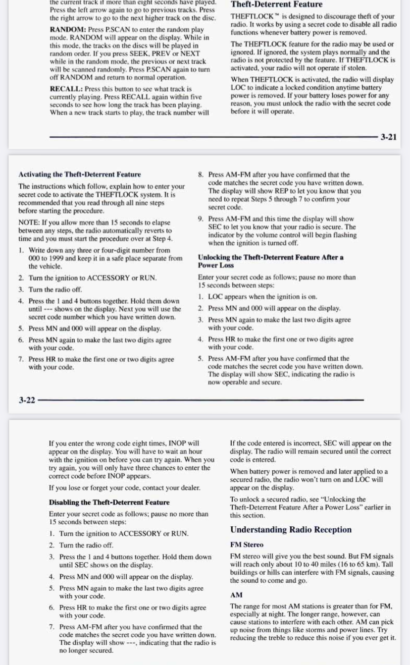

If I am not mistaken, some models of your vehicle have what is called Theft-Lock where if you disconnect your battery, you need to punch in a code through the radio.
Ideally you would have gotten the code from your vehicle prior to disconnecting your battery, but that’s not what it sounds like the case is. You will probably need to get a code from your dealer or from GM directly. You didn’t mention the make model or year of your vehicle so I’m just guessing. Here is a portion of the manual for my 1997 K1500 Chevy truck that discusses TheftLock.

That's just to prevent theft of the radio. Or, more accurately, use of the stolen radio once installed into another car. It doesn't lock down the whole vehicle.
Randall, do you have a key fob (keyless entry remote) for your truck?

Thanks for the clarification on that.
