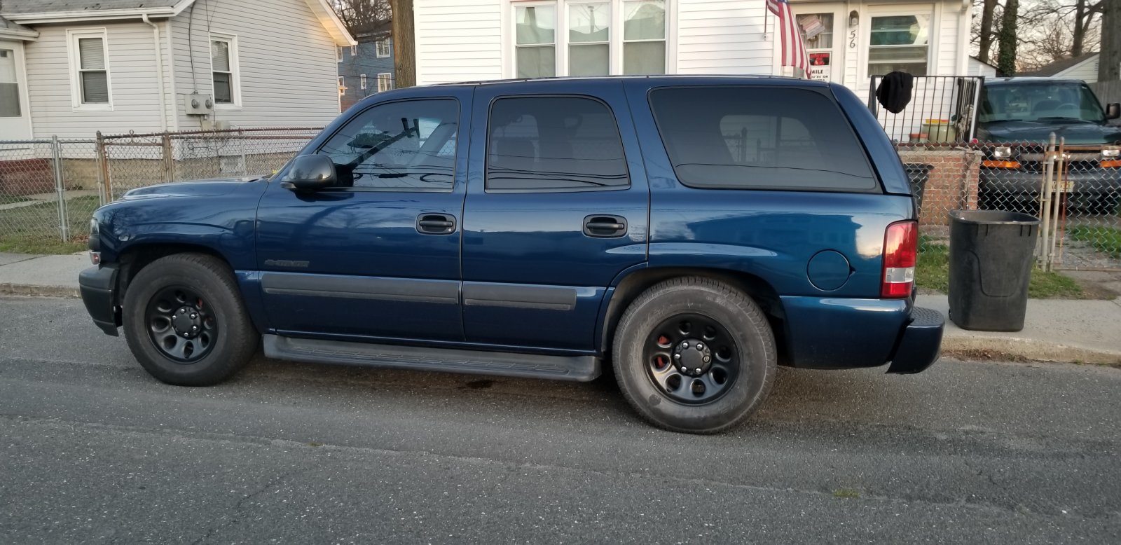

Just to give you an idea. I went with a 2/3" drop myself. 20210406_191118.jpg
I'm also running 265/70's on mine. I have Bilstein 4600's on all 4 corners, no air ride at all. It originally had the ZW7 Nivomat suspension. I used torsion keys to lower the front, along with lowering springs and shock relocation brackets in the rear. It rides ok, the rear bangs hitting a big bump or a deep impression in the road. I don't have the rear bump stop mode. If I had to do it again, I'd go with lowering spindles for the front. Overall I'm happy with the look and ride, but I also never tow with it. Imo it handles much better and sure footed. I also have front and rear Hellwig sway bars.

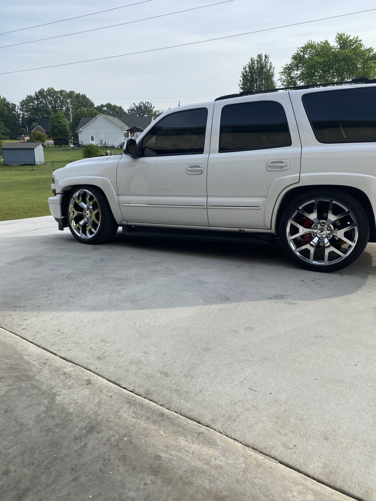

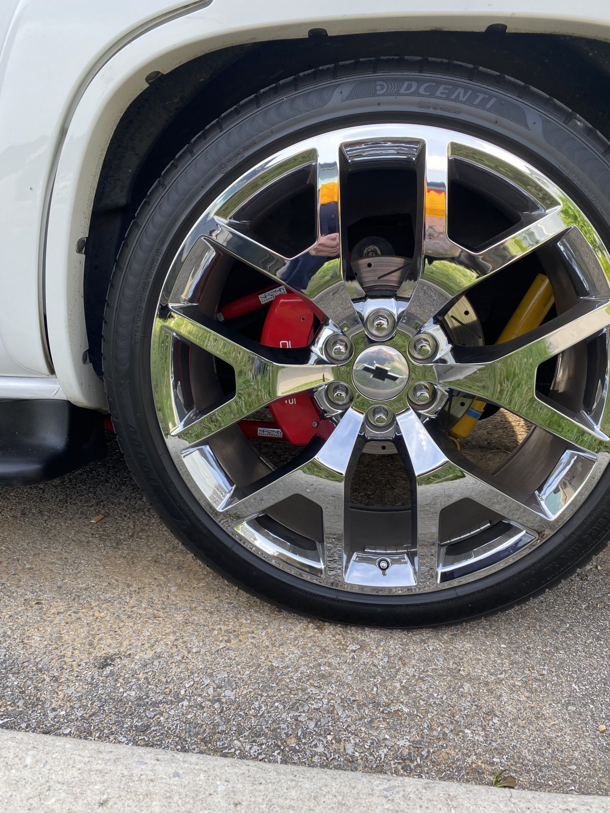

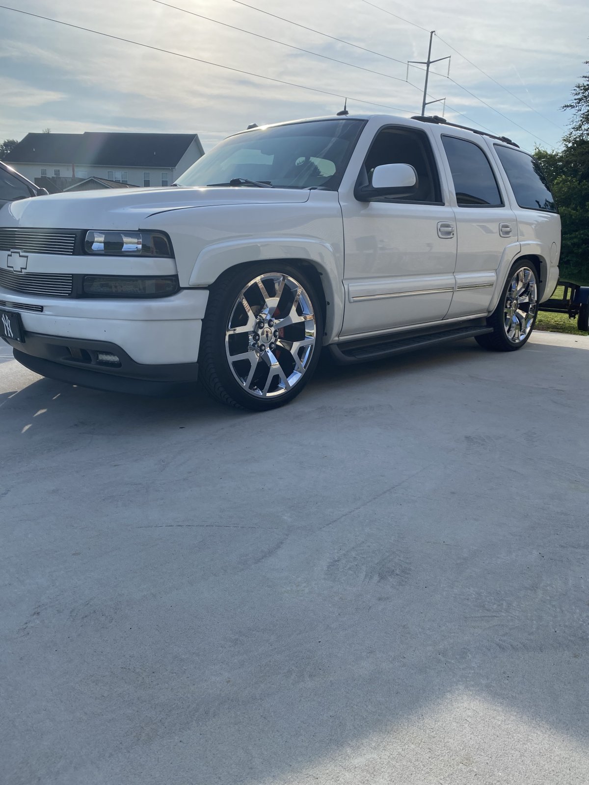

Here’s my 3/5. Mcgaughys spindles which are awesome. Belltech 5305 with half coil cut. Spohn Panhard Spohn upper an lower control arms. Did have bilstein shocks now have belltech sp. 3/4 ton purple keys. Rides pretty good.
