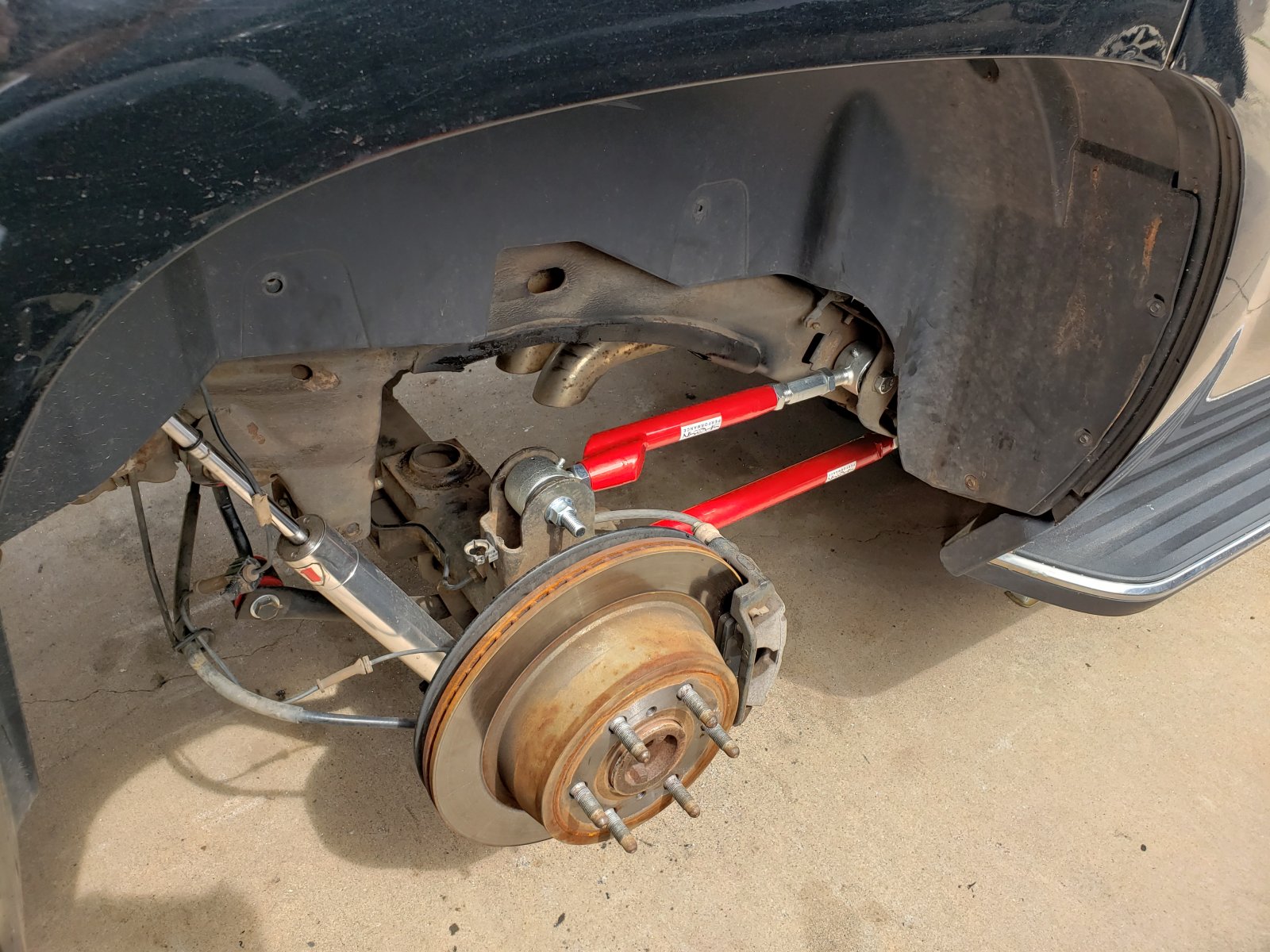

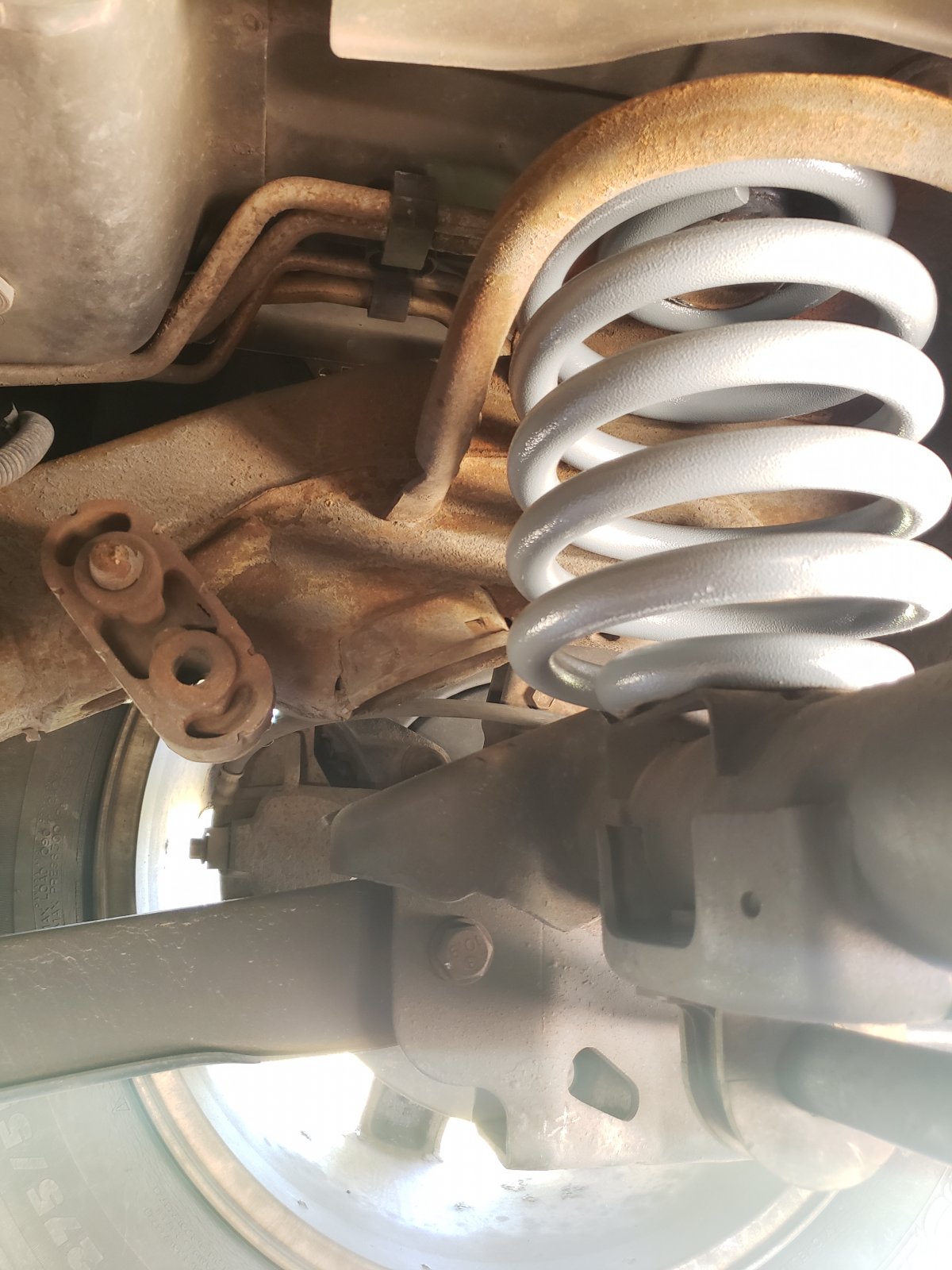

Spohn started shipping things again a couple weeks ago, got the uppers, lowers, and panhard bar in that I ordered back in April. Belltech 1.25" bumpstops and the Free Travel mod as you guys call it, or the Sawzall mod as I call it haha. Oh and gave the QA1s one click back down since I have a little more travel room now.

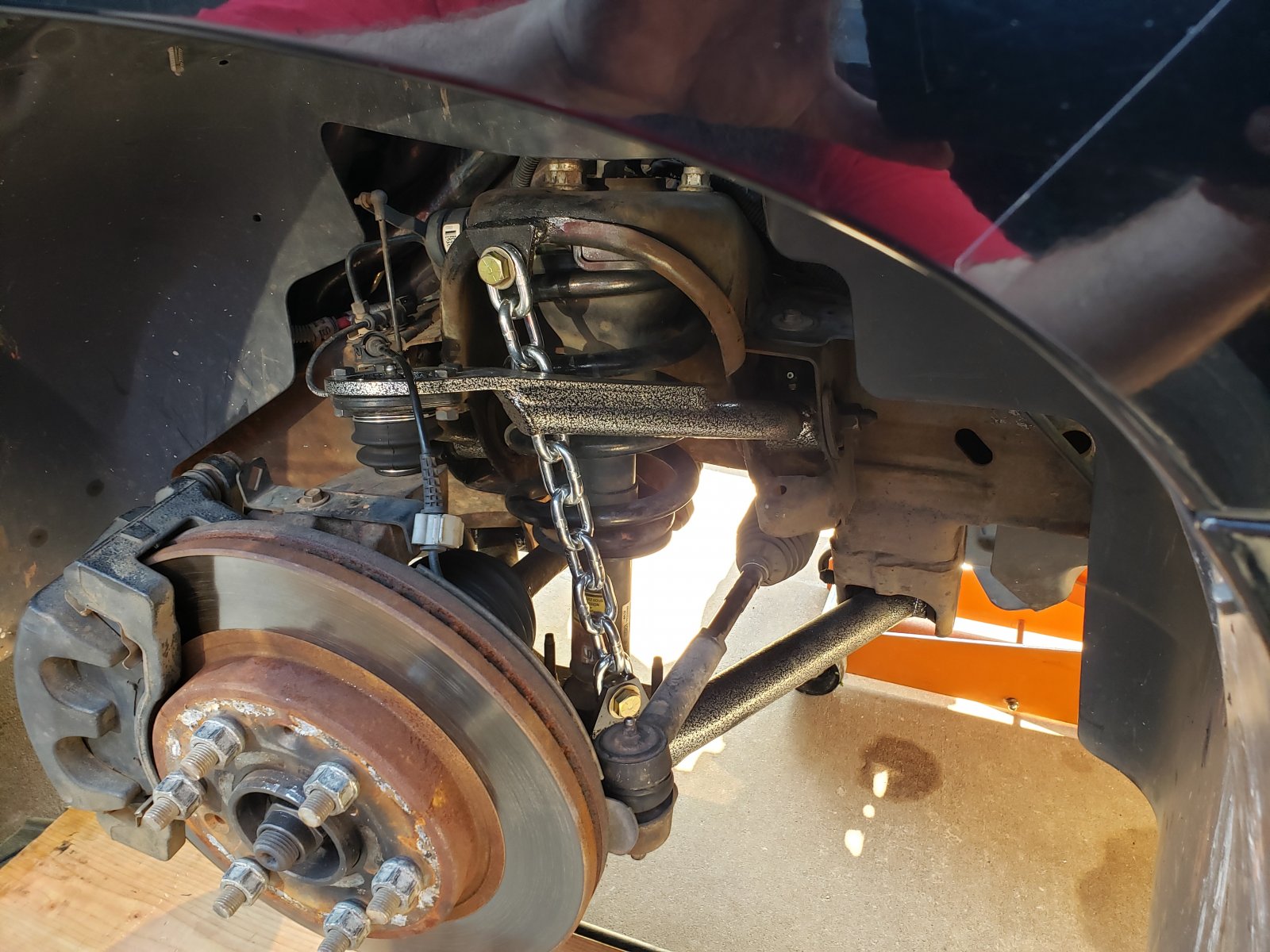

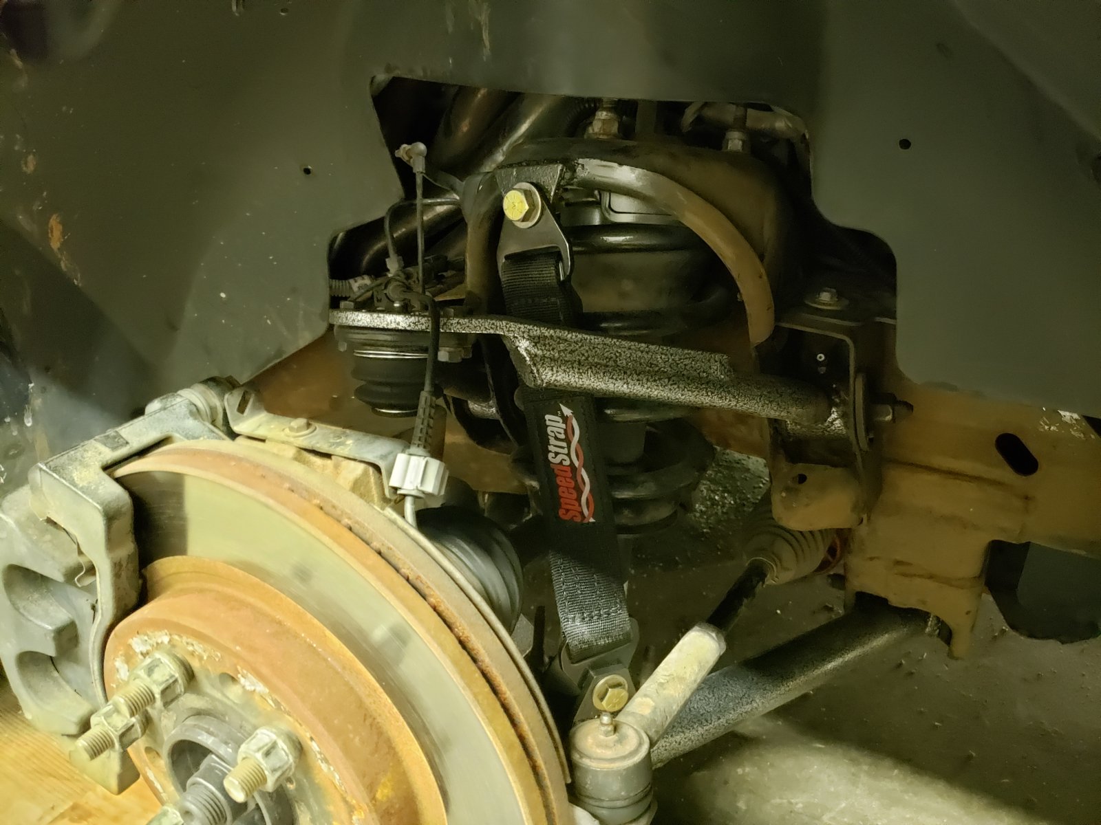

I originally had mounted straps, but they just stretched too much and I knew they wouldn't work the way I would ask them to so I decided to get some chain. I lucked out on the length and didn't have to fab anything else up or make any adjustments. With the chains bolted on there is about 1/4"-3/8" preload on the struts.
After installing and dialing in all the suspension I have the truck launching with zero front end lift and the rear squats ever so slightly and then stays there without rebounding, I can feel it wanting to rip. However now that everything is set up correctly and the way it should be, the converter is just too low of an rpm to be usable, and is actually probably so tight that it's hurting instead of just being "eh, could use something different".

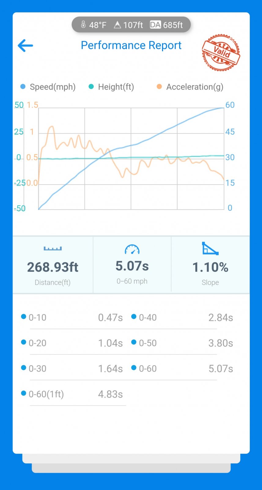

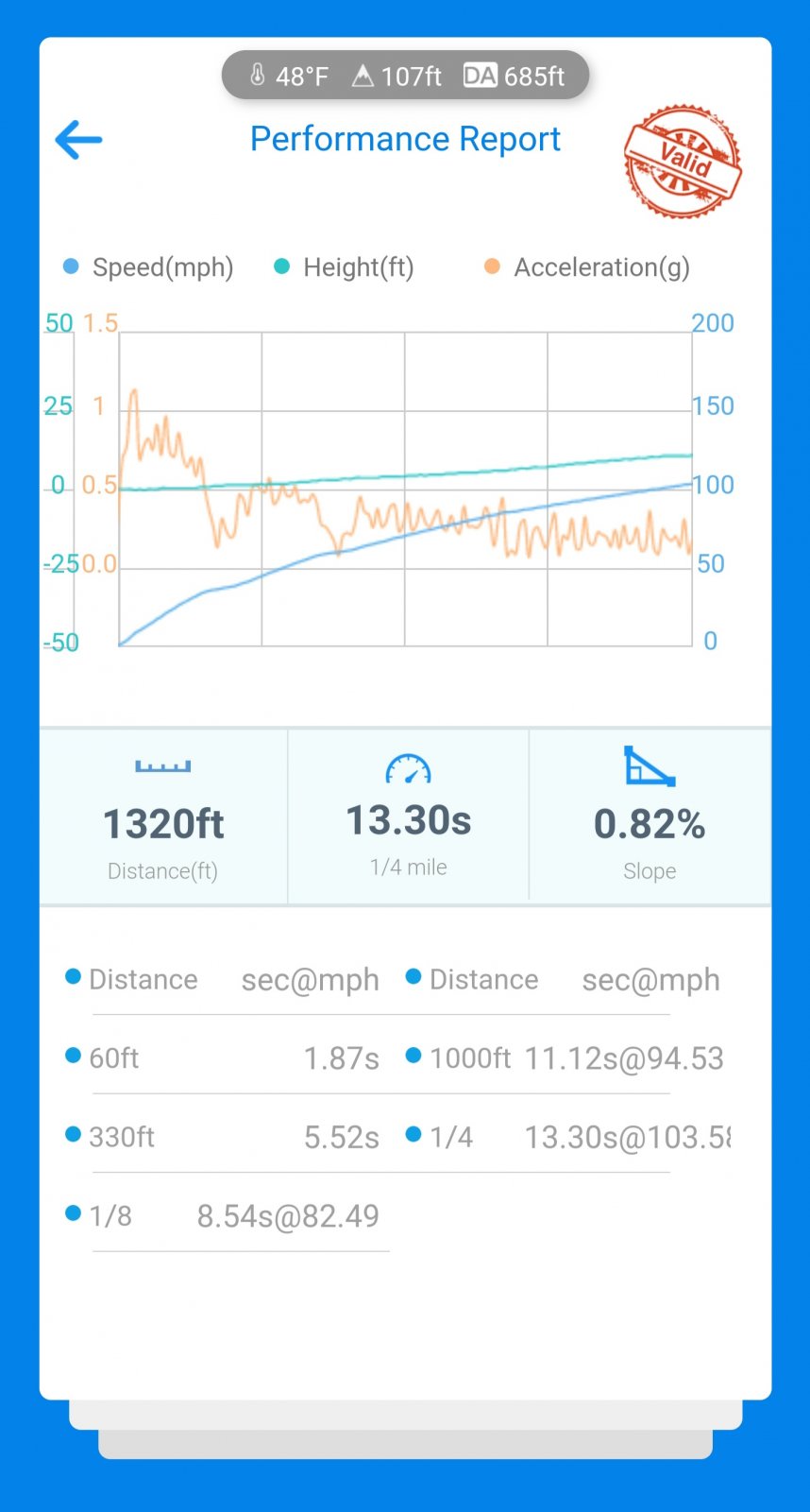

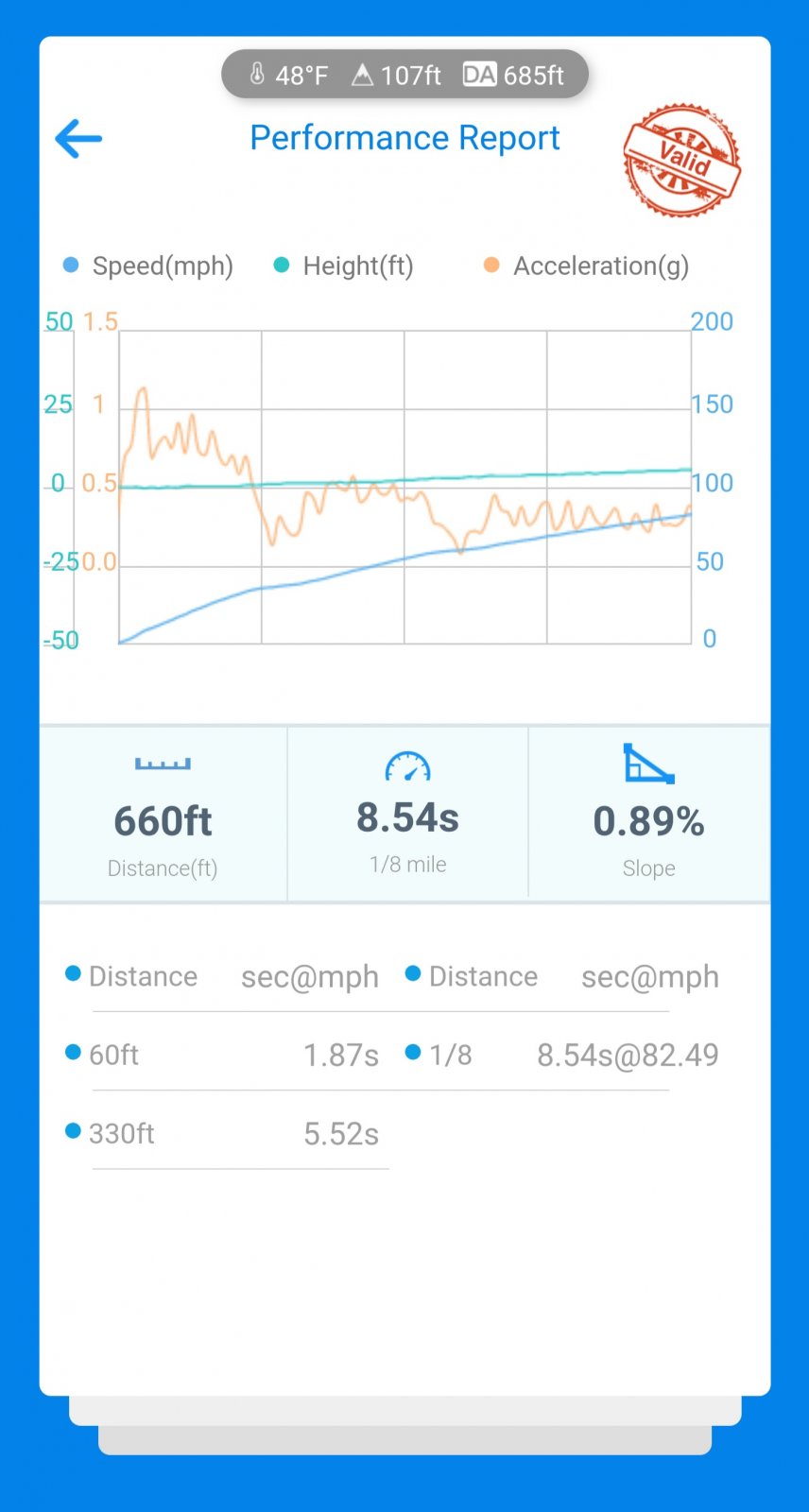

So last night/early this morning I took the quick 15 minute drive to the same road in Mexico I visited earlier this year. Back in May it went 13.37@105mph, 8.63@81mph with a 2.09 60' and 844'DA. That was on stock suspension, stock gears, without front straps.
Since then I've worked over the suspension, chained the front, and installed 4.11s front and rear. At the end of last month it went 8.70@80mph with a 1.905 60' but at 3712'DA.
Picking up nearly .2 to the 60' and only losing 0.07 to the 1/8 with a 2800' change in elevation had me excited to see what it would do last night now that the air was right around what it was in May. I would be able to more accurately compare how much improvement these changes made, so out I went.
The 13.37 run was back in May, the other three were last night.
To make a long story short, I need to get to the track and make a few passes to see how it likes to be launched, and see what's going on with the trans. It has a pretty good hesitation before the shift, and the shift itself feels slow. Previously, and you can see it on the 13.37@105mph G plot, it used to be nice and crisp.
However, one of my goals with this Yukon was a sub 1.90 60' on the street. I know it can go 1.70s, but I reached my goal for now. Im also really happy with the 8.54, but those shifts are killing me.
For a 5700lb N/A suv, I'm not disappointed. I'll have a different converter in it by the end of the year and that should pick up 60' and 330' enough to make the difference I need. The mph for a 12.99 or better is there, we'll see what happens.
TL : DR. Aside from 0-60, new PB's all around. Still have some work to do.
1.87 60'
4.83 0-60 (It's been 4.81)
5.52 330'
8.54@82 1/8
13.30@103 (It's been 105)

View attachment 258935 View attachment 258936 View attachment 258938 View attachment 258939
It’s this data from an app? Or a track data device?
Chert_Detective
Chert_Detective
May 4, 2017
158
438
It's a GPS logger called Dragy. Pretty cool little thing. Dead accurate at the track too. I'm an hour away from my local track, so it's nice to be able to see different ET breaks, MPH, and acceleration data without having to make the drive.
