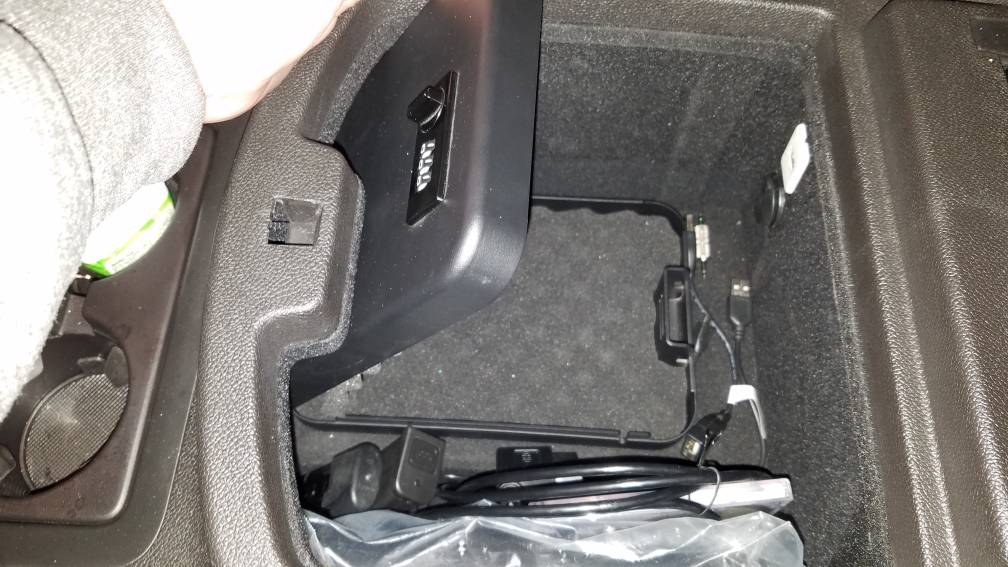

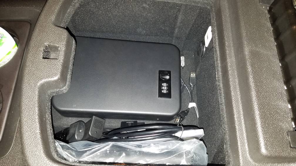

I use a Bulldog model I picked up at Cabelas a few years ago for about $25. I also have a Gunvault NV300 combination lock box I use in another vehicle and the box is almost identical to the Bulldog.
I added a couple pics in my post above

I can get a pic of it later this evening.
Basically it's one of those approx. 10"x6"x2" thick boxes placed with the hinge at the front of the console and combo or key towards the 12v outlet and usb port in the rear. I have it about a 1/2" from the passenger side wall and have it forward enough from the rear so I could use the outlet or usb and still open it enough to place my CCW or wallet, or whatever into. When I open the lid it will eventually stop opening when it touches the front lip of the console opening, about at a 45 degree angle.
To mark the 2 screw locations, I just loosened the screws a bit so the heads were sticking up a bit over the screw recesses in the console floor and rubbed chalk on them. I then placed the box where I wanted it and made sure it contacted the screw heads to leave marks for drilling.
I drilled the holes a bit bigger so I had a little wiggle room to position it exactly where I wanted before tightening it down. I used a couple fender washers in the screw recesses in the console floor to make them the same level as the floor, and also used a fender washer under each screw head inside the lock box. The foam or felt inside the lock box covers them.
Oh, and I used about a 1/2" longer automotive interior screws to make up for the depth of the recess the screws go into.
EDITED TO ADD PICSView attachment 323517View attachment 323518
