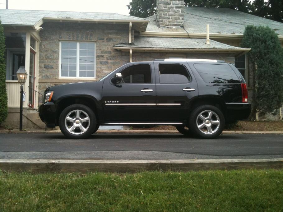

I just installed the ReadyLift front-only kit. You can adjust it (upon installing) to give you 1", 1.5", or 2" of front lift. I set it to give 1" of lift, and the truck is perfect. No need for anything in the rear.

I was, frankly, tired of screwing around with Autoride links, thinking my truck was cali-leaning with just the rear dropped, and then had to replace a strut which may or may not have had anything to do with lowering the front... And, I don't think that the spindles-route is for me (don't want to get that involved in the front end)... But after having the truck in totally stock, front looking too low and the rear looking too high form, I knew I had to do something to level the truck. So, I had the front raised an inch.
The ReadyLift spacers mount atop the struts. I could have gone with a bottom-mount spacer, but these looked hearty and secure and the way for me to go. And they're adjustable, so that was key. I didn't want to go higher than an inch in the front, and these let me raise it only 1". Nothing needed to be done to the Autoride, either. The ride feels like stock because it is (you're moving the whole strut, essentially, and not changing the stroke of the shock).
I think it looks awesome. I'm really happy with it.
Here's a link: http://www.readylift.com/c-45-chevy-avalanche-1500-2007-2011-2wd-4wd-6-lug-adj-10-15.aspx

Here's a quick-'n'-dirty pic:

HA! That's what happens when you read an exciting post about a potential new future mod.. you forget how to spell WHOA... anyways I want this... and your truck looks GREAT! :Handshake:
The reason I never pulled the trigger on the 2" rear drop is specifically bc of the AutoRide issue with adjusting the links. It was disconcerning to read/hear and I didn't want to go through all that. Plus my main pain point is that it is not LEVELED. I could care less if it is dropped or raised... I just hate the 'Rake' look. Also how did you got it installed... shop your in your driveway? thanks again kmel!

I didn't do the install myself. Paid a shop I use often to do it. I think it took the mechanic 1-1.5 hour(s). His words were along the line of "it's no big deal."
It's a relatively expensive mod, maybe, but the look is dramatic. It just adds that little bit of space in the front wheel wells to make the truck look as it SHOULD look.
And, again, absolutely no messing with Autoride links.
I think you've read my posts on the matter, but I think these trucks were designed to have SOME rake (again, the rear handles are higher than the fronts, the back windows are on a different plane than the front windows, etc.), but the factory rake set up is an eyesore. There is still a hair of rake with only a 1" front lift, but to me it looks perfect. The lines of the truck still work (they look better, really), but the difference in wheel gaps is night and day.
If your goal is to be level, and you don't "need" to drop the truck, then I think this is the ticket.
