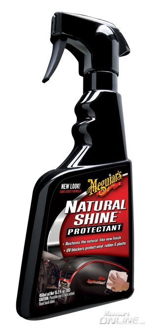

I got an old kitchen sponge/ scrubber pad, put some interior dressing on the scrubber side of it, and then scrubbed that area of the seal. No further issues.

I'm having this same issue with the back door noise. I rubbed the weather stripping with WD-40, which helped for a while but then it came back. Plus my truck smelled like a garage for a couple of days. I think I'll try Eagle's technique. If it doesn't work, I could still use the Meguiars somewhere else in the truck.

I went sort of Eagles route but I used tire dressing on mine, hasn't made a sound since, and the back doors get opened a lot by the kids. I was sick of it and tried everything, the tire dressing worked perfect.
