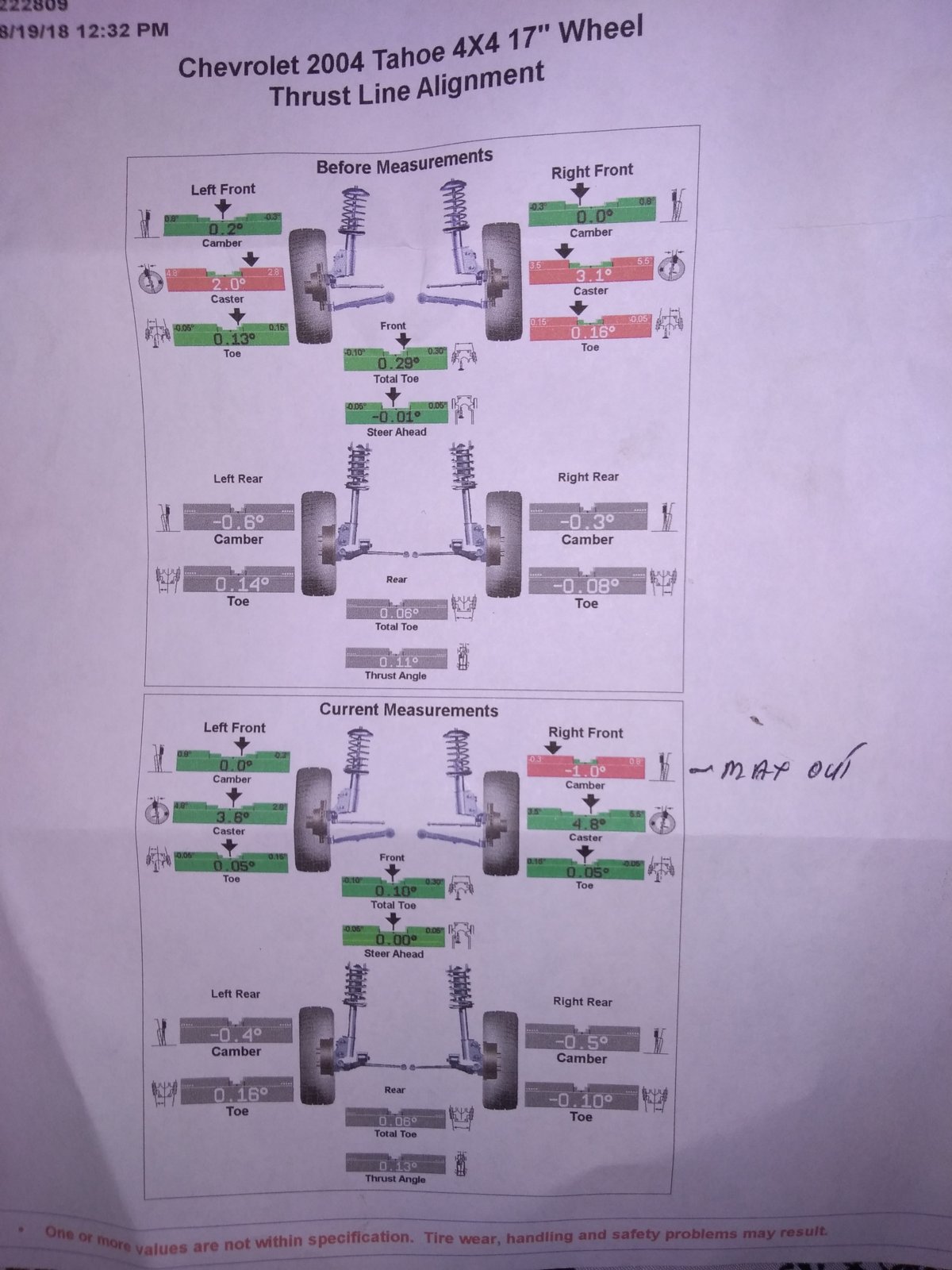

Here is what the alignment looked like after it was done, the guy said the adjuster was maxed out in that side, the thing I don't understand is if both sides have to be equally adjusted because the driver side cam plate has more room to be adjusted but the passenger side is maxed, that or it moved and it isn't the same place anymore as when I drove out of the shop. if anybody has an idea of how this works could clear that up, that would be awesome.

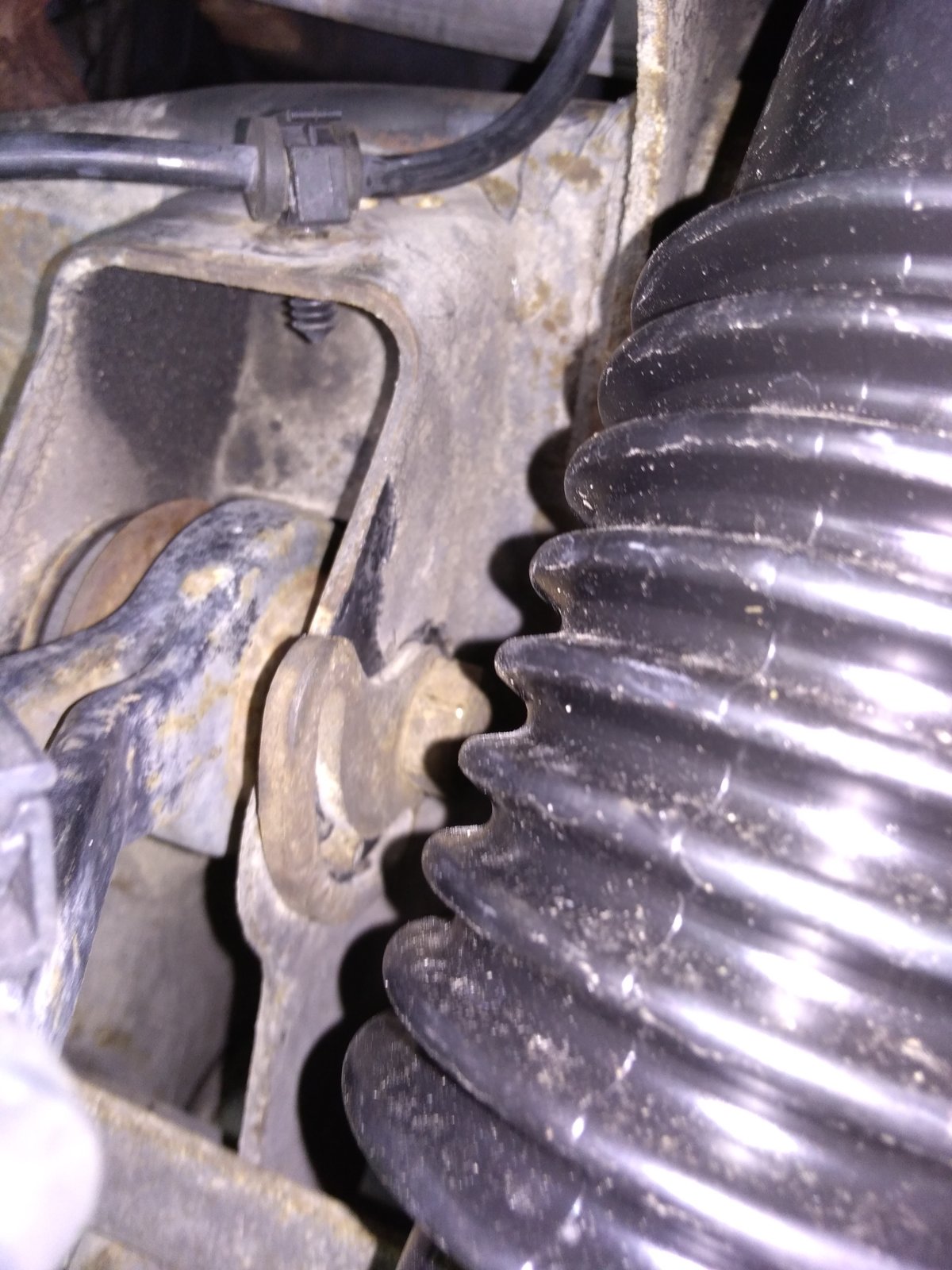

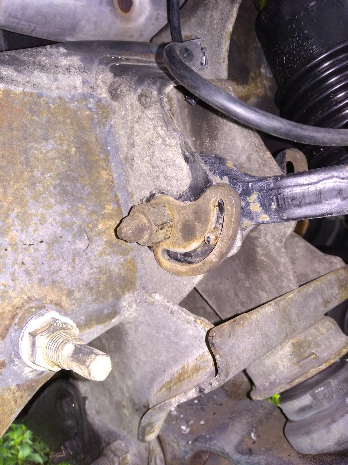

Update: made some time to check things out and guess what I found, the passenger caster bolt was loose, I was able to move the nut with a 3 and a half inch long rachet, that was enough to tell me it wasn't even close to torque spec, literally as I moved to tighten, both! Cams just moved, now I can only imagine what stress these go through with the speed and momentum during an aggressive U-turn with a truck weighing over 5k pounds. Twice I've gone to the alignment shop and told them about this, and idk if they are just being lazy or what, but they are just wasting my time, I will take it somewhere else. I might as well do the bushings beforehand they don't look bad, but just in case.

Anyway you can give this place bad online reviews? I can't even imagine how many people they do this to. And if they don't want to make it right with you--after spending your hard earned cash, they don't deserve to get other customers to screw over.
