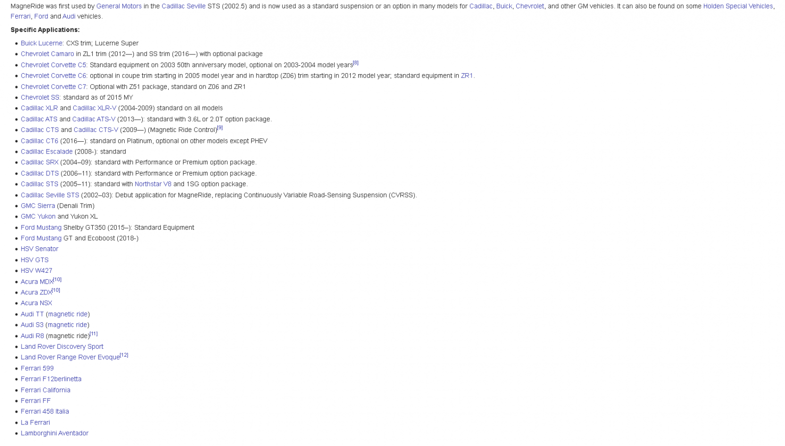

Z95 Magnetic Ride Control - Mangeride electronics shocks and strusts all around.

Z55: Autoride automatic load-leveling suspension system, using computer-controlled shocks and struts that adjust to road conditions •
Z71: Conventional monotube shocks that can be replaced with aftermarket monotube units •
Z95: MagneRide magnetorheological damper system, utilizing magnetically controlled shocks and struts •

it's magnetic ride control, it's just not the "good" magnetic ride control, z95 has some special fluid in it so it works slightly better.

My 2015 LTZ had the MRC at all 4 corners. The rear rode like a dump truck.
I have installed Xineering's GM Shock Sims MRC delete sensors at all 4 corners and gone to a complete passive suspension setup. Using Fox up front and Bilstein in back.
I have my truck leveled up with a 1" spacer in the rear; HOWEVER, when I did the new rear shocks and spacer I also purchased and installed a NEW set of the z71 rear coil springs.
The owner of Xineering is using his own MRC delete on his Tahoe and using the Monroe passive replacements. Basically when you use his MRC delete sensors you can then install ANY rear shock that would fit a TAHOE LT trim. Up front you can replace the ENTIRE strut assembly and install a new coilover that fits any TAHOE LT trim. The MRC delete kits using brackets and rod extensions only "tricks" the computer and does NOT allow you to run different shocks on LTZ or Denalis.
