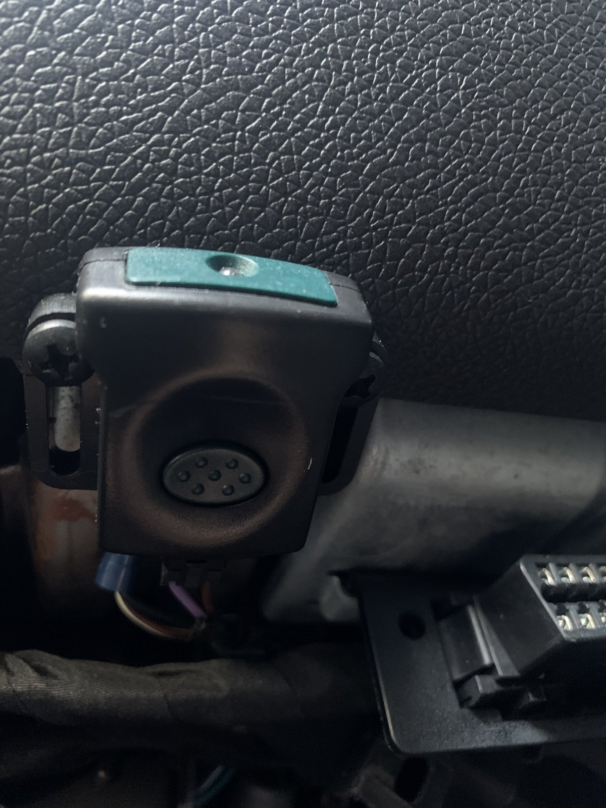

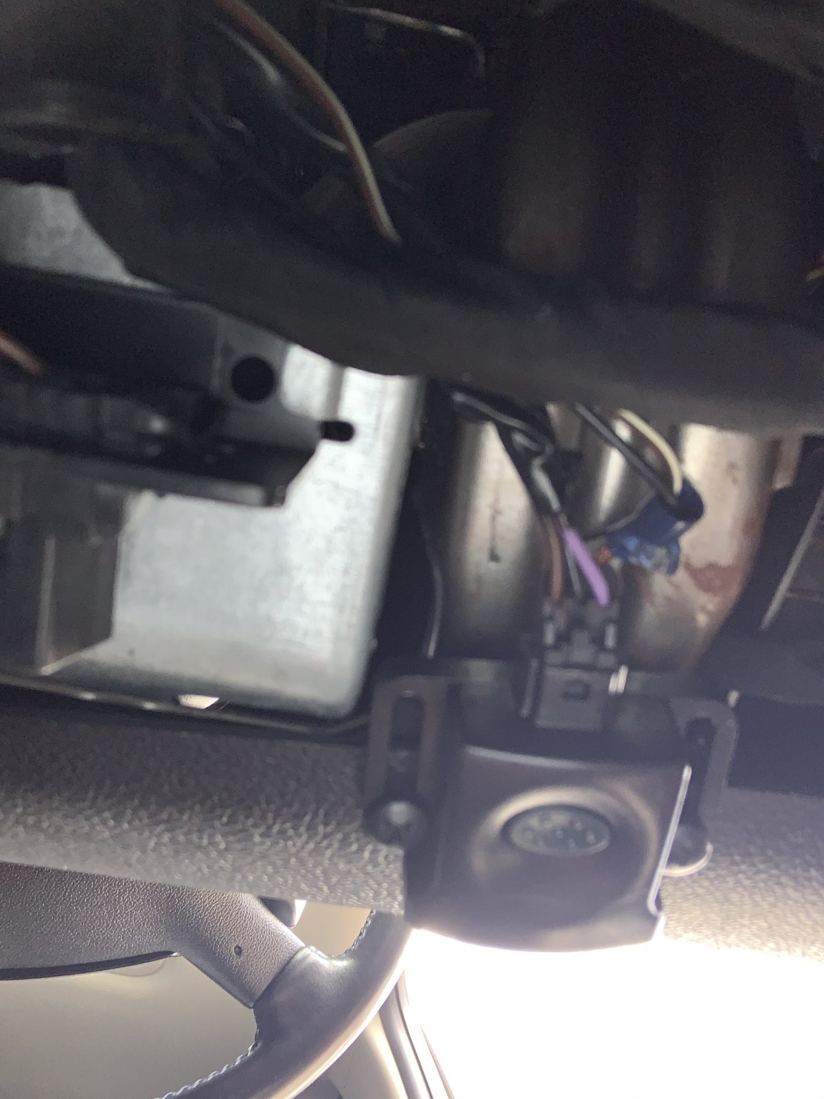

I looked for the shock and tilt sensors and couldn’t locate anything that looked like anything..., but what is this? It’s screwed just under the dash driver side. The blinky green light is visible to the driver. I never noticed it before. Maybe my alarm isn’t OE?

That thing is not OE or a GM Accessory. Trace the wires back and see if they go into 3 different plugs (LT Blue, Pink, Gray) into the BCM and one to the IP Body Relay Block. That would be your clue that this is an aftermarket alarm integrated into your computer system.

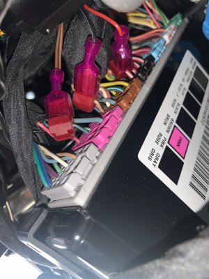

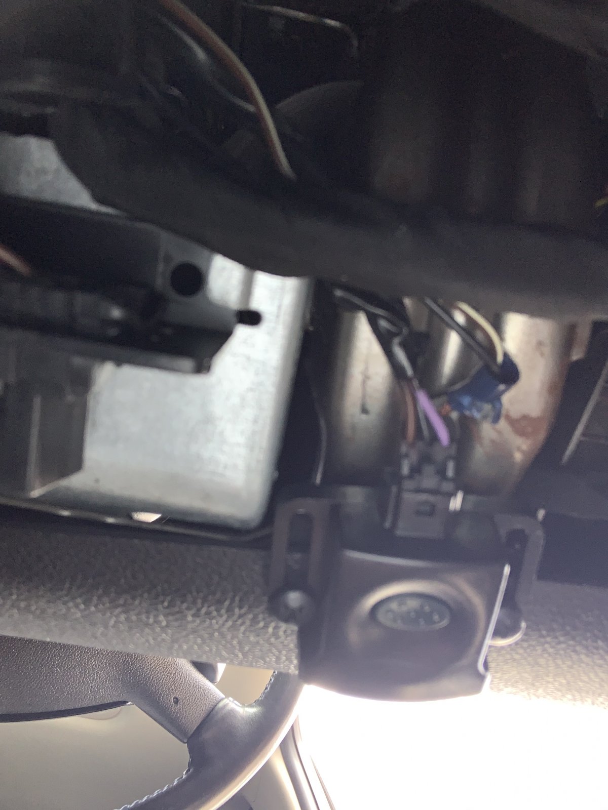

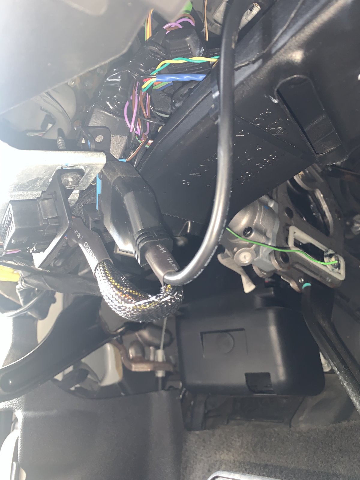

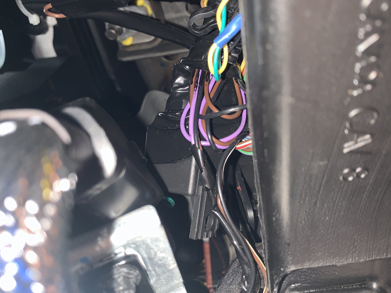

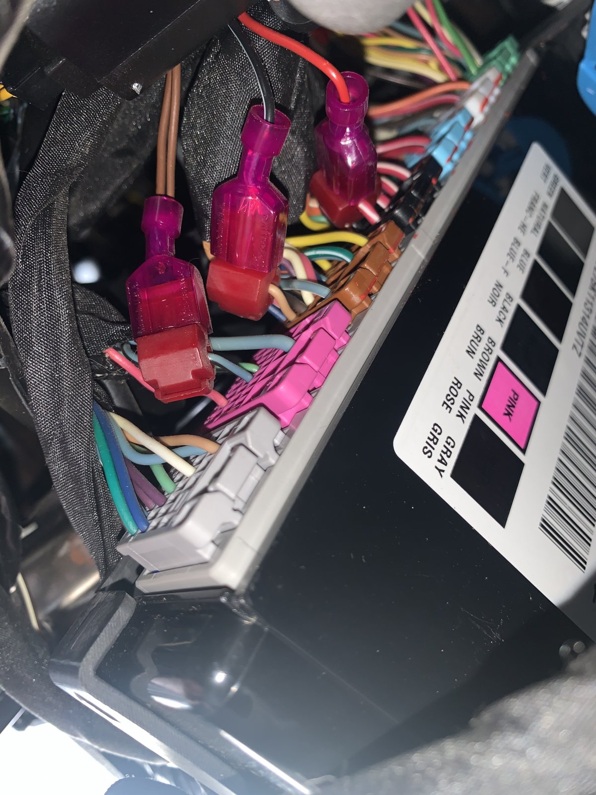

I traced the wires back...it’s a bit of a mess to me. That device has a purple and solid brown that seem to hit a relay with a bunch of excess wire taped then I’m not sure where. I added a few photos as have no idea what I’m looking at (first GM vehicle I’ve ever owned). Looks like there’s definitely some aftermarket stuff spliced in and whatever is going on with the OBDII pug is also confusing to me.
Could you please recommend a Tech-2? I quickly get overwhelmed and confused at all the options out there when I look online. Thanks.

Up here to the right
Aftermarket alarm and thats a t for the obd port..... almost like a used cardealer uses to cut vehicles power if payment not made....
