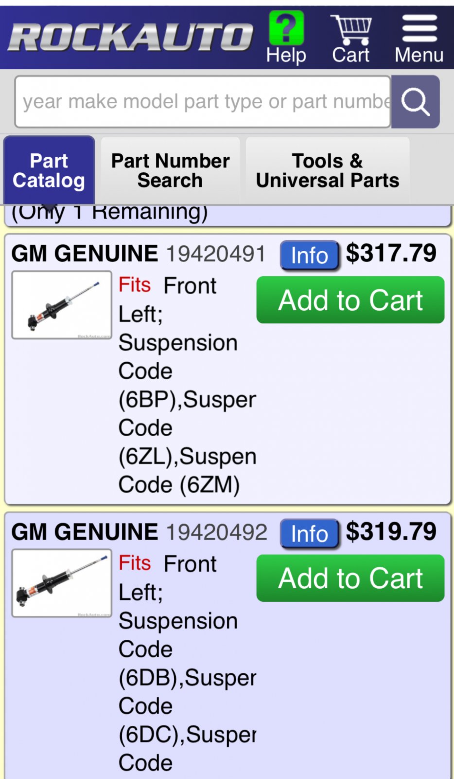

Yes, that’s for 2009+ z95 / Magneride. You’re Susp control module (software) doesn’t control the valves on that or the mag fluid.
R/A has the correct struts, for less, plus a 5% discount code. An Indi shop can install the z55 in 90 min. It’s one of these two…
Your vehicle has z55 suspension. z95 was not available until 2009, if that helps and … only if you had a hybrid Yukon Denali or Escalade.
Parts Geek will take your incorrect struts back but only if you let them know they’re bouncy and inform them the packaging appeared as though it was damaged or dropped.
R/A has the correct struts, for less, plus a 5% discount code. It’s one of these two…
You’ve only got to do it right once. In its current state your vehicle will not drive faster than 86 mph for safety until you bypass the safety system with resistors or replace the z55
Yes, that helps. Thank! I didn’t know about the yr Z95 came out. I do have the FlexFuel version of the Tahoe.
I did purchase a 2yr service contract, but who wants to take all that off to return em. Ugh! Had I been equipped with the correct knowledge, I’d be doing this once. But, I am learning a lot here and hopefully the shop can correct things.

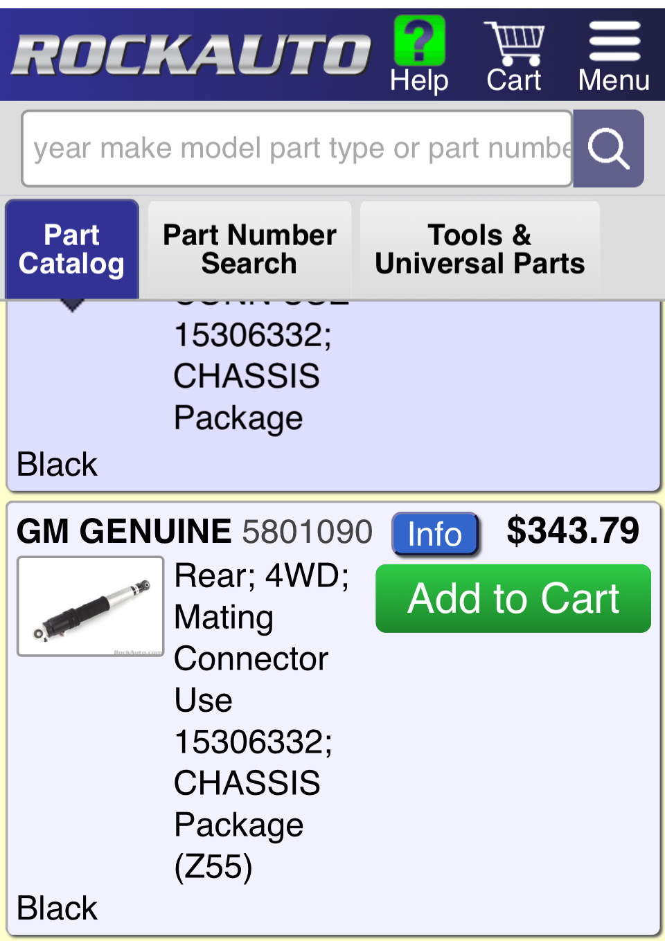

No biggie. Here’s the rear set up…

Hahaha …
Discount code page
If you have coverage for gaskets and seals be sure they replace leaky pan, steering rack and leaky coolant reservoir/ radiator before times up
Hahaha …
Discount code page
If you have coverage for gaskets and seals be sure they replace leaky pan, steering rack and leaky coolant reservoir/ radiator before times up.
