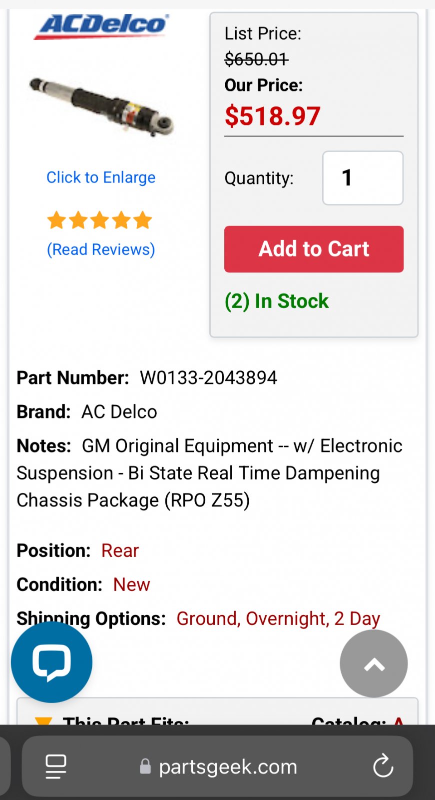

With all the facts, an Internet diagnosis is ez.
Only one brand shows applicable for 07 Tahoe with z55/autoride …
All the other options show for the rear, without z55, exc. z55 with RPO Code Z95 (MagneRide Suspension) or excluding z55.
The only option for TRQ shows as …
A Conversion kit made of subpar hydraulic shocks with resistors…
Or .., the actual AC Delco z55 replacements guaranteed for life.
All the other options are not applicable or incorrect. The TRQ conversion kit is already known to be inferior.
The subpar options currently available cause so many, so much grief & frustration as well as draining their wallet, it’s important to help others from duplicating the same process.

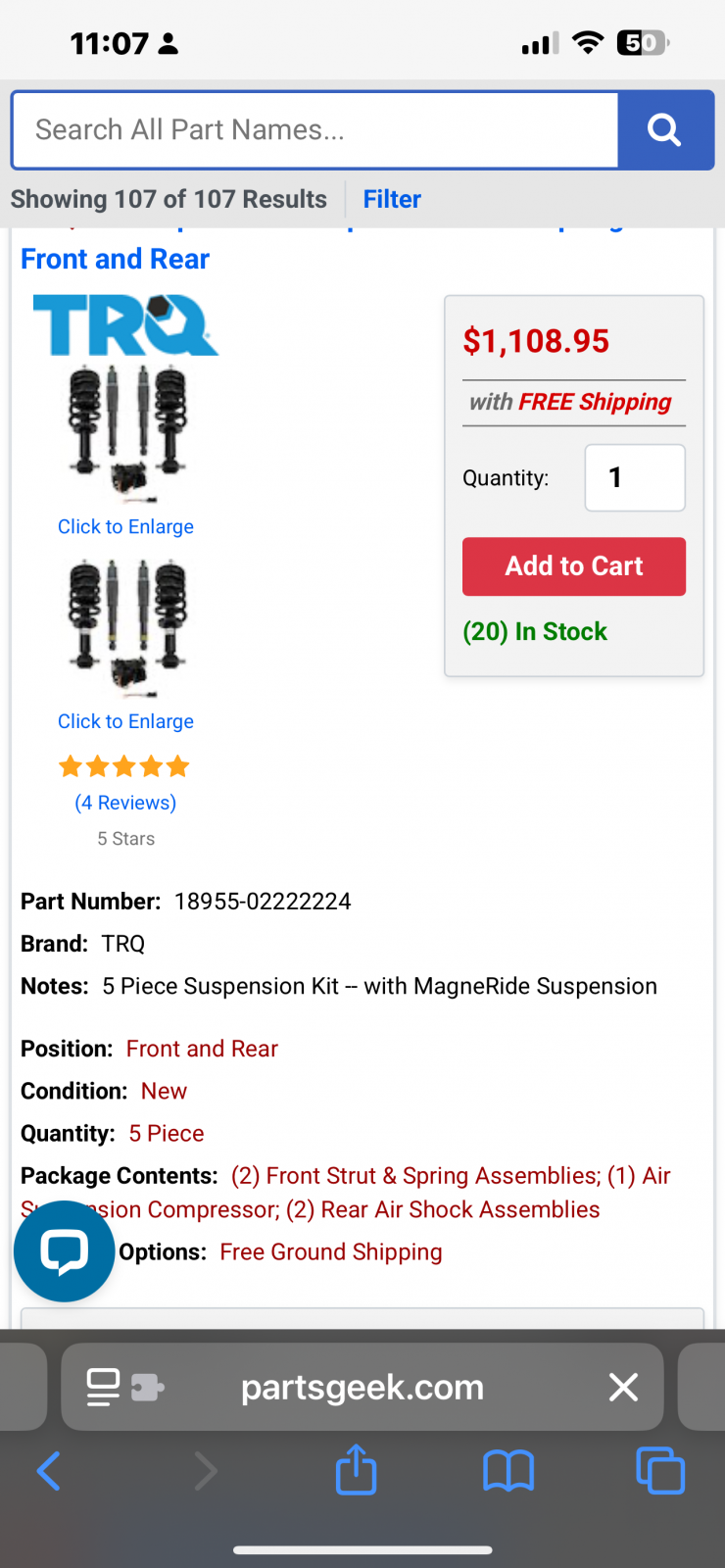

This is what i purchased

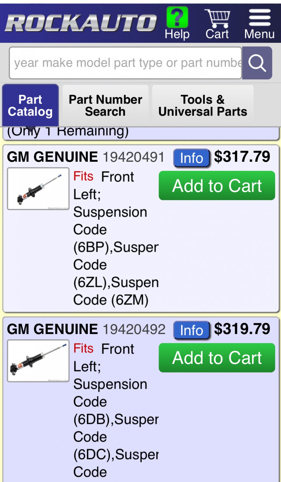

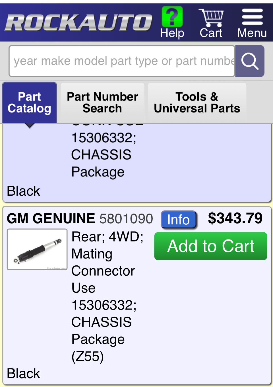

Yes, that’s for 2009+ z95 / Magneride. You’re Susp control module (software) doesn’t control the valves on that or the mag fluid.
R/A has the correct struts, for less, plus a 5% discount code. An Indi shop can install the z55 in 90 min. It’s one of these two…
Your vehicle has z55 suspension. z95 was not available until 2009, if that helps and … only if you had a hybrid Yukon Denali or Escalade.
Parts Geek will take your incorrect struts back but only if you let them know they’re bouncy and inform them the packaging appeared as though it was damaged or dropped.
You’ve only got to do it right once.
R/A has the correct struts, for less, plus a 5% discount code. It’s one of these two…
You’ve only got to do it right once. In its current state your vehicle will not drive faster than 86 mph for safety until you bypass the safety system with resistors or replace the z55

No biggie. Here’s the rear set up…
At least you didn’t wait until 190k to replace your struts like me.
The shop will gladly swap them out if your service contract covers the leaky rear main seal and motor mounts. It’s a huge labor job they’ll gladly take on.

@Scheme1 Get the proper shocks Z55 (electronic suspension system, not Magneride suspension system), and you will be good to go. Expensive mistake, but a learning experience. The RPO codes in your glove box are your friends in obtaining the proper parts.
