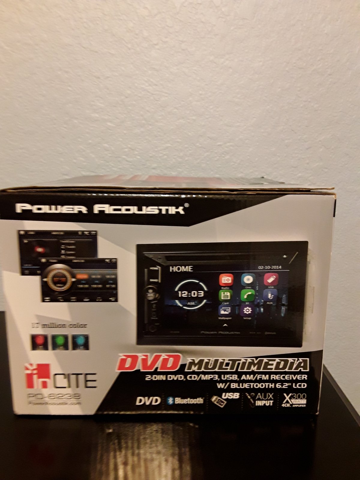

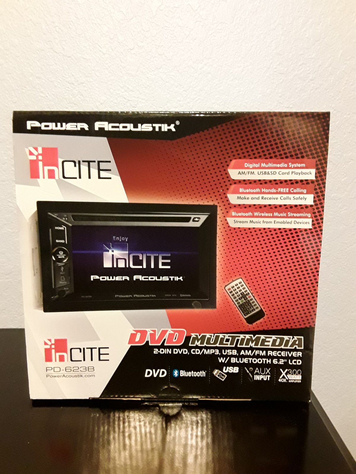

I'm using this head unit that I bought at best buy, it's not bad. My antenna reception is bad.20190705_193732.jpg 20190705_193800.jpg 20190705_193732.jpg20190705_193800.jpg

I'm using this head unit that I bought at best buy, it's not bad. My antenna reception is bad.View attachment 226430 View attachment 226431
Hope it works out! I contemplated buying one of the cheap Chinese radios with similar features to the top DD head units (for 200-300 bucks). That one is less than 100 bucks on Amazon, but it totes some really bad customer service and product reviews. With my luck I'll have all the issues, but hope it works for what you want.
