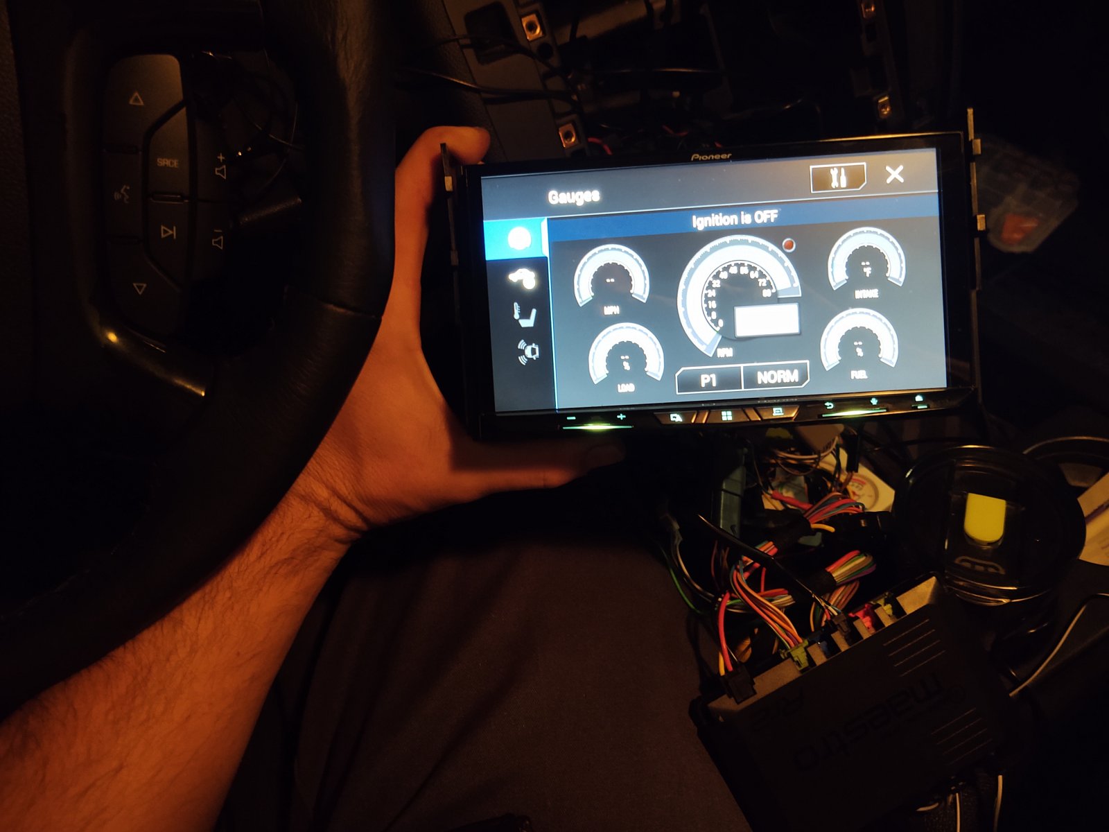

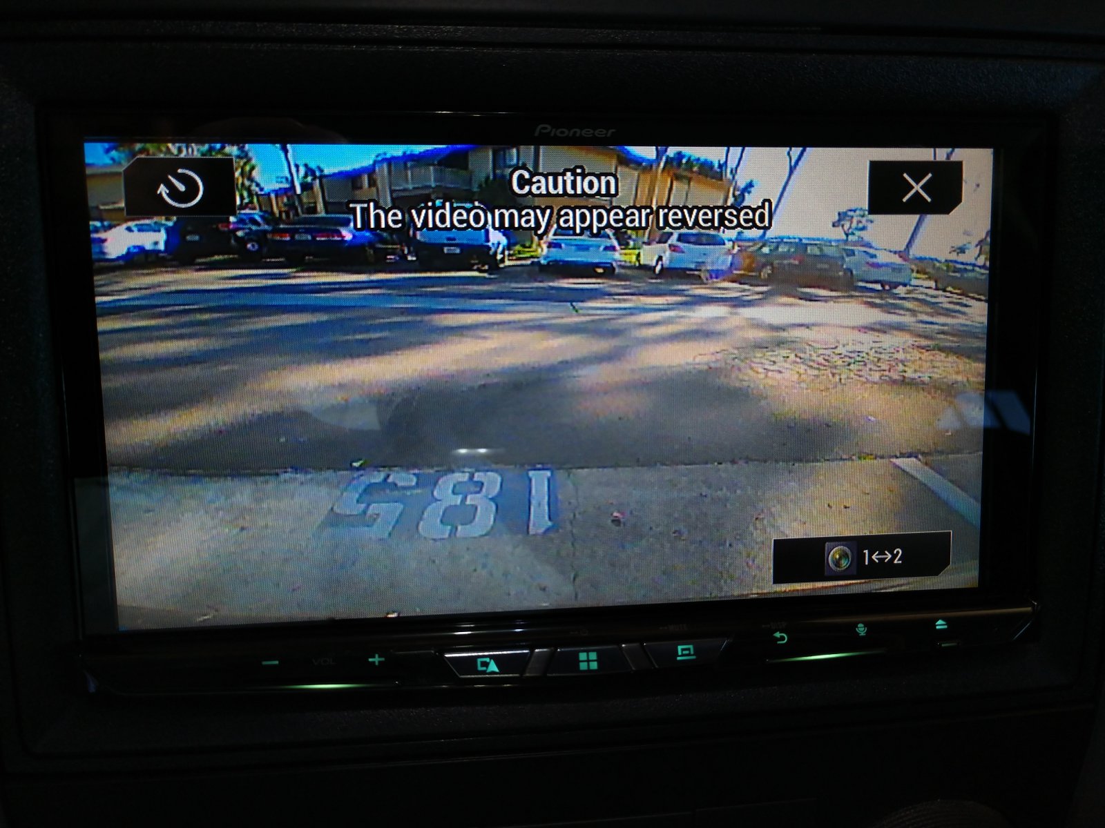

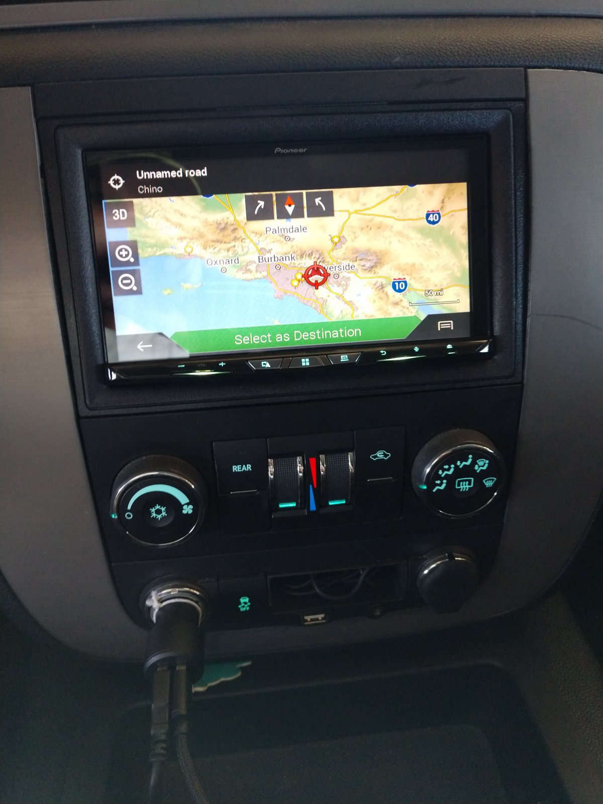

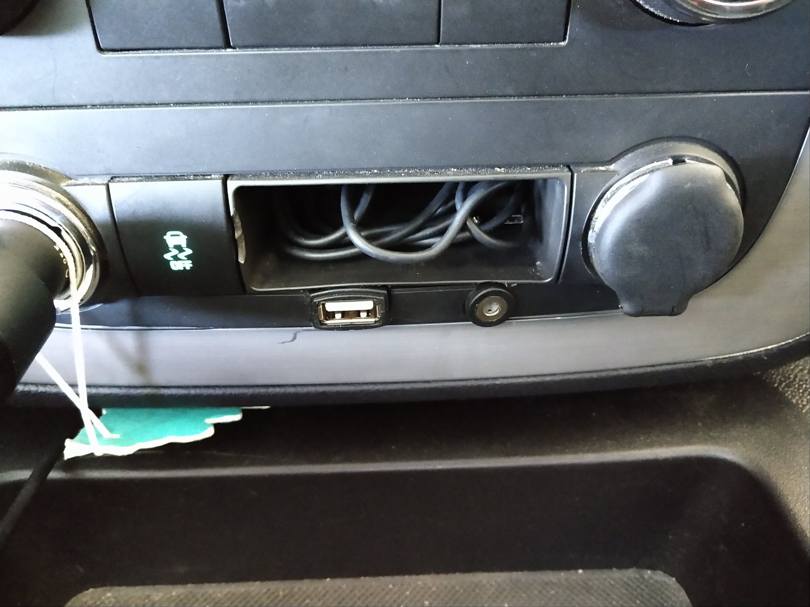

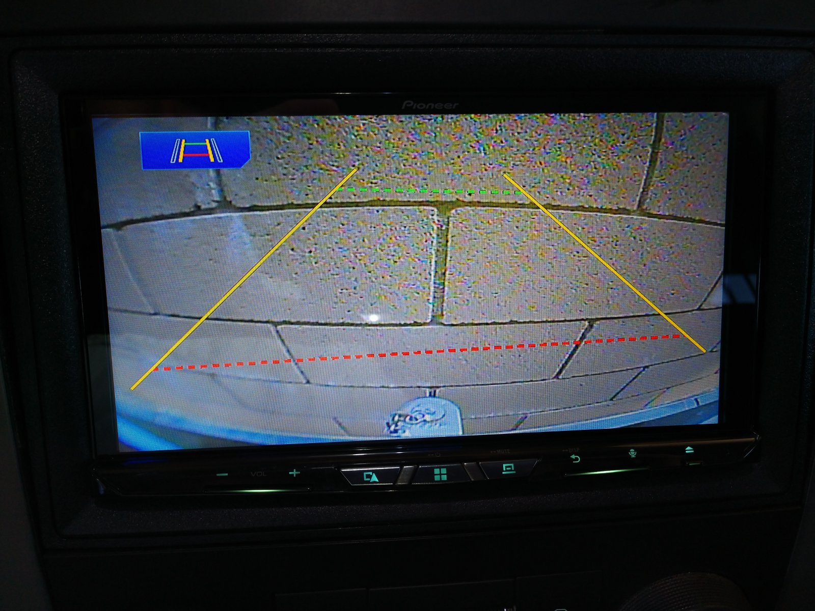

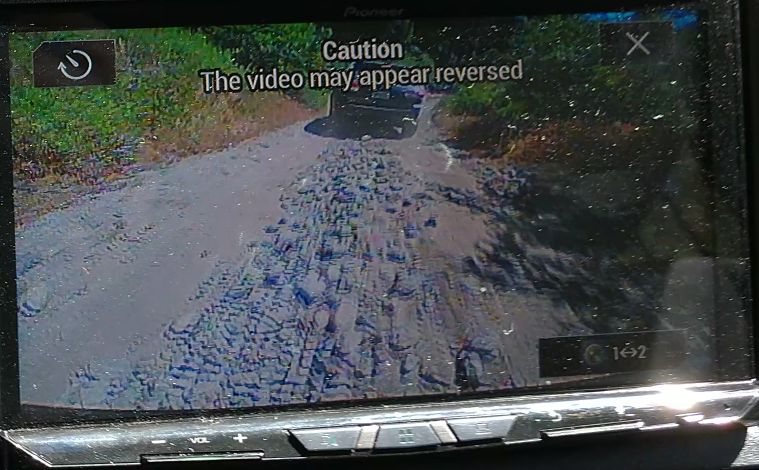

I just put in the Pioneer AVIC 8500 NEX. Installed front and rear cameras too.
Used the CarXtc install kit from amazon. works perfect. Their little adaptor box has a volume control for door chimes(it uses an internal speaker).

Adding backup/rear view camera capability would be about the only reason I'd replace the OEM head unit. That's nice.

Did you buy anything else besides the head unit and this kit (besides the cameras)? Steering wheel controls work?
Just the head unit, install kit, and cameras. The only controls on my steering wheel are cruise control buttons.
The kit did come with the wires to hook up to steering wheel controls and factory backup camera though. My SSV didn't have any of those options.
Honestly, I mostly just upgraded for the Bluetooth. However I also end up in a lot of mountains and deserts where I have no cell service, so I threw the extra cash at getting the nav.
And I figured if I'm already in there and messing with everything, I might as well add front and rear cameras and never have to touch the system again.
My OEM head unit only had an auxiliary port, AM/MF, and CD.

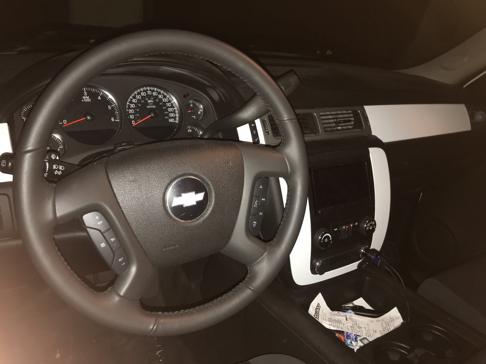

I have a Kenwood Double-Din (nothing too fancy). Used the Maestro RR along with the GM 5+ adapter. Checkout idatalink (who is the maker of Maestro). I love the Maestro as you program it with a computer on how you want the steering wheel controls to work and gives me my trucks OBDII data in my head unit. Make sure you get a head unit that supports Maestro... Everything else is kind of garbage if it’s not Maestro (PAC isn’t too bad). Also bought a new steering wheel to give me the volume controls. I could have just bought the controls and wired in, but the steering wheel was awful.
Also have a backup camera that I purchased from Crutchfield that looks exactly like the factory backup camera.

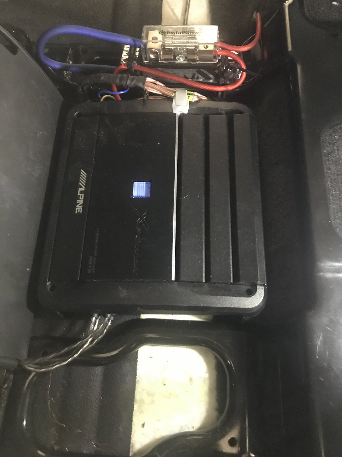

I have replaced all the door speakers with Alpine including the tweeters in the A-Pilers with Apline R-Type.
Ran all new wires and added a Alipne 4-channel amp along with Alpine mono block amp for the sub.

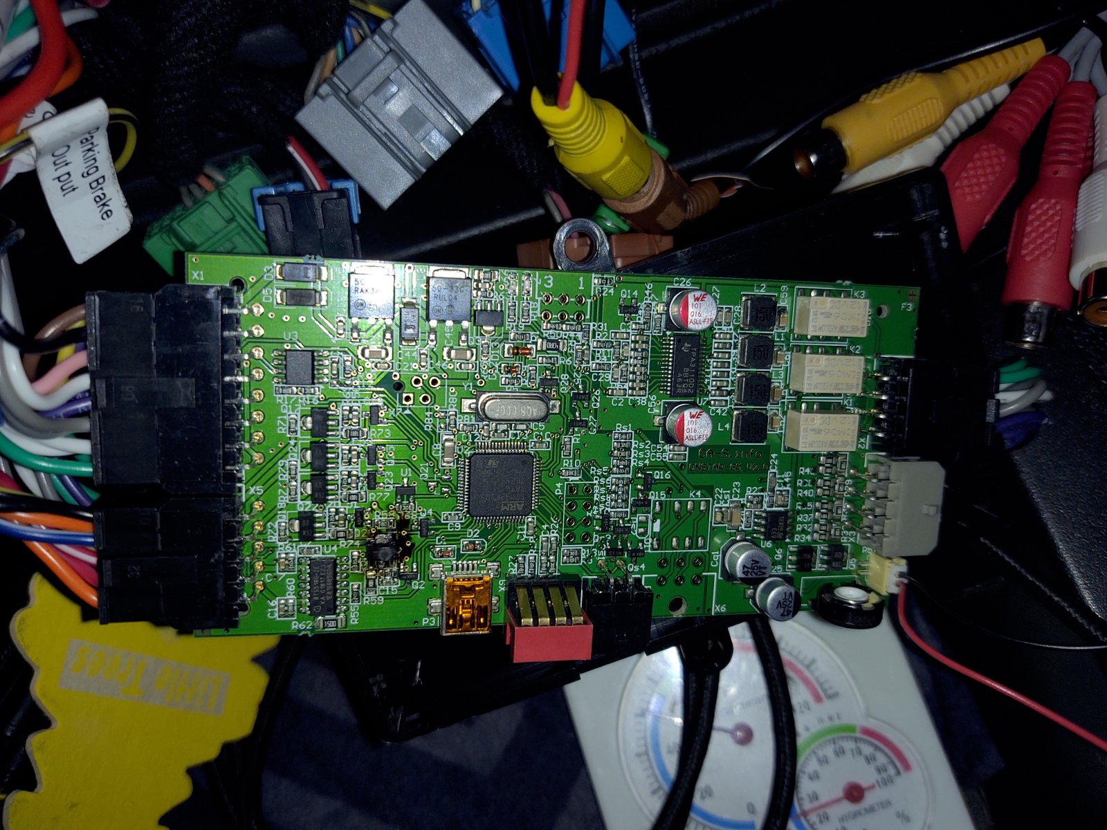

Well, after about a year and a half, something fried(smelled for a few weeks). Back up camera doesn't want to work anymore and now air bag light is on(lost connection with radio).

Finally got around to looking into the issue.
Happy that I diagnosed it properly before even looking into anything. Haha
So the "cheap" Amazon box I bought is what fried.

Backup camera only wasn't working because of the controller box.

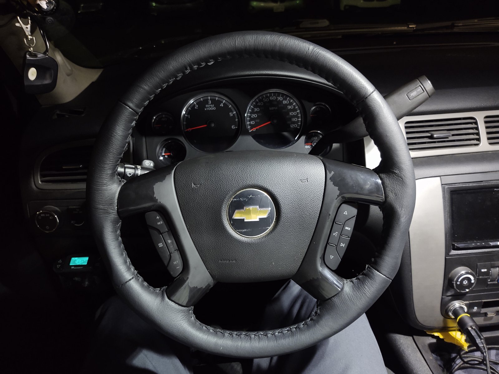

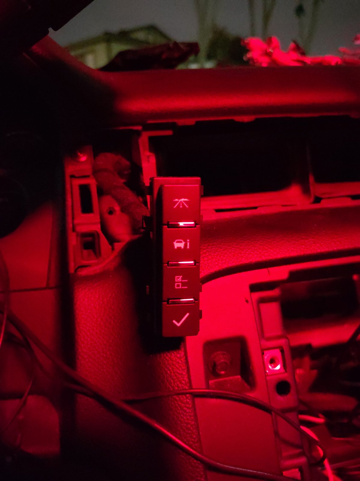

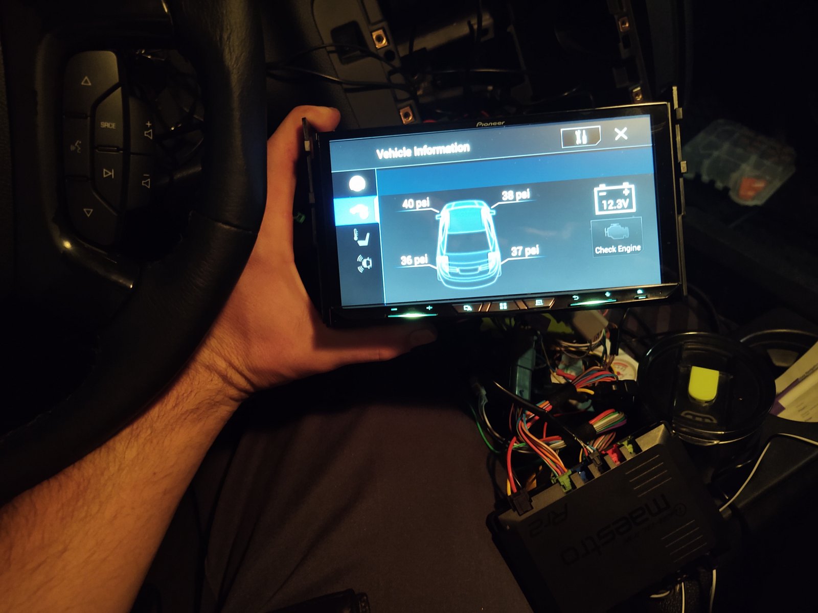

Threw on the new leather Grant steering wheel, added the radio control buttons, hooked up the maestro rr2, and added dic buttons.
Can't believe I didn't do this right after I bought it. I wish I knew how easy it would have been. This is all the stuff I've wanted from the vehicle since I got it.
