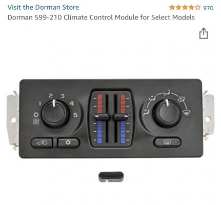

This is the one I installed and the instructions are to disconnect the battery. Install and reconnect battery. start the vehicle for 40 sec. Shut the vehicle off and depress both the cold a/c and recirculation button together for 18 seconds and release. Buttons will flash 4 times then restart vehicle for additional 40 seconds the complete the programming.
