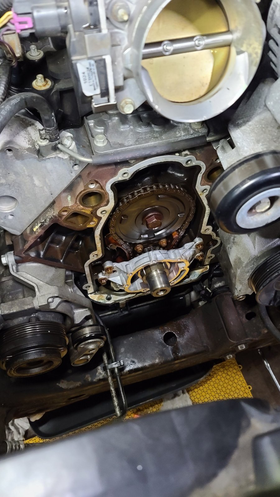

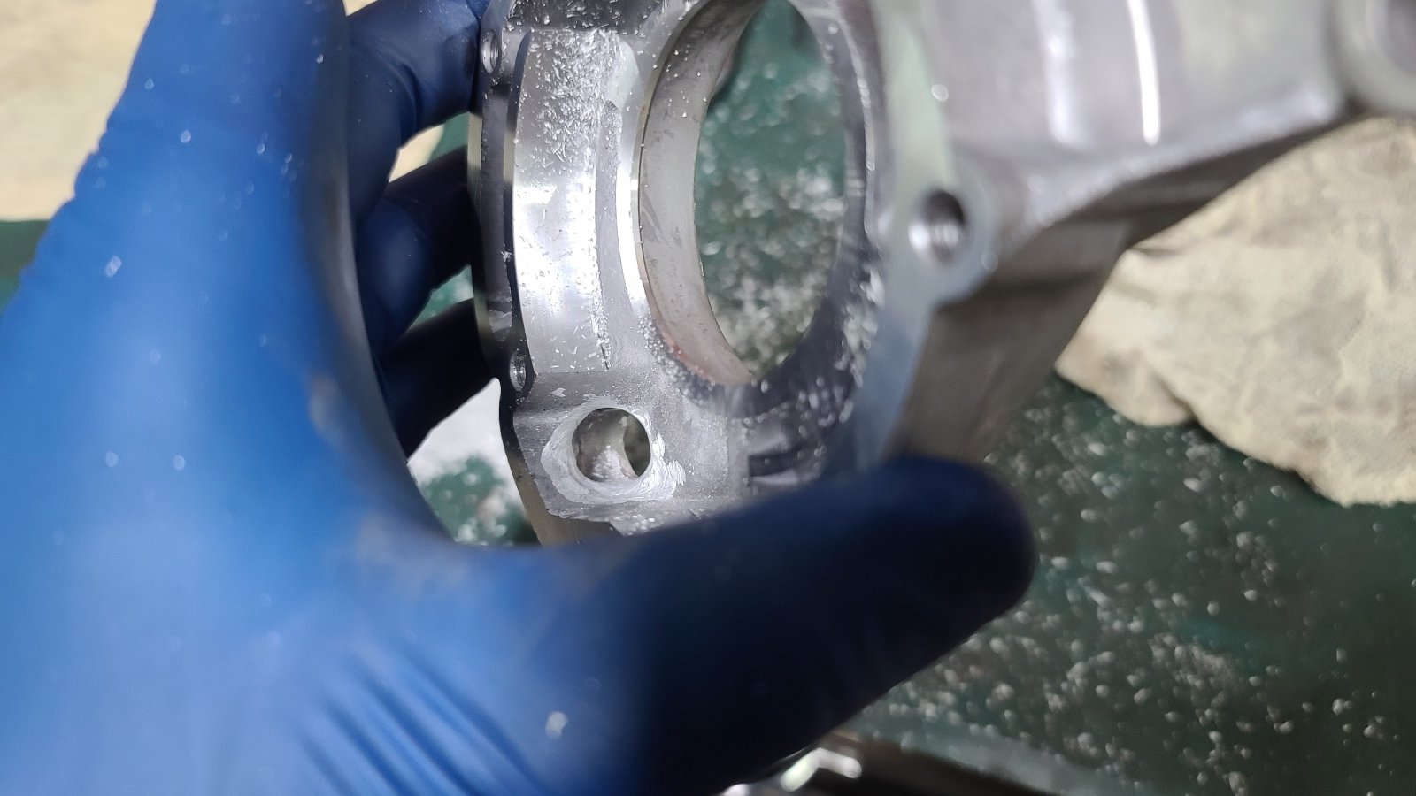

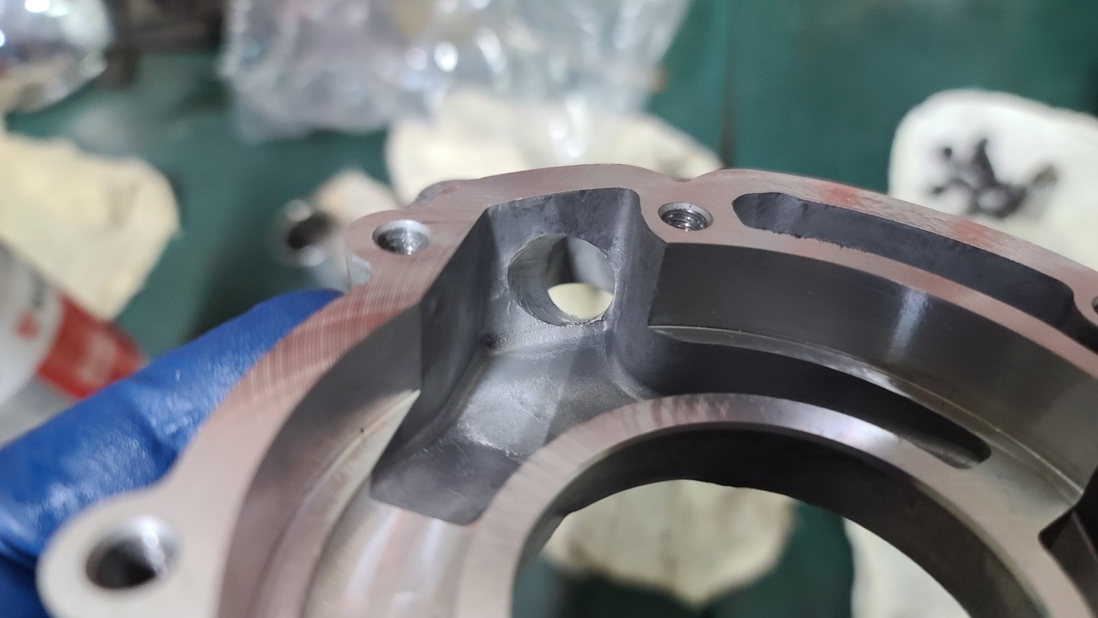

Got around to working on this project again. Installed the new pump. Rotor is larger in diameter and thicker too. The housing outlet passages were smoothed out and I filled the gears up with assembly lube before putting the front cover on right before starting it up so I wouldn't have to prime it the hard way through the side of the block.
Got it installed and put back together just to have the oil pressure immediately go up to 50psi cold instead of 40. The oil pressure after driving around and warming it up hasn't gone below 40psi since the new pump.

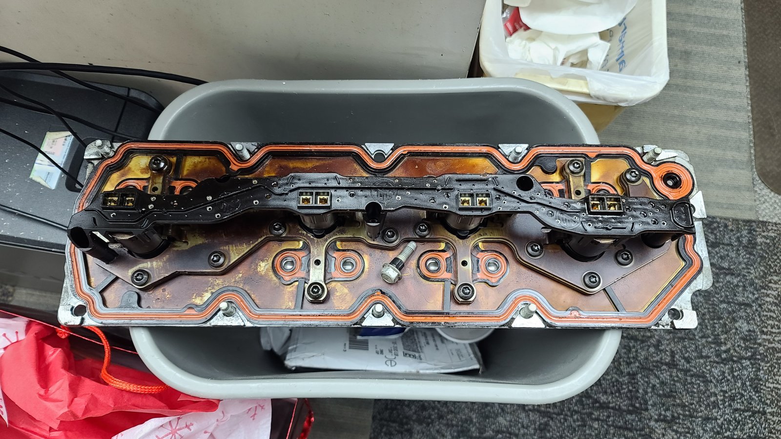

I got a used VLOM from someone locally. He said it was working but his cylinder 4 lifter died. Replaced his lifter before driving down to SC from New Jersey and number 4 died again. Got his money back from the parts store and threw in some BTR replacement parts to delete the AFM.
I'm going to disassemble his VLOM because it's a bolt together unit and replace the gasket while inspecting the screens and everything. It does look right now that the gasket is separating from the plastic so maybe that was causing a leak big enough to make the lifter stick?

You are lucky you have bolts, mine was held together by rivets. I had to buy the whole assembly new. Were the bolts loose when you took it off the motor? Mine were ridiculous lose and it was blowing oil past the gaskets. Ran like a new truck when I put the new piece on. I also had a hell of a time finding the right gasket kit that matched so be aware. I went through a lot of money because these are mostly non-returnable items. Very frustrating.
Also just a heads up, after reassembly and startup mine acted like complete ******* and was throwing all kinds and warning lights and missing and shit. I figured I ****** something up in the install like an intake gasket or crossed plug wire or something. Spent hours trying to troubleshoot it and rechecking everything. I got pissed off and I revved the shit out of it and all of a sudden it just started running perfect. Only thing I can think of was maybe the oil pressure took a while to purge the air out of the VLOM????? No idea. That was over the summer and it still runs fine now. Also got a power increase. The old VLOM and leaking gaskets were putting a hurting on her even running with the Range AFM Delete device.
