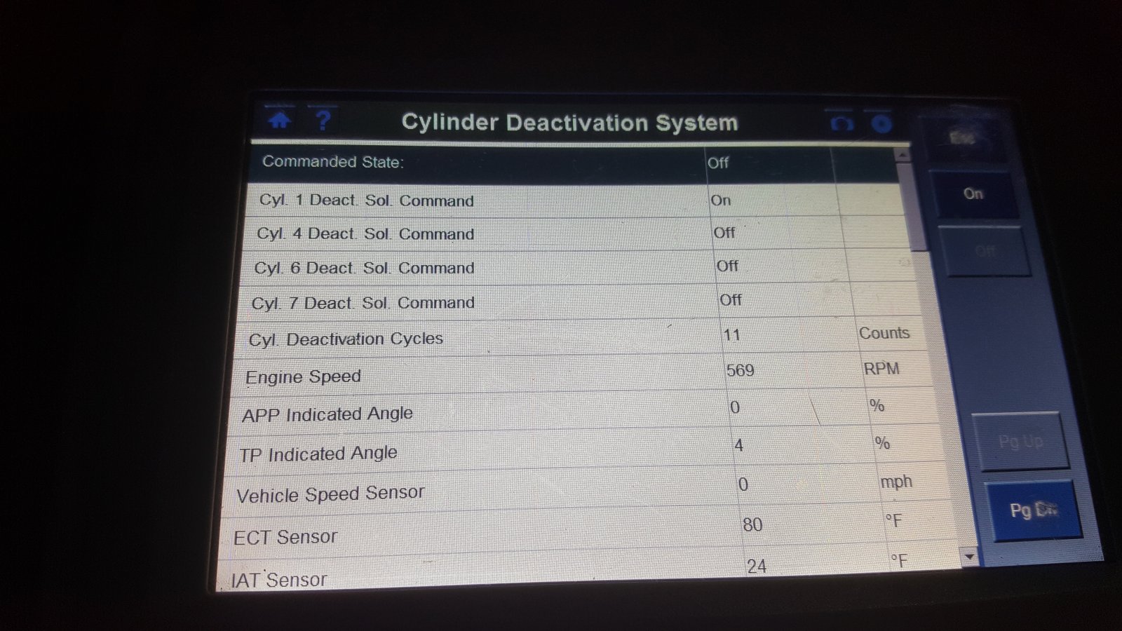

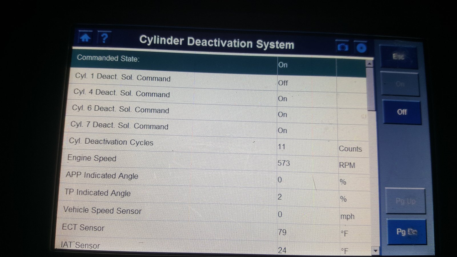

ANYWAYS... I was looking around with my Autel and looked around in the AFM area. It showed that the cylinder #1 solenoid was activated even though the computer showed the system is deactived. I manually activated the solenoid and at that point it showed that it turned off (it's doing the opposite of what it's being commanded to do). No idea what's going on with this thing. I repeated the process with the other solenoids via the scanner and they're all working fine and there was a noticeable difference in the engine running when they were activated.
Any ideas? I'm assuming a lifter has gone bad but that doesn't explain the solenoid issue. Any ideas?
says for P0315 crankshaft position system variation Not learned .. the sensor might be dead/bad. P0300 is a random misfire

Found my issue with cylinder 7. The front rocker isn't rocking. I started it up just to see what it looked like. There is some pressure pushing up on the pushrod when the engine is running but not enough to move the rocker. After shutting off the engine, it took about 15 seconds before the pushrod fell back down out of the rocker pocket.
Aside from deleting the whole AFM system like most people do. Would you recommend replacing just the bad lifter and see what happens or swap the whole bank of lifters while it is apart? And at that point would it be worth replacing just the AFM lifters or all i on the one bank?

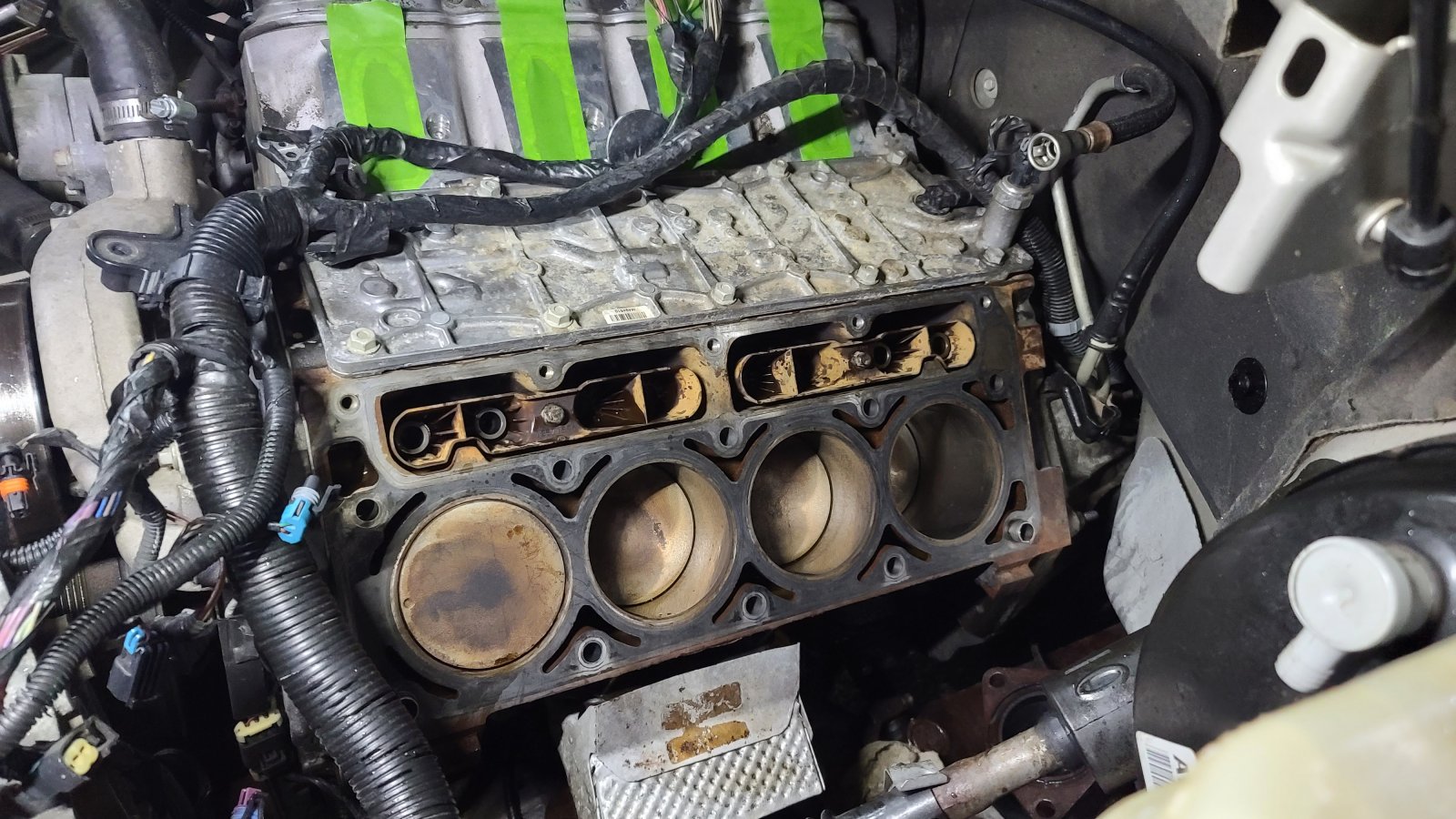

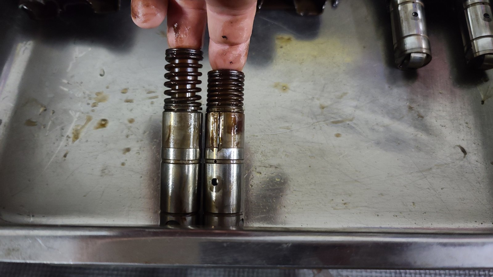

Decided to take the head off and throw a set of AFM lifters from ebay into it and see what happens. I'll take out the oil pressure sender and check the screen while I'm there. If everything works out fine after that then I'll be happy. Otherwise, the intake and VLOM are easier to take back off and do afterwards compared to taking off a head. Should have all the parts here by next week.
Peter Tremonti
Dec 18, 2019
42
49
South Carolina

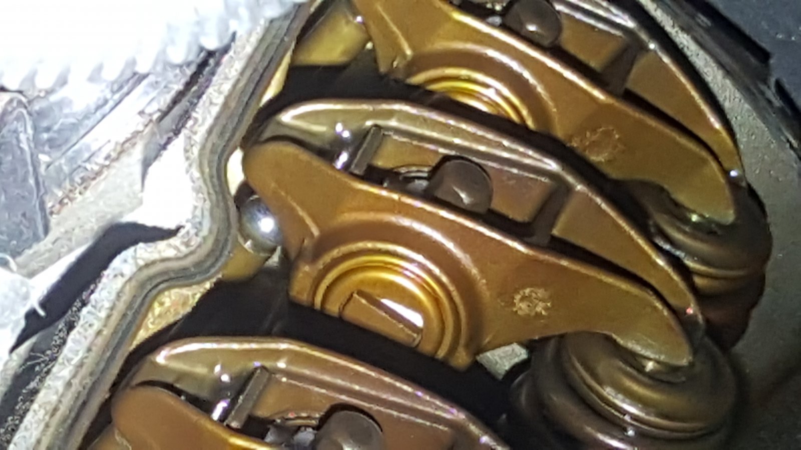

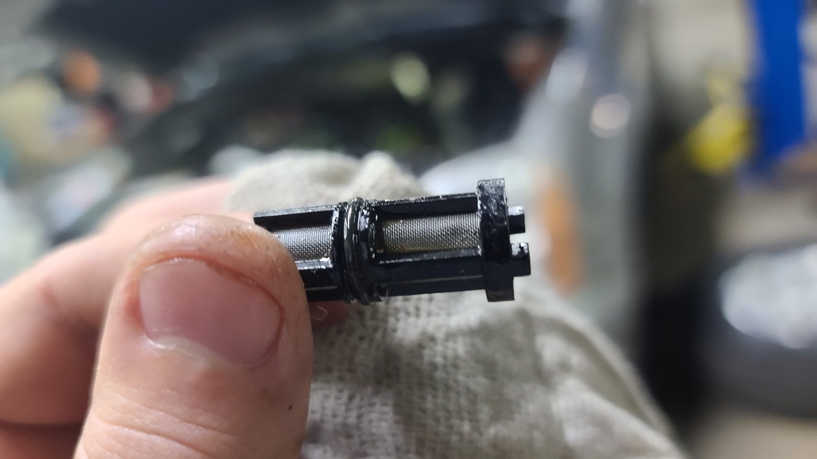

Finally got around to swapping in a new set of AFM lifters. The misfire is gone but it's clattering like crazy still. I took off a valve cover and let it run and only saw oil flowing freely out of the front and rear lifters (only 2 of the 8). The oil pressure is around 40psi at a cold start and drops slightly down to around 30 when it warms up. It does stay at or over 40 while driving 30mph depending on load.

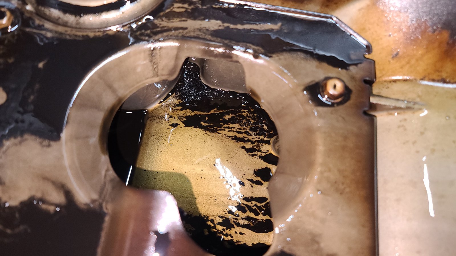

I've already taken off the pan and replaced the pickup tube. The pan had the least amount of sludge I've seen in one of these engines so far at maybe 1/4" in the corners only. I seem to be finding differing opinions about which oil pump goes into an AFM motor. Advance auto says it takes a melling M295 or M296. Melling's website said a 10355 would be needed for an AFM engine and the original oil pump is already a high volume pump based on the additional flow required by the AFM parts.
I have not bypassed or plugged the relief valve in the oil pan even though I had it off to do the o-ring on the pickup tube. I am wondering if it would be worth it to port and shim the oil pump and see what happens before swapping in a new one. I haven't seen any videos of before and after porting or shimming a pump on an LS. I've only seen videos of how it SHOULD help after doing so but no direct comparisons of before and after.
It is going into V4 mode with no issues at the moment and it doesn't seem to drop oil pressure like I've read it could when that happens. There are no more misfires at this time just ticking and lower than I'd like oil flow from the lifters.
Thoughts?

I’m just starting to get the tick as well, did you replace all the lifters or just the AFM ones?
I only did the AFM lifters on the odd bank. It fixed the misfire but not the ticking.

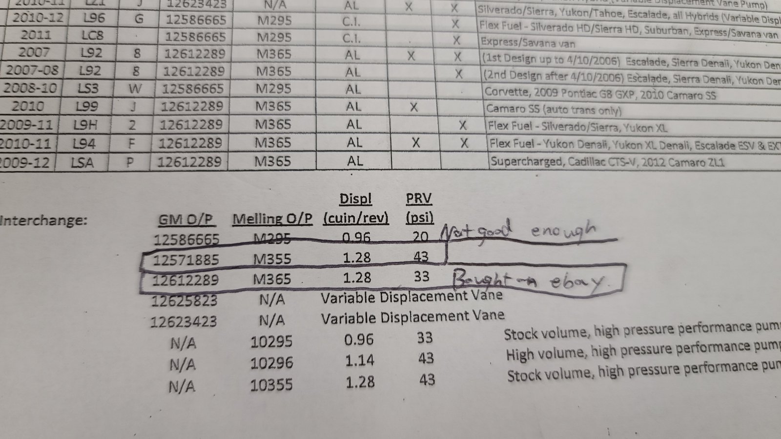

I have since bought an OE higher flow oil pump and cleaned up the casting while I was waiting for an opportunity to install it. Hopefully I'll get it installed before the end of the year.
Something I've found out according to Melling and Advance Auto Parts is that my engine takes an M295 pump. Everything I've read elsewhere says that the AFM and VVT gen 4 engines use a higher volume pump so that's what I bought.
