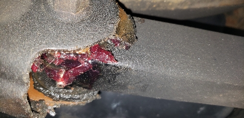

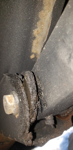

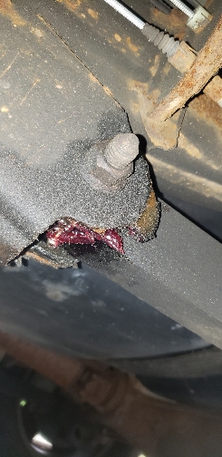

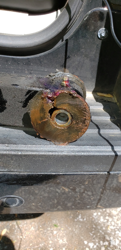

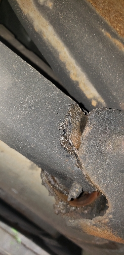

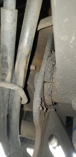

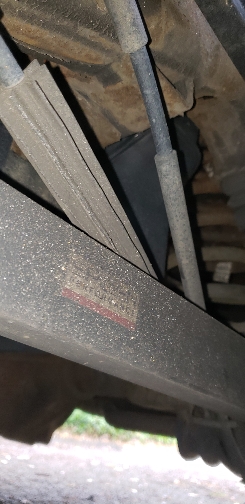

Here's the broken poly bushings on the Spohn boxed rear non adjustable control arms. Still waiting on the new bushings to arrive to do my grease channel test. I didn't bother checking the panhard bar bushings because I had seen enough carnage and disappointment in one day for these less than two years old bushings

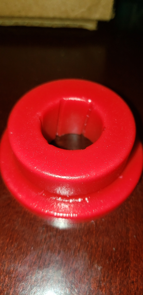

Well, the grease channel experiment for the Spohn bushings is basically a no go as they already come with grease channels. Not sure if the original bushings have these same channels but I'll post pics after I do the swap. I've attached a pic of the new bushings for reference

Hopefully those last longer than original bushings did

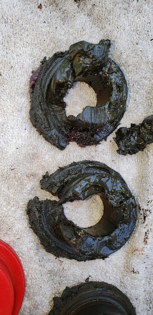

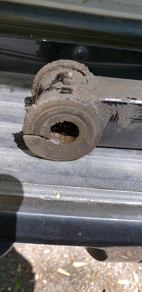

These bushings were absolutely trashed and they've only been on my truck for about a year and a half. I'm not blaming Spohn at this point currently, but if these new bushings let go then I'm going to have a serious problem with them. Pics for reference. The carnage is impressive
